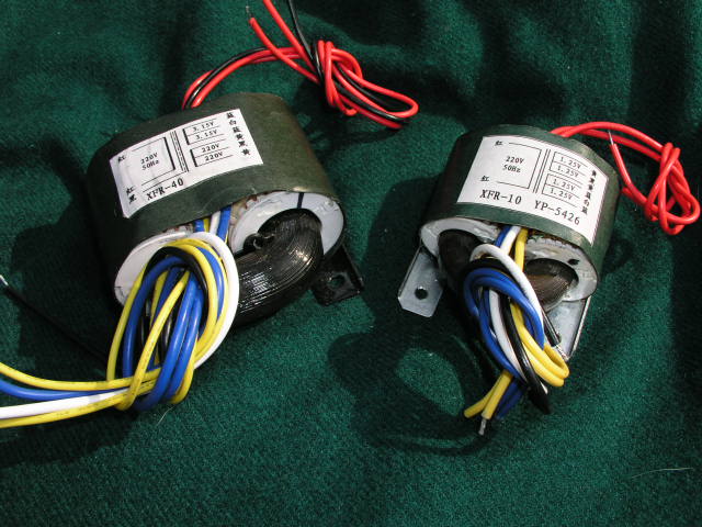

Tda1541a non-o/s DAC PCB
HI BZO,
when I design my PCB & test the power transformer for the tube I/V stage & Digital stage.
I test several different power transformers.
All were high quality.
I test in same watt of EI, c-core, circle core & R-core.
At last I choose of R-core because compare the sound quality.
The R-core was the sec. best. C-core is the best but expensive.
EI had the best punch/bass quality of all transformers.
the photos show was the r-core I choose for my parallel TDA1541A PCB use. Every kit will use two R-core power transformers.
I prepare to sell to all diyers for USD 100 per pair include postage post worldwide.
Every power transformer is 25 watt power.
thanks
thomas
