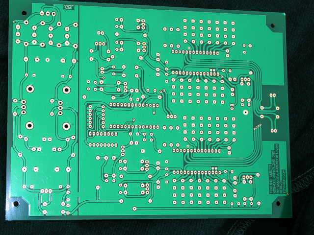

Tda1541a non-o/s DAC PCB
hi,
I know that the de couple cap of the tda1541a large will use 1uf.
due to many diyer had different taste, so I design my TDA1541a PCB was fit for different size cap. The large was wima.
pls see the lay-out of my PCB. the 4 pin holes beside the TDA1541a was fit for different size & different value of the de-couple caps.
otherwise, more grounding area will better.
thanks

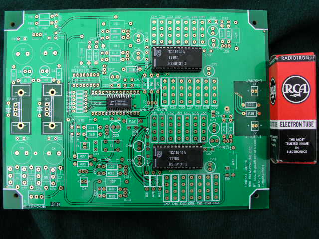

Mmm, now that I read the latest posts I understand some of the wishes. Normally I would use Wima MKP10 0.1 uF 160V so I won't be able to use them. But in case of a nice layout that will be worse when edited I would advise you to make this PCB an as-is offer. The caps are not that expensive and/or hard to get. BTW the best caps are big, aren't they ? 😉
Do not edit the board in this stage to cater for anyones wishes. It will slow down things and chances are that it will be an neverending story leaving Pedja with a bad feeling. Everybody has different wishes and if you want to incorporate all those wishes the board will never be finished. It is impossible to keep everybody satisfied and you need the time for testing/measuring/debugging the DAC which seems more important. It is a bad experience to ship something and later discover it has flaws.
If people want a board they should accept what you offer at the moment or design a PCB themselves ( or hardwire ). Maybe next time it is wise to show the design in an earlier stage leaving room for suggestions.
edit: I just checked and 0.1 uF 160V MKP10 fits on the PCB, just as 0.1 uF 250V MKT and even 0.1 uF 630V MKT provided that 15 mm is the correct format. It seems bigger at the picture. 15 mm spacing is pretty standard in MKP, in many cases it'll be only MKT that is smaller ( till 5 mm spacing ).
hi paul,
I did not know this message U was talking to me or not.
But really, I design this PCB only like to design a good PCB to diyer.
the photos show was the back screen. U can see the de-couple cap was also shield by the grounding to lower the noise.
thisPCB is test print I added more functions which compare with the standard specification that at first posted on this forum.
1. include I2S input which was very close the CS8414 to prevent the data error during passing the message.
SYN-SCK-SDATA.
Reclocking input also reserve for my coming reclocking parts.
I was waiting for my japan friend posting lower than 30PPM crystal to me to build the reclocking parts.
Diyer can make choice use or not.

Hi Thomas, I was adressing to Pedja of course as this is "his" thread discussing his design. Please discuss your board in your thread as crossing the subjects will work confusing.

The part with decoup caps was practically left as it was in the previous board. As far as I remember, when I was thinking about the caps for this place, I was looking for as thin as possible piece (I guess it is not hard to understand why) and these 0.1uF/250V appeared as best (I did not use them because I had them at hand…- I have ordered them! 😉).
For C105-C110 and C113-C118 lead spacing is 15mm, available width is 5mm, available length is 18mm (in fact there is some more mm of length, C119 could be mounted beneath the board to make a space for C113/C114). The dimensions are the same for C111/C112 (MSB) with that exception the available width is 6mm thus they fit for WIMA MKS4 2.2u/63V (MKP would be really big in this case).
At one point it was easy to put the additional pads here, ground is just beneath and it could be done literally in one minute, but once you fill top layer with ground plane the things become a bit (b)locked. Now the adding of these pads will turn me back to the point from which is not bad to think about making another prototype (and I am not a factory). I will probably do what Jan-Paul has said and take this into account in the possible next rev.
http://www.buerklin.com/gruppene/KapD/D103240.asp?l=e
http://www.wima.com/wimaforhcr.pdf
Mouser confirms WIMA’s data:
http://www.mouser.com/catalog/617/451.pdf
What are the real dimensions? Or are there two same capacitance/voltage pieces of the different dimension? It is specified sometimes in WIMA’s datasheets, not in this case though.
Pedja
What is interesting about MKP10 0.1u/160V is the fact Buerklin gives the same dimension for these like for 0.1u/250V while WIMA datasheet claims something else.jean-paul said:I just checked and 0.1 uF 160V MKP10 fits on the PCB, just as 0.1 uF 250V MKT and even 0.1 uF 630V MKT provided that 15 mm is the correct format. It seems bigger at the picture. 15 mm spacing is pretty standard in MKP, in many cases it'll be only MKT that is smaller ( till 5 mm spacing ).

I guess it is not a problem to use values somewhat higher than 0.1u at all the pins but I do not know if thus something will be gained or not.bzo said:By the way, is the value for these decoupling caps critical?
Do not expect the board to be available before the end of April.JonPike said:So, when is this board going to be available?
Pedja
Pedja said:Now the adding of these pads will turn me back to the point from which is not bad to think about making another prototype (and I am not a factory). I will probably do what Jan-Paul has said and take this into account in the possible next rev.
Leave it as it is then. If one is desparate to use different caps, they can always drill additional holes and scrape the paint to make new pads.😉

bzo said:
The mouser catalog lists these as 10mm leads, which if correct, won't fit on the current board.
It is quite possible as the 160V caps will have less spacing than ones rated at 250V.
One solution would be to include the 0.1/250 Wimas with the board.😉
DIY the hole you need!? Don't forget to remove there the ground plane from the top layer too. 😉Peter Daniel said:Leave it as it is then. If one is desparate to use different caps, they can always drill additional holes and scrape the paint to make new pads.😉
