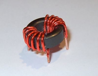

Reclocker Transformer
Gary (and all),
Given the sensitivity of Elso's reclocking circuit on Pedja's DAC to the transformer (i.e. reversing the primary and secondary polarities makes a noticeable difference), I was wondering if someone could suggest a suitable transformer make/model for this application? Has anyone tried one that performs better than another?
Thanks,
Bryan
Gary (and all),
Thanks,
Bryan
