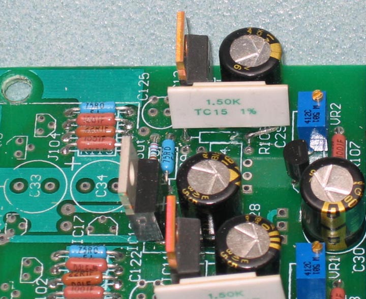

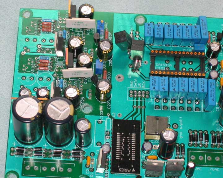

I've made some progress putting my boards together. In fact they should be ready to listen to as soon as one more transformer arrives from digikey. Here's what I've been doing / using for parts so far.
I am using the SCC944-05 input transformer. I lifted the primary ground connection on the transformer and only capacitively couple it to ground. On the secondary side, I use 2 center tapped 150 ohm resistors with the center tap tied to ground. Each 150 ohm resistor is bypassed with 22pf capacitors. I've used this technique in the past with good results.
I'm using a CS8414 and SOIC to DIP adapter instead of a CS8412 since I couldn't find any cS8412 chips. For the Filter components, I use SMD components right at the chip pins. I've also added extra SMD decoupling caps right at the power supply pins.
For the decoupling caps for the TDA1541, I'm using the epcos caps from Digikey. The 250v ones are a bit wide and need to have pins slightly bent to fit properly. It looks as if the lower voltage ones would have been better.
And for the I-V resistor, I'm using the Caddocks mentioned earlier. I'll include a few pictures.
---Gary
While I'm using 110ohms only, I found that Caddack MK132 works pretty well here. The signature of resistors is pretty much detectable in this location as well.
I don't know what type of input transformer Thomas is using, but I actually found it sounding better than Scientific Conversion one.

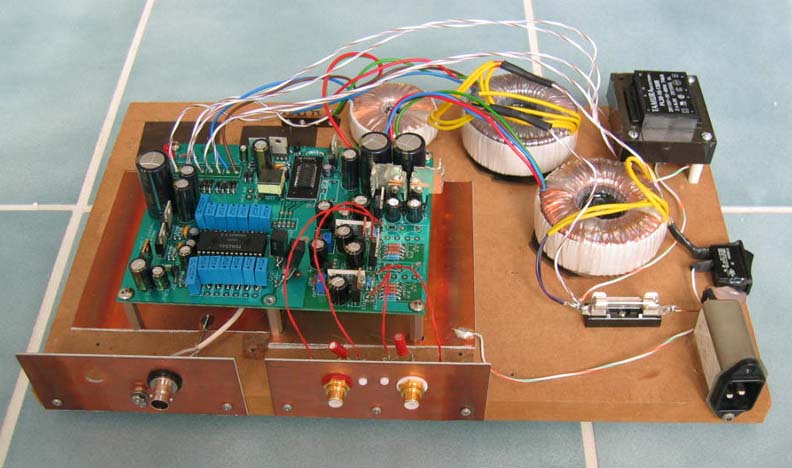

Its alive!

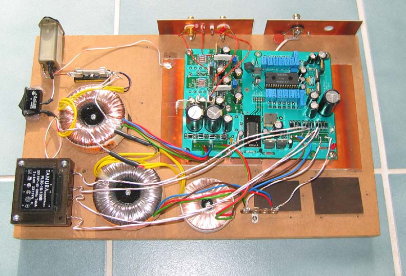

I'm happy to report that after a bit of soldering and lots of drilling and screwing onto my breadboard, I've got a working DAC. Amazingly enough for me, it worked first time out of the shoot.
Its still not very presentable but in this form its very handy for tweaking so I'll leave it this way while it burns in and I get a handle on the sound.
Thanks again to Pedja for sharing this project.
---Gary
Nice work Gary!
Not sure about that mains filter though😉 I've tried them before and didn't like the results.
Anyway keep us up to date, all I need is the 14 x decoupling caps and a transformer and then mines finished.
BTW Pedja if your reading, would it be worthwhile trying 0.1uf or 0.47uf BG NX-HI Q for the 12 LSB decoupling caps? I just wondered
Worthwhile trying - no doubt, Leo. Bostjan Kragl (I hope he doesn’t mind that I’m forwarding this info) compared them at this place against WIMA FKP1 (which are superior to MKP10 in some performances that may be important here) and found them to be better. Two issues that may spoil the fun is their price and the fact this board can’t achieve what with them may be achieved in the term of the layout, namely the loops may be a few times shorter.
Pedja

Well its easy enough to try without it. I'll solder in a standard IEC connector and see how it sounds. What's everyone else experience here? I thought the filter would be good for keeping digital noise from the DAC away from other componenets. Any thoughts on why the filter hurts the sound?
By the way, its already sounding very nice but I suspect that the Black Gates will need at least a week to really burn in. I also need to swap the TDA1541 out for a TD1541A S1 crown that I have. I wanted to make sure it worked before putting in the "good" chip. I originally rebuiilt an old Magnavox 472 back around 1990 and bought a crown chip at that time from Euphonic Audio based on some ads in Audio Amateur. The Magnavox had long ago been relegated to the junk pile so this was a good chance to salvage those old chips.
---Gary
