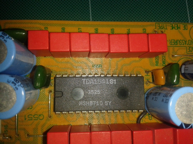

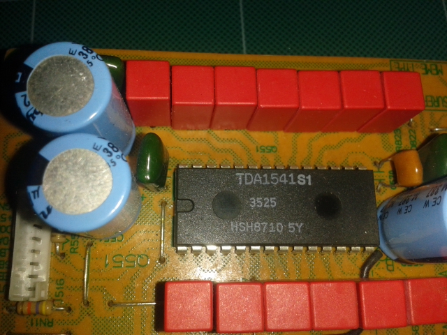

I am trying to sell a Marantz cd board which has a TDA1541 S chip.
The buyer is now saying that the chip is a fake, which it is not as I have 2 boards with the same type chip.
Does anyone have any idea / proof that the TDA1541 S existed?
Andy

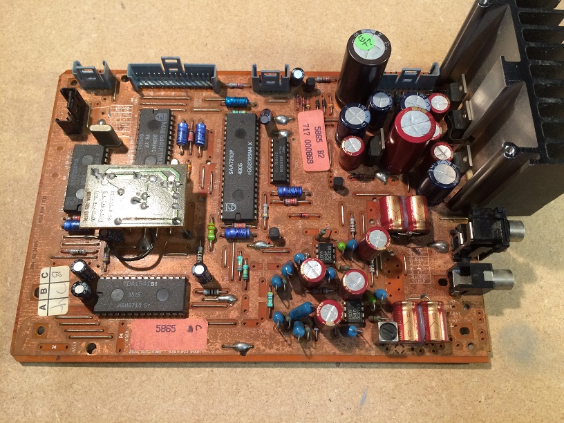

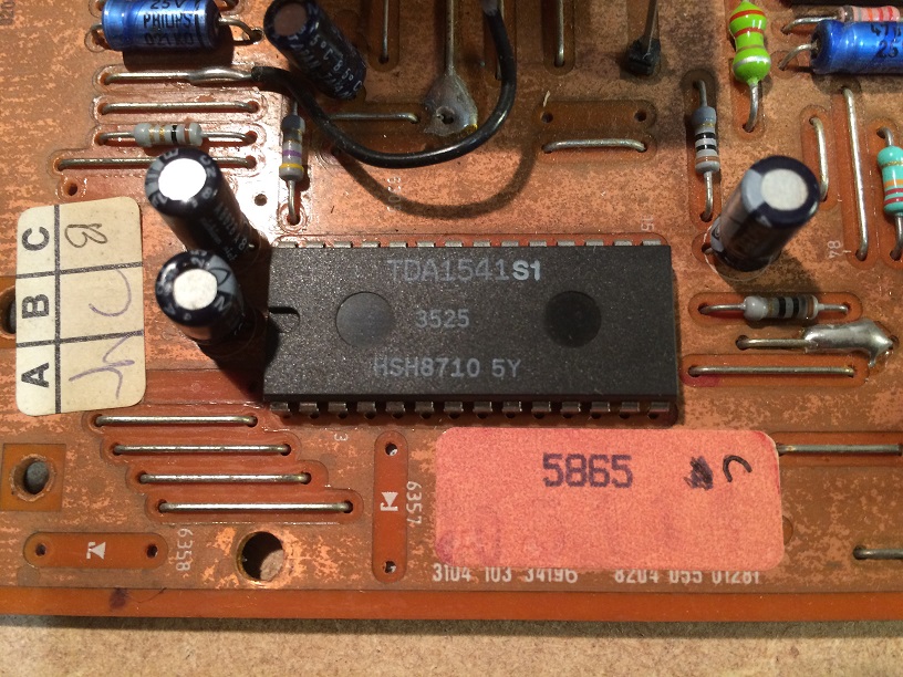

I have actually had both players for over 15 years.
Well before the trend for faking chips.
Also if they were fake, would the faker not have made them TDA1541As as well as S1/S2 plus the crown symbols.
The Chinese site looks the same chip?
I have posted below photos of the other chip still in the cd player.
Andy
