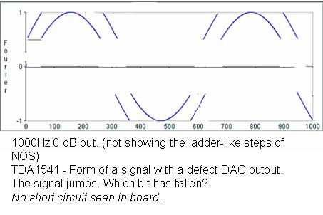

I tested the DAC out of the box with a 0 dB signal. And initially the output was OK (looking at the sine output) one channel, the other I had shorted two capacitor leads. The signal had ‘holes’ in them.
Corrected it, and for some time it was OK, but chip did get warm..
Then the signal got cut in two for the left channel: first half of the sine on the same level as the second (mean that the MSB is on both times).
I have tried for shortcircuits - none found. Strangely the second bit showed double the amount of nF (about 200) while all other capacitor leads showed the correct 100 nF. Internal short...??

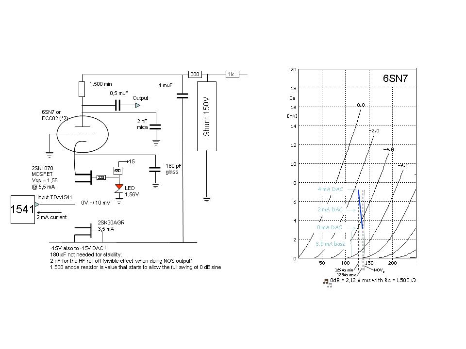

My schema:
I loaded the output with a FET – source follower configuration; a potentiometer gave the appropriate Vg of 1,7 volt in my case for the required Iout of 2mA. Initially loaded on the drain on a 1k5 (to 15V) resistor directly; later cascaded with a tube.
It gave a very nice step response.

Hi, I think the shorts at the output caused your problem. Chips in general hate shorts. This one is bipolar and antique so it should be handled with some care
BTW was it a new one or a desoldered one ?
Your measurements show enough evidence that the chip fails. True, early TDA1541 sometimes die after a period of producing a crackling noise in one channel first. This really counts especially for the first versions ( I know it with pre 1989 non A versions ) as far as I experienced the problem. I haven't experienced this with the more recent versions yet. Please realise that the new ones of course haven't had as many hours on them as the old ones. At least 15 years of reliable service seems enough, isn't it ?
Maybe you can spend another 10 Euro for a new TDA1541A and try a standard output stage to start with ???

Jean Paul, Is the output stage suspect?
I added the current waveform, fun to look at just as evidence. The LSB also tends to wobble a bit.

Extreme_Boky said:Have you checked the transients when turning your analog (valve!) stage ON and OFF?
Extreme_Boky
What I see (tube used in cascode) is that the output goes down - to min 15 V of course. The 2SK30 pulls it down to earth.
If I would have a transistor cascode this would not be the case.
I reckoned that this is a normal state as the current drain is also to the -15V rail.
I tested one setting with an opamp controlling the Vout and keeping this to zero, this would not have orked anymore in this setting with a tube.

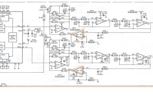

In the mean time I have found a schema, by the way, from Marantz, with a separate opamp only for the 2 mA. That will circumvent any DC going astray. This is in the DFA888 (that I bought 2ndhand last month) (see shema Philips/Maranntz)
--> Maybe an idea to combine the two topologies?
Still the 3,5 mA CCS from the 2SK30 is needed to bias the tube to a lineair area. So when working, that is OK.
When turning off, there is no transient effect I saw.
How is that 4uF decoupling cap connected to ground / what ground - power supply ground?
Make sure there is no charge / discharge current from this capacitor running through signal ground.
Marantz cct shows that keeping 0 at DAC Iout is important. So, try to keep it at 0. Once you are happy with this, try another TDA chip. I can get them for around $A20 each.
Good luck,
Extreme_Boky
Good luck,
Extreme_Boky
Extreme_Boky said:How is that 4uF decoupling cap connected to ground / what ground - power supply ground?
Good point, I actually don't have it connected to -15V but intended to. This just because that is where the signal terminates that starts high up (or the other way around, for the physicists). This would give the shortest path.
But I see the difficulty here.
The shunt regulator should stop any transient though. Apart from the warm up, that is... :-(
