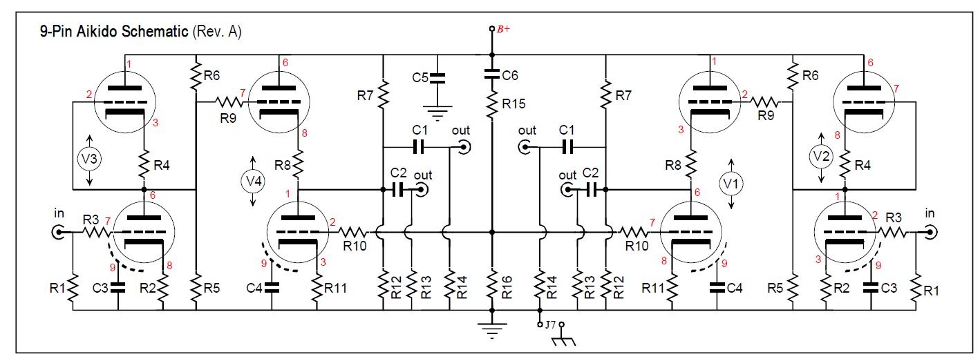

My current setup is a TDA1541 DAC in NOS mode with a passive I/V resistor of 50ohm. This feeds the grid of the Aikido preamp with 6N2P as first stage followed by 6N1P as second stage. Quite a bit of gain but I like the 6N2P sound.
Overall I'm very pleased with the sound however I do suffer of FOMO and I'd like to try a transformer coupled with a resistor. This will cost about US $400 for 2 of them which is expensive.
I'm planning to add a secondary TDA1541 in parallel. A single TDA has a 4mA p-p. Twin will be 8mA p-p. Based on sowter calculation, using the 1465 transformer and 8.2kohm on the secondary winding will generate 2V rms. This should be enough to skip the Aikido altogether.
Based on your experience, it it worth the money to go this route? Did it have an improvement on your current out DAC going from passive I/V resistor only to transformer + resistor? I'm not currently entertaining an active I/V conversion. I'd like to keep the signal path as simple as possible.

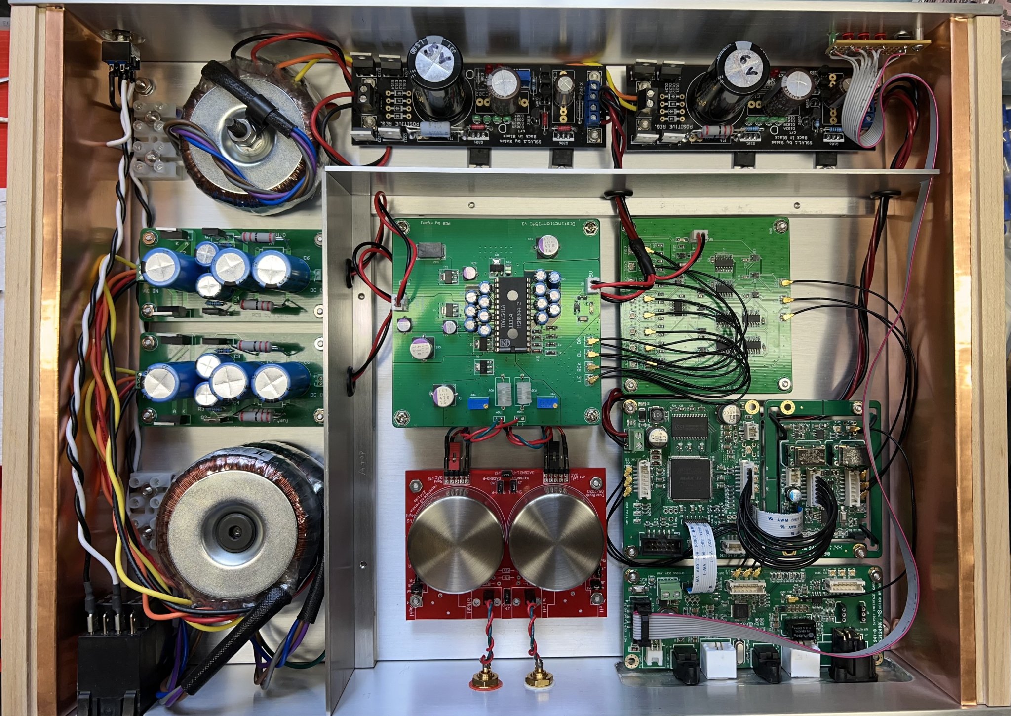

I just went through this process recently.
I have a DAC built around Ryan’s D3 boards found here:
https://www.diyaudio.com/community/threads/diy-tda1541a-pcb-d3.328060/
I got it up and running a few years ago and left it with only IV resistors on the output.
It worked because I use highly sensitive speakers and my system had just enough gain…but lacked the ability to handle certain types of music with the desired impact.
I found a pair of barely used IV transformers made by bisesik in the swap meet as part of a bundle sale.
They sat around for a while until I recently got frustrated enough to open the DAC back up and looked for the help I needed to install them properly.
I couldn’t have done it without bisesik’s help…he was great.
The end result is phenomenal. I am very happy.
For reference, I am running two of Ryan’s D3 boards with Taiwan made TDA1541A.
They were originally run parallel for the higher current swing into mk132 IV resistors alone.
When I installed the transformers, I changed the IV resistors out to some hand wound Constantan resistors I made.
I also changed the signal delivery over to differential arrangement.
I’m using some of Ian Canada’s original boards for SPDIF input and the Fifo with upgraded crystals for the reclocking.
I use Ryan’s I2S to Simultaneous board to deliver the signals to the D3 boards.
Most of the info of the process is toward the end of the D3 thread and bisesik’s transformer thread

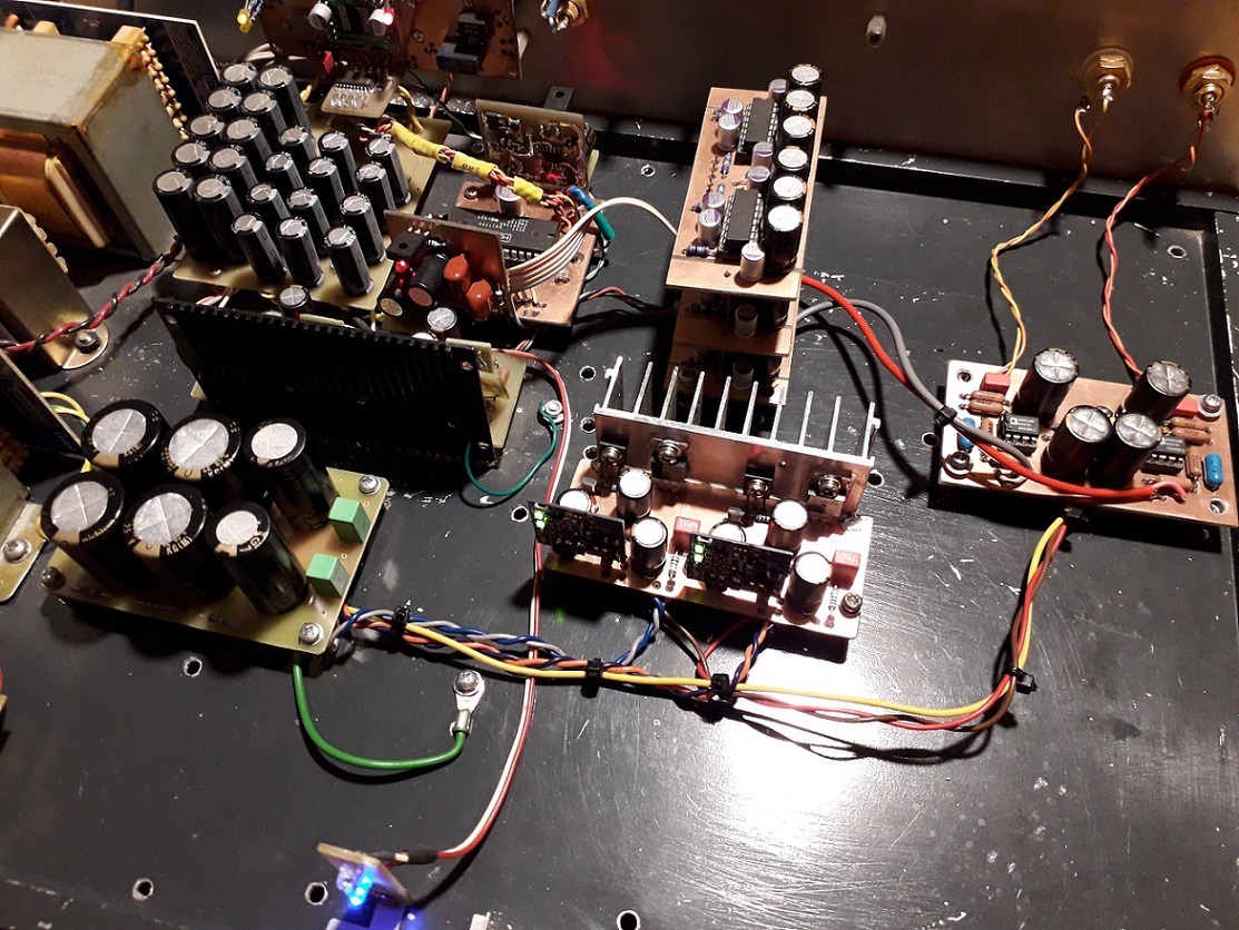

I would recommend that you first try active I/V conversion with AD811,AD844 or OPA861 or some discrete I/V stage.
You can also do a tube I/V conversion, but with a grounded grid.Tubes for this must have a higher gain and must be able to work with a very small cathode resistor.
A transformer, or in your case a passive I/V conversion with a resistor is not an ideal partner for a current DAC due to the high Zin no matter how much some claim otherwise . The ideal Zin would be 0ohm, which can only be achieved by active conversion. The sound of passive I/V is always a bit withdrawn and even blurred in some parts of the audio spectrum unlike active I/V which is more dynamic, cleaner and more precise. However, someone likes passive I/V, but does not use the current DAC to its full potential.
At DC of course the DAC sees a very low resistance.
With AC, even with the reflected secondary load, the IV resistor swamps this.
The main reason for not using an I/V resistor with the 1541 is the 2ma zero signal current offset. This should be nulled if using a single ended dac with any transformers ut not relevant to my balanced design or other bifilar wound transformers. Most 1541 critics concede that the value of the i/v resistor doesn't result in audible distortion provided it is below 100r.
As far as generalised negative comments about sound quality are concerned, they are not true in my case. I have a R2R discrete logic dac from member Chiurtu and can swap quickly from one to the other. (also have a Dacmagic and Cambridge 651 (dual WM8740 and dual CC dacs and the differences are quite subtle)
The R2R dac (opamp output) has a slightly more sharp edged treble compared to the more restrained 1541 dac but neither suffer from lack of detail nor "blurriness". In the end it's which you prefer - just don't let the naysayers put you off.
I deliberately did not mention ordinary op amps but CFA op amps which give a completely different sound with current DACs.
The difference in the price of two CFA op amps and two quality transformers is large so it is more logical to try the cheaper option first. A cheap option can sometimes surprise you with the result.

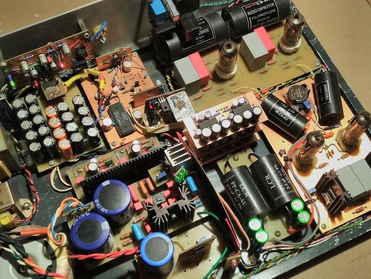

I have had the NOS TDA1541 for years and I must admit that the passive I/V with the tubes behind them really sound great. In the meantime, I made a much better I/V conversion with tubes where the signal is fed to the cathode (ground grid), which I tested on the PCM1702.
The sound of such a conversion is again completely different from the classic passive I/V with tubes and is much more dynamic and cleaner, a completely different story. It may be a more expensive option than a transformer and certainly much more complex, but the result justifies the investment.
Today, after more than 15 years of tinkering with various I/V conversions, I returned to the CFA op amp the AD811 which Walt Jung first introduced as an I/V stage back in 1992 precisely for the TDA1541. From its output I directly drive the next CFA amplifier Le Monstre. I can hardly compare that combination of I/V conversion and amplifier to anything I've heard so far.
However, everything is a matter of taste including the choice of I/V level and I only gave my opinion.
For comparison, one image shows the tube I/V stage (ground grid with 6HM5) and the other AD811 I/V in the same DAC.
