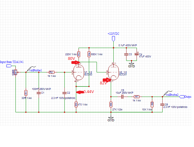

Thanks for your answer, in any case what are the correct voltage values that would be better to obtain in the points measured by me?Apparently your ECC83 is a bit weaker than the curves in the Philips datasheet http://www.r-type.org/pdfs/ecc83.pdf indicate, but not dramatically so. You may have a bit of grid current due to the relatively small negative grid voltage (the grid must be somewhere around -0.06 V while the cathode is at +0.44 V, so the grid-cathode voltage is about -0.5 V). Then again, you drive it from a quite low impedance and the current is limited, so it shouldn't do any harm. I wouldn't touch it if it sounds good.
Regarding C5, is there any reason why R8 needs to be so low? You can reduce C5, but how much depends on how much loss you are willing to accept at the bottom of the audio band and on R7 + (R8 in parallel with whatever is connected to out).
And above all .... what is R4 for?
As for R8 instead I think I could easily replace it and I imagine that also, empirically if I bring it to 100k, maybe I could decrease C5 to 1uF or something like that.
One would usually use a more negative grid bias voltage, but I think it would do more harm than good in this case. Assuming that the heater supply of the ECC81 is grounded, you can't make the ECC83's anode voltage much higher than it already is. At low anode voltages, the ECC83 works in a much straighter part of the IA versus VG curve at -0.5 V than at -1 V...-1.3 V.
Maybe not the best settings and komponent value selection for the ECC83 gain stage. tipically 220K at anode load is simply tooooo much.Hello! I would like to know your opinions on this output stage that I am attaching in the photo.
The only difference is that my current psu can only supply 230Vdc and not 270Vdc.

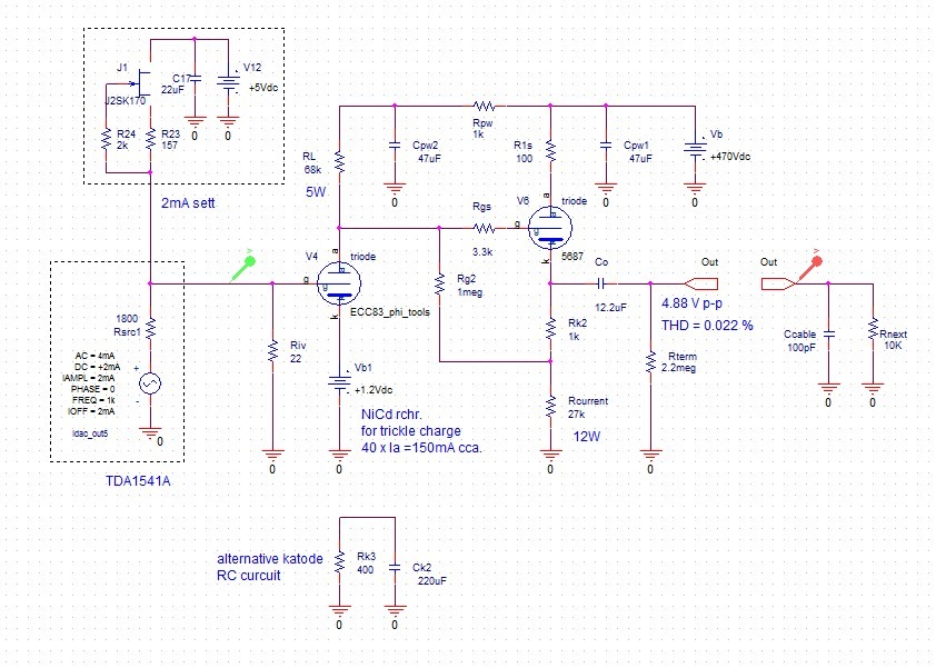

Making the load line almost flat and more important "eating" voltage for ECC83. Makinf the Anode voltage of ECC83 too low.
220K load for ecc83 is typical for guitar amlifiers and PA tube gear...
I dont see tha point of using ECC81 in the buffer stage since tha output resistance is app. 1/Transconductance. And the Transconductance of ECC81 is not high but opposite - low. In that place better suited is 5687 tube or other with higher S
I will try to sketch an example
If someone prefer less Output voltage p-p just decrease Riv value from 22 ohm to 11 for the 2.4V p-p. 5687 can run even with bit more Ia and in that case decrease Rcurrent value from 27K to 25K or 24K but not more than 12mA for 5687. There is no point to fo more with current, nothing changes but 5687 coming closer to the power limit...

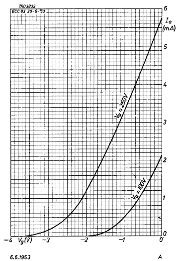

ECC83 is set like Neumann style battery biasing. 1.2/1.25V is the most linear region. with Ia=3mA and Ua=265V Pa is at 80% of max.
So the tube is operating in real tube voltage. At least tubes are voltage devices 🙂. The Load of ECC83 is 68K and it is pefectly enough for the amplification. Load line have a slope, and not tend to be parallel with X axess...
NiCd or NiMh or other smaller battery could be used but not from high mA/h. Goal is to emulate trickle charge current of about 40 x Ia and that is 120mA so the standard close value is 150mA/h
Optional alternative biasing circuit RC classic type is from very close low end of BW with very smal phase shift in low Fo
Distotion are minimum and almost without 3rd-H...
This is important: The circuit nas NO HF filtering, so that could be added

Hi Antonio If You are satisfied you dont have to move from circuit alrady in use. I just make some comments from my experience with tubes. I simply count more when the tube working in higher Ua if the linear region follow this, then with kower almost solid state value of Ua... Same is from personal tryout for huge RLoad, and reasonable load connected with tube anode charackteristis. Soud is a big difference. Regardless of brand type of the tubes.
At least chsnge value of 10K at the output. It is not final loading resistor. The one in in the next stage IS. Output C is for 10K load But if Yu have 10K in nex stage and this 10K at the output, that will be parallel value of 5K and 10uF would not be enough for good low end... Other thing is that tis 5K will heavily loading buffer that wil go into effect of compession... So by this "little" things I can tell how is the global sound... So this resistor is OK to be in place BUT 1meg or 2.2meg value, Just to terminate output not to additionally load buffer.

R$ and R5 are forming circuit for +0.4V biasing for unput tube. That is actualy negative Ug because G is in 0 potentional.Here
Taht can be done wirhout the R4 but value if the R5 coud not be tha same...
Also maybe R4 with R5 creating a shunt resistance from Power supply to ground. From my experience any shunt in tube circuits for small signal can little "damage" sound. Any even one resistors for bleeding the power caps.
But that is not the main "problem" of this circuit. Simply the Va is too much low = +79.56V.
I will repeat tube is the voltage device not the current device.
Second "problem" is too high Rload of 220K. There are no need for that kind of amplification, AND the load line is tend to be parallel with X axess.

so in concrete, what are the reference voltages that I should try to obtain so that the circuit can work at best with 220V of psu?
