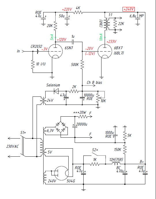

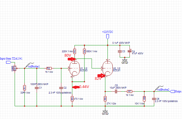

I proceeded to draw the diagram in a more decent way, in addition I also proceeded to measure some voltages (referred to GND) in some points and I also remember that the original power supply of the circuit was 270V, unfortunately my PSU can only supply 220V . Could any expert among you tell me if I have to or can I change something to make it work better?

The input trimming potmeter is connected differently now, the 22 ohm has become 33 ohm and the supply voltage has changed.
Are you sure the potmeter connection is correct? You get a higher load impedance on the DAC output than with the circuit of post #1.
Yes you have right, many thanksIn realtà sono abbastanza sicuro che la connessione potmeter del post n. 32 non sia ottimale. Il modo in cui è collegato nel post n. 1 è molto migliore.
Hello!If I calculated it properly, then reducing the 220 kohm resistor to 180 kohm and 680 kohm to 560 kohm should give you approximately the same bias point with 230 V supply as you have now with 270 V supply. The anode of the ECC83 should then end up somewhere around 80 V and its anode current around 0.85 mA.

I thought you had this circuit running on 270 V and wanted to know how to modify it for 230 V, but now 230 V has become 220 V and you apparently already have it running on that lower supply. Hence I only commented on the suboptimal potmeter connection.

Now my question is if I have to modify R3-4-5-6 because they continue to have values for a PSU of 270V, and instead I am have a PSU of only 220V.
Also I would like to know if I can decrease the value of C5 as well.

Apparently your ECC83 is a bit weaker than the curves in the Philips datasheet http://www.r-type.org/pdfs/ecc83.pdf indicate, but not dramatically so. You may have a bit of grid current due to the relatively small negative grid voltage (the grid must be somewhere around -0.06 V while the cathode is at +0.44 V, so the grid-cathode voltage is about -0.5 V). Then again, you drive it from a quite low impedance and the current is limited, so it shouldn't do any harm. I wouldn't touch it if it sounds good.
Regarding C5, is there any reason why R8 needs to be so low? You can reduce C5, but how much depends on how much loss you are willing to accept at the bottom of the audio band and on R7 + (R8 in parallel with whatever is connected to out).
