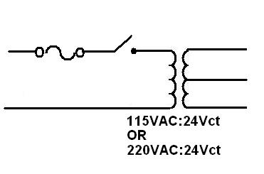

Yes, 9 volts won't cut it. You need a transformer with center tapped secondary. A 24v 2 amp (12-0-12) will work fine. The center tap lead goes to the center connector (ground) on the power input block and the outer leads each go to an outer connection (AC). I don't know what country you're from, but Radio Shack sells a transformer that will work.

This amp board needs a split supply to operate.
There is a bridge rectifier seen in the e-bay pix.
A 24Vct transformer would work.
But if you just put a power supply to it without heatsinking it will probably overheat when used.
See .jpg.
I suggest you read up about making a power supply (wall outlet powered) or seek help from someone more experienced before you start.
Be safe.

Radio shack transformer will require wiring, you need a fuse, fuse holder and cord on the side with 2 wires and the 3 wire side of the transformer will hook up to your 3 screw connector on the left.

You will need to wire the transformer to power. (through a fuse and switch)
