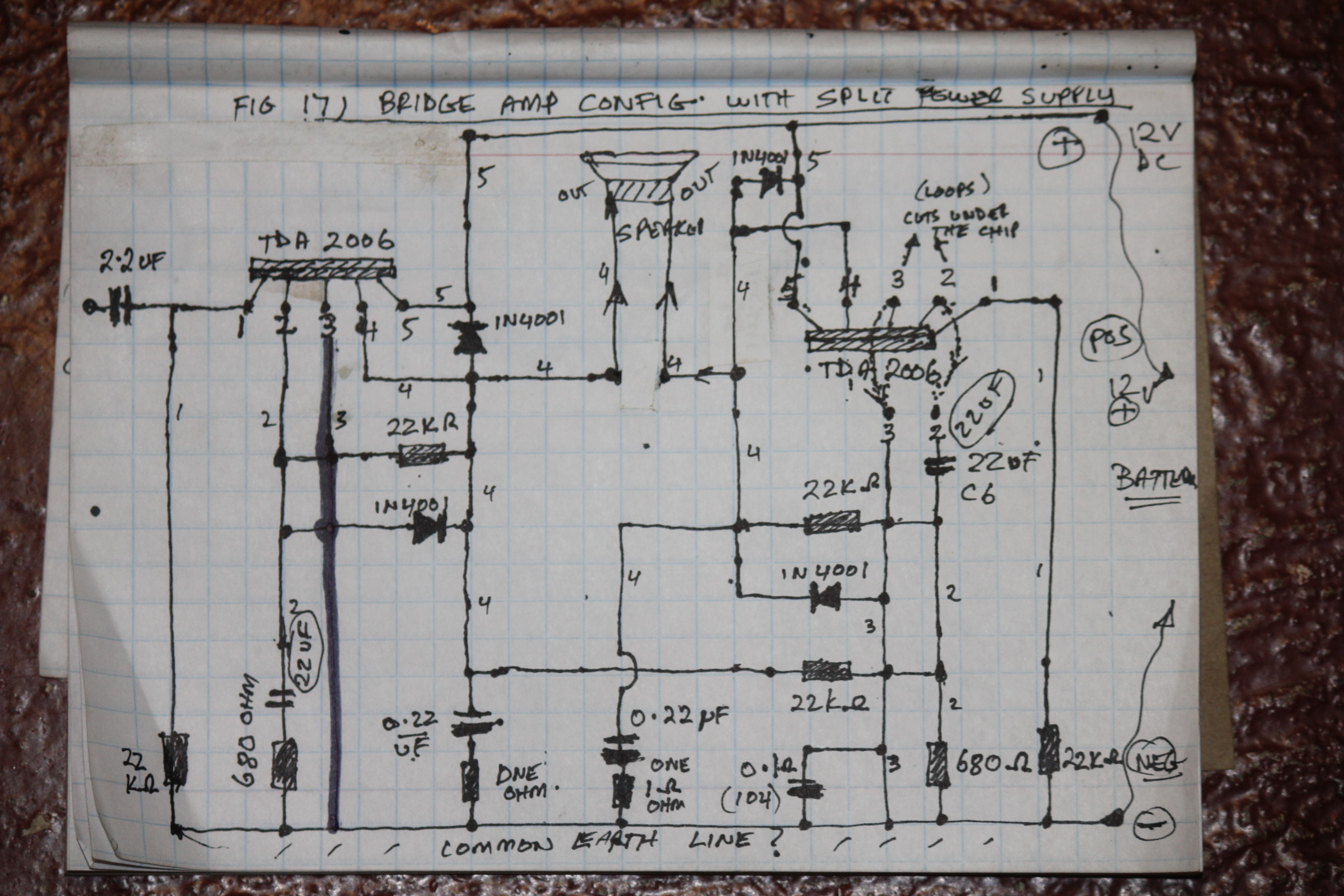

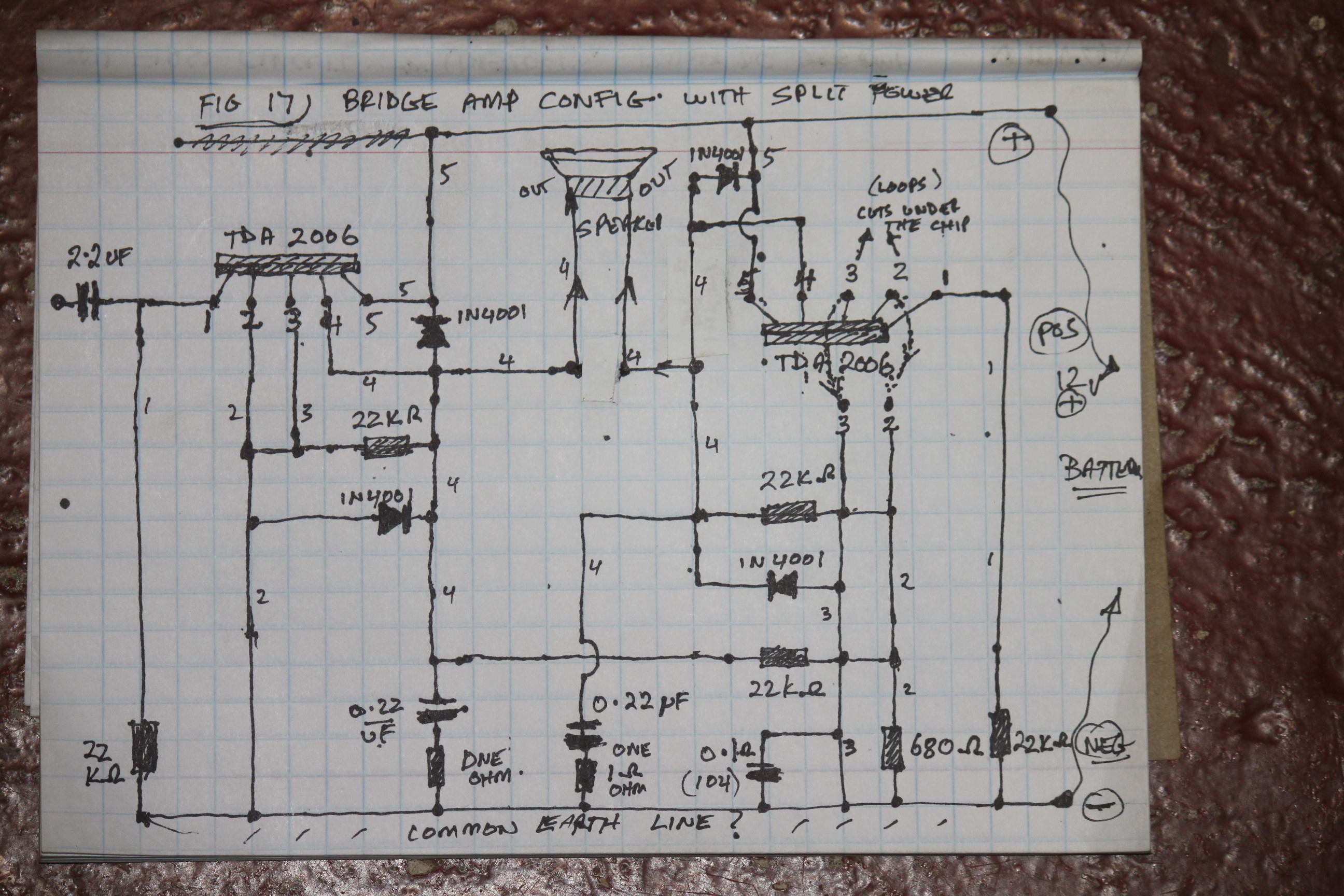

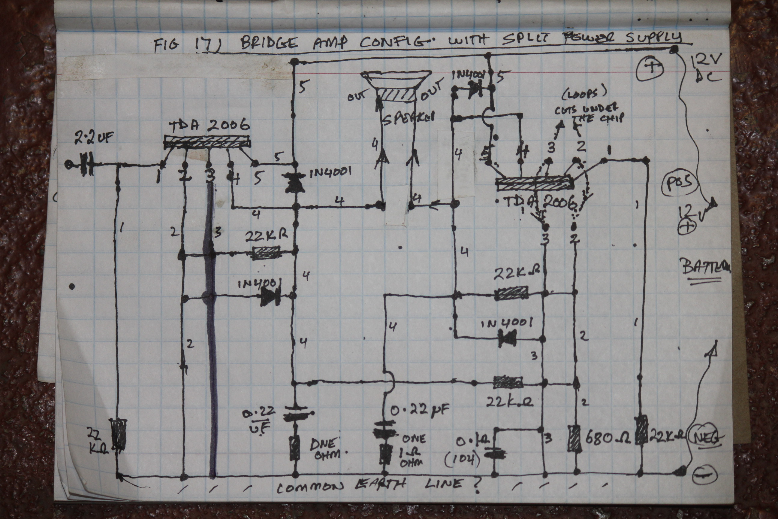

HERE IS THE15 TH ATTEMPT --FIG 17 -bridge amp conf with split power supp-drawing of
here is the 15 th attempt at constructing a home wired TDA 2006
BRIDGE AMP CONFIGURATION WITH SPLIT SUPPLY--
(TWIN TDA CHIPS )
note the 2nd TDA is reversed --makes wiring pinout a bit awkward
maybe wires too long causing oscillation --
but this fella roars like a black maned LION with pyles--
have made so many amps ---- eg--the
TDA 7294 I BUILT 5 YRS AGO ----140 WATT mono amp
worked wonderful --till I blew it on overdrive solos with a
Gibson les Paul humbucker ---- but zero distortion --until now!
so all I want is a modest 21 or 24 watt(above ) that behaves itself
many thanks for all your help --
you are a true Samaritan ---- ( I think I have attached without using IRFANVIEW --- my camera has a small reduced pixel setting --
regards -- carl

(bridge amp twin conf--corrected drawing
sorry missed drawing in the 680 ohm resistor bottom of pin 2 and its series
22 uf capacitor ---also left out the 22 uf cap--c6 in the drawing -- on the other TDA Pin 2 ---
(they are included in the circuit I constructed --just forgot to DRAW them in ------apologies ---
so I fotographed the drawing (corrected) again---
here is the original DISTORTING circuit
redrawn with all components ---
see if u can spot the GREMLIN !
will really appreciate if u can redraw another circuit for me --
this one is a nightmare --due to opposing TDA AMPS--
OBVIOUSLY something is very wrong ---please feel free to tear it to pieces ----
regards -- Carl---APOLOGIES for not drawing in those vital components

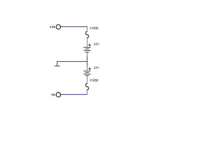

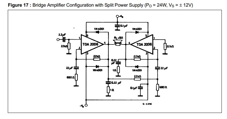

Hi Mark ---
apologies for the battle to send u a decent drawing
sorry for the ommisions --finally I got a picture uploaded--
thanks so much for your advice ---but now I am really confused--
TWO 12 VOLT BATTERIES ?---IN SERIES ?
I cannot understand how the circuit can be 24 volt when the schematic shows
12 VOL split supply ---no real twin battery connection shown --
how on earth do I connect 2 x 12 volt batteries?
can u send me a drawing or correct my twin bridge AMP -
I don't see how to connect 2 batteries --this has me perplexed?
esp whaen you say -12 Connects to pin 3 ? where do I connect o ( zero?) to ground ?----what is zero ---? ground ?? ----do u mean earth or negative poles of both batteries --?
the reason why I draw constructed the first SINGLE SUPPLY TDA 2006 circuit schematic ----is that it says SINGLE 12 VOLT BATTERY ----- ? is that wrong ?
the second ( fig 17 ) shows ( SPLIT SUPPLY bridge amp config )
what does split supply mean --? 2 x 6volt batteries ? nowhere does it indicate on any schematics that you must use 24 volts supply !
I am now so confused --how do I wire up 2 x 12 volt series batteries ---into the bridge amp config diagram -
CAN YOU SEND ME A DRAWING OF HOW TO CONNECT ---I AM TERRIFIED I MAY BURN OUT THESE SENSITIVE TDA 2006 IC ,S
many thanks --but your advice is too brief ---need far more elaboration
ie --- pin 3 to zero ?? where do I find zero point ?
please help
really appreciate ---
CARL

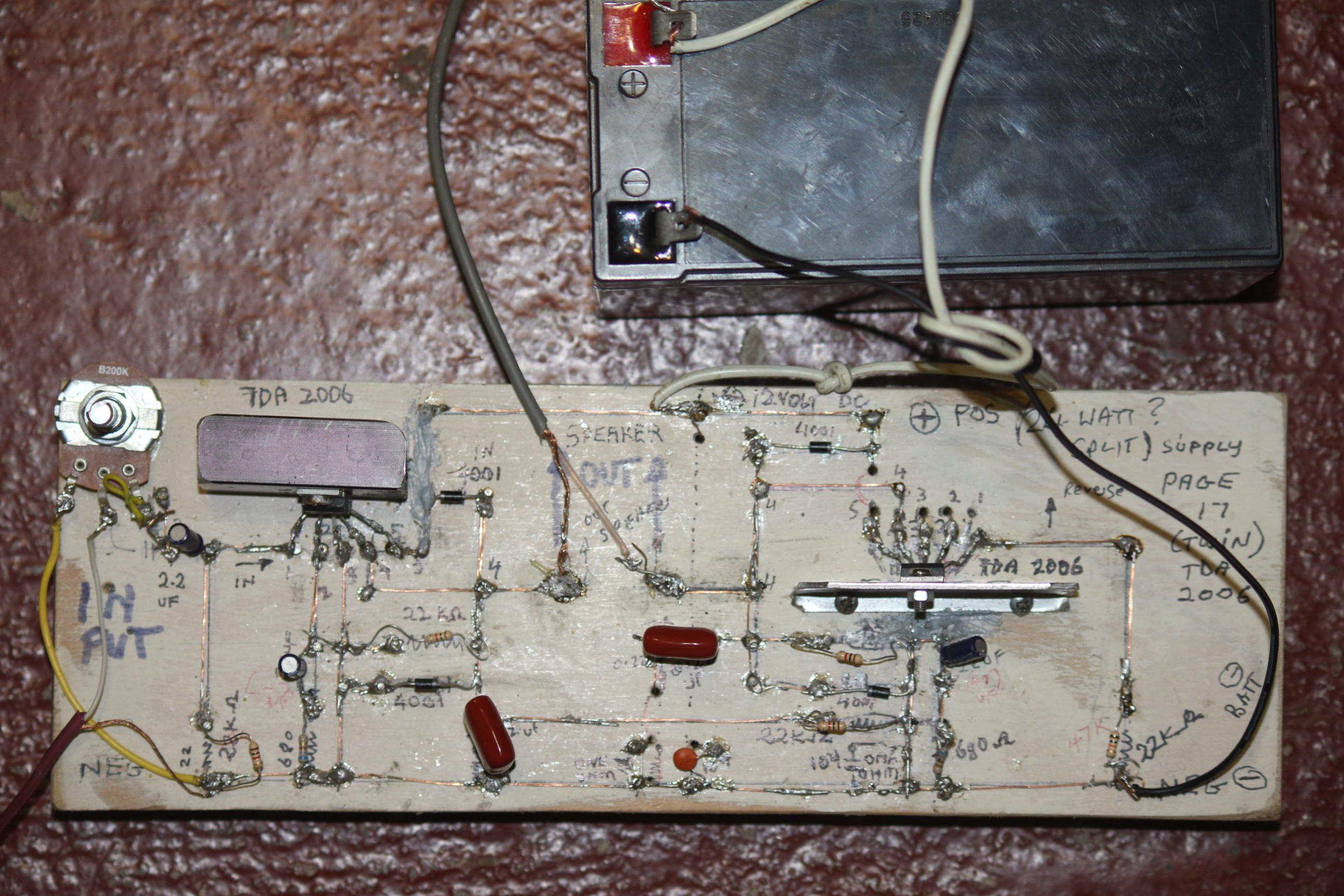

FOTO OF MY CIRCUIT - fig 17 bridge amp ( twin TDA 2006 AMP)
Hi mark --
here is a foto of the actual bridge amp conf fig 17 --converted
to a practical format for wiring up both opposing TDA,s
can u show me where precisely to connect 24 volts to what PINS
THE MANUFACTURER EMPHASISES 12 --16 VOLTS SUPPLY
cannot find 24 volt wiring diagram anywhere --I really need a 24 volt
actual SCHEMATIC --NO WONDER THE DAMN THING NEVER WORKED
--NO MENTION ANYWHERE OF 2X 12VOLT BATTERIES IN SERIES
but you are right ---weird connections --not for amateurs --!
I cannot still figure what 0 means ? --NEGATIVE VOLT ? NEGATIVE TERMINAL? ?? ZERO VOLTS ??

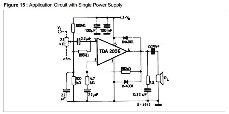

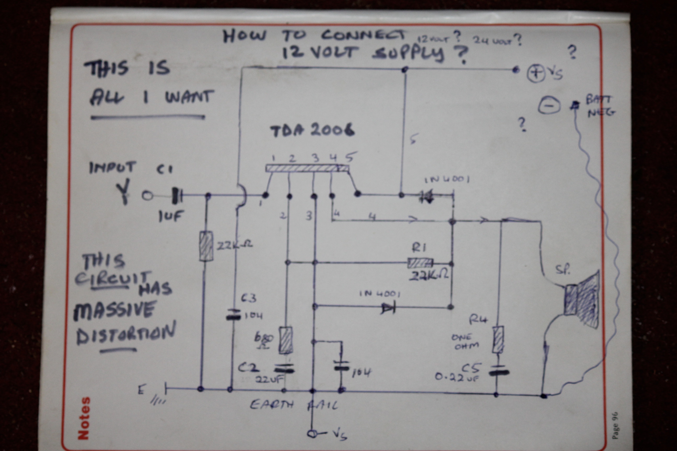

WHY DOES THE FIRST ( TYPICAL SINGLE SUPPLY DISTORT )
Does the single TDA 2006 CIRCUIT ( IE THE very first typical circuit shown in the makers PDF ) does that use two x 12 volt batteries as well /?
OR if I build the first single supply circuit----- AGAIN ( for the 12 th time!----can u show me how to connect TWO 12VOLT BATTERIES IN SERIES INTO THE SINGLE SUPPLY SCHEMATIC ??--- or is that incorrect??😕
CAN U SEND ME A DRAWING ---THE SINGLE TDA CHIP IS ALL I WANT -( 12 WATT ) --I only built this dual chip monster to STOP DISTORTION !
OK now I am in a realy dilemma ---those schematics were so misleading =
maybe intentionally -- so u have to burn out your circuit --then the chip maker scores big time on fools like me who keep buying chip after chip
--sods !--but its my fault --rushing in without heeding any warning signals
conveniently provided --cost me a small fortune --replacing batteries
ordering brand new components etc --
ok enuf grumbling --here is my 15 th attempt that drove me up the wall !

power into my-- SIMPLE SINGLE CIRCUIT--THE FIRST SCHEMATIC --PAGE 1
circuit ----WHY no MENTION OF 24 VOLTS IN THE PDF makers schematic
circuits for TDA 2006 -?-- WHY DID THEY FAIL TO MENTION THIS ?
as you can read --only 12 VOLT SPLIT SUPPLY ( VERY CONFLICTING /MISLEADING INFO )
no wonder the chip amp DISTORTS
REALLY NEED JUST THE SINGLE SUPPLY 12V FIRST SCHEMATIC -
10 -12 WATT ----THATS ALL ---NOW HOW DO I CONNECT 2 X 12 VOLT BATTERIES INTO THIS SINGLE CHIP CIRCUIT ? WILL IT DISTORT AGAIN ?
PLEASE HELP ----24 VOLTS ----? BAFFLED!-- PLEASE read the replies

no idea how to connect 24 volts into that twin bridge fig 17 amp
conf ---don't need it --only tried it cos I thought it may NOT DISTORT
like all the others

You can connect my PSU schematic to any of the schematics with split power supply, +Vs to +Vs, -Vs to -Vs and GND to GND.
According to the datasheet the minimum Supply Voltage is ±6V, meaning plus and minus 6V or a single supply of 12V. With a 12v single supply the maximum output power is only going to be about 5 watts into a 4 ohm load.
For a single power supply use diagrams 15 and 16. See the 2200uF capacitor at the output and the extra resistors at the input.

err --what is a PSU schematic?---I still do not know what is meant by a
SPLIT POWER SUPPLY--
ok --have built that fig 15 single power supply 5 times --
it has 3 100 k ohm resistors cluttered around pin 1---
input------ I used 2200 uf ---1000 uf caps at output --
alas --terrible distortion --
I CANNOT VISUALISE THE 12 VOLT BATTERY CONNECTIONS TO ANY OF THE
CIRCUITS -----I REALLY NEED A DIAGRAM ---SCHEMATIC ---A HAND DRAWN CIRCUIT WILL SHOW ME INSTANLY EXACTLY WHERE TO CONNECT EACH 12 VOLT BATTERY POS AND NEG TERMINALS---I DO NOT UNDERSTAND YOUR SERIES DIAGRAM ---SHOWING A MIDDLE POINT BETWEEN THE 2 SERIES 12V BATTERIES--
THAT MEANS THAT MIDDLE POINT CONNECTS WHERE EXACTLY?
OK --U SAY --12V POS TERMINALTO PINS 5 AND 5 ON EACH SIDE OF THE STEREO TWIN TDA CHIPS---AND WHAT GOES TO PINS 3 AND 3 ---ON EACH SIDE OF EACH
SEPARATE TDA CHIP?----THE NEGATIVE /EARTH TERMINAL ---? THAT IS 24 VOLTS RIGHT ??--- OK THEN WHERE DOES THAT INBETWEEN 2 BATTERIES TERMINAL
GO TO ??? That's where I lose this whole plot ---

this IS THE CIRCUIT I NEED TO BUILD( AGAIN)
YO MARK -
I HAVE DRAWN CAREFULLY THAT FIRST TDA CIRCUIT FOR YOU TO
ADD THE VERY ESSENTIAL VOLTAGE CONNECTION METHOD --THAT HAS CREATED THE DISTORTION IN YHR FIRST PLACE
THIS IS MY PRACTICAL CIRCUIT ---WIRED LOGICALLY FOR SIMPLICITY -
PLEASE SHOW N -ME HOW 12VOLT OT 24 VOLT CONNECTS WHERE
ABOUTS ---??----CARL-
---PLEASE ----B4 I LOSE MY MIND !---JUST SEND BACK TO ME WITH ALL THE BATTERY CONNECTIONS THAT I CANNOT FATHOM ----REALLY
WILL SORT THIS PROBLEM ONCE AND FOR ALL --😕

Looks to me like you are missing the output capacitor. 2200 micro F.
With single 12V power supply, you have 6 volts on the output leg of the TDA.
Capacitor is needed to stop DC voltage going to the speaker.
PSU schematic is at post 29.
The middle point connects to the amp GND (ground), -Vs doesn't connect to GND. Add the schematic from post 29 to schematic 15 of the datasheet.
The heatsinks are far to small and you need to reduce the lengths of the component leads.
Plenty of LM1875 / TDA2030 point 2 point / p2p examples on internet, but first its more important to understand what you are building and how it works. I will look for some good websites for info.
Hi.
Just looked again at the IC datasheet and your drawing.
You are trying to use a symmetrical power supply application , with single 12 volt's. It won't work. Follow the schematic with 2200 micro farad capacitor on the output and it will be ok with 12 volt battery
Also the connection between leg 2 and 3 in your schematic is wrong. R1 22k resistor should only be connected to leg 2.
CHECK AGAIN --PIN 2 AND 3 ARE CONNECTED HUMBERTO --
THERE IS NO 2200 MF CAP ON THE FIRST SCHEMATIC CIRCUIT
PLEASE D/L THE TAD PDF ----LOOK CAREFULLY --
HAVE BEEN 3 MONTHS -15 CIRCUITS LATER --ALL 3 SCHEMATICS DISTORT
SO --DISCONNECT LEG 2 AND 3 --? CIRCUIT DIES MY FRIEND !
BEEN OVER IT A THOUSAND TIMES
IF ANYONE CAN SEND ME A SUCCESSFUL WORKING TDA 2006 CIRCUIT
WITHOUT DISTORTION --INSTEAD OF UNPROVEN THEORIES --I WILL BE VERY GRATEFUL - BUT NO-ONE HAS SENT ME A WORKING CIRCUIT IN 4 DAYS
EASY TO CRITISISE ---4 HEAVENS SAKE ---GO BUILD THE 3 CIRCUITS
AND PROVE U ARE A BETTER PERSON --I WILL APOLOGISE UNCONDITIONALY
THANKYOU ALL ---BUT WE ARE GETTING NOWHERE REGARDS --CARL
EXCEPT MARK WHITNEY ---WHO TELLS ME THE CIRCUITS ARE 24 VOLT SERIES
2 X 21 VOLT BATTERIES -NOT 12 VOLT !
BUT I CANNOT SEE HOW TO CONNECT 24 VOLT TO ANY OF MY DOZEN ATTEMPTS
I NEED A CLEAR CIRCUIT DRAWING PLEASE PLEASE
