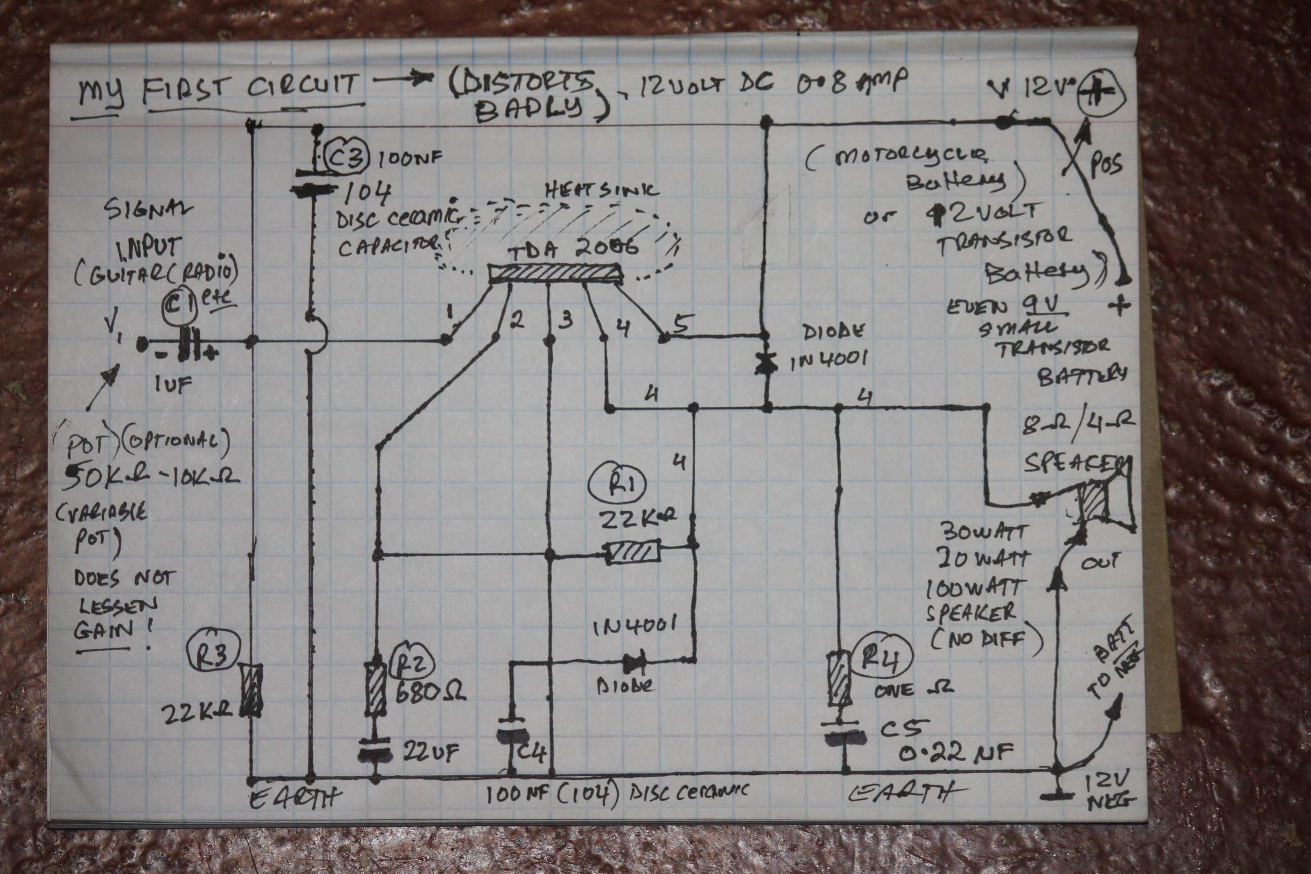

MARK -PLEASE ILLUSTRATE YOUR SUGGESTION --
PLEASE SEND ME A DIAGRAM -OF HOW TO WIRE UP THE 24 VOLT
BUT I AM NOT SHOWING U OR USING FIG 15
I AM USING THE VERY VERY FIRST CIRCUIT THAT APPEARS ON THE TDA2006 PDF
PLEASE ONLY REFER TO THAT "TYPICAL CIRCUIT " ---
HOW DOES THREAD 29 DRAWING FIT INTO THE CIRCUIT --3 TERMINALS --
PLUS U SAY 12V NEG GOES TO PINS 3 ???
AGAIN ---I DO NOT UNDERSTAND YOUR VERY BRIEF OUTLINE --YOUR TERMINOLGY IS DIFFICULT TO FOLLOW ---
BEST IS A SIMPLE DRAWING --PLEASE SEND ME A DRAWING OF WHAT IS IN YOUR HEAD --I KNOW YOU HAVE THE SOLUTION ---BUT I WILL BURN THAT CHIP --ONE WRONG CONNECTION --I HAVE NO IDEA HOW TO CONNECT YOUR 2 X12V BATTERIES

PINS 2 -TO 3
EXACTLY WHAT I SAW /REALISED HUMBERTO -
WELL SPOTTED ---IF YOU STUDY THAT RIDICULOUS CIRCUIT SCHEMATIC
IT LOOKS LIKE PIN 2 SHOULD CROSS OVER 3 -THERE IS NO CLEAR
JOINT DOT SHOWN --TOOK ME WEEKS TO FIGURE OUT -
THEY MUST BE JOINED ---JUST TRY SEPARATE THEM ---
NO SOUND --ALL DEAD --CONNECT THEM AGAIN -- ALL COMES BACK \
FULL POWER -- WEIRD ? YES --
THIS TYPE OF DRAWING SCHEMATIC IS UNACCEPTABLE --
YOU HAVE AGONISED LIKE I DID IS IT OR IS IT NOT JOINED??
WELL IT IS --SADLY ITS NOT THE SOURCE OF THE DISTORTION
MY FRIEND --HAS TO BE MARKS ASSERTION --TWO 12VOLT BATTERIES
!!!IN SERIES

HUMBERTO ---I AM ONLY INTERESTED IN THE FIRST TDA SCHEMATIC --
IT HAS ZERO ---IE NO 2200 OUT PUT CAP ---LOOK AGAIN--
FIG 15 IDS DIFFERENT --HAS MANY MORE COMP ---INCLUDING THA 2200 MF CAP
BUT I AM NOT BUILDING THE 15 AND 17 CIRCUITS --JUST THE FIRST SIMPLE ONE
THAT ROARS LIKE A LION --STILL WAITING FOR A CLEVER FELLA TO BSEND ME HIS
SUCCESSFUL CIRCUIT ---!!--MANY SAY THIS AND THAT ---PROVE IT !!

WOW --THANKS HUMBERTO --BUT WHAT ON EARTH IS GND COMMON FROM BATTERY ?----A 12 VOLT BATTERY HAS ONLY 2 TERMINALS ---? I SEE 3 DIFFERENT CONN POINTS ?
OK DO U MEAN USE 2X 6VOLT BATTERIES?--OR TWO X 12VOLT BATTERIES
WHERE ARE THE BATTERIES ?----HOW DO THEY CONNECT TOGETHER IN SERIES AS MARK TRIED TO EXPLAIN ? DO U TAKE OFF A ARBITRARY O" TERMINAL SOMEWHERE INBETWEEN THE 2 BATTERIES ? SURELY 24 VOLTS WILL COOK THGE TDA 2006 CHIP ?
IF I CUT THE LINK BETWEEN PINS 2 AND 3 ---I AGREE --THEY SHUD NOT BE JOINED
BUT WILL IT WORK ? NOW I AM MORE PERPLEXED --
GIVE ME A CLEARER CONNECTION ---I DO NOT UNDERSTAND WHY 3 CONNECTIONS -
FROM 2 BATTERIES --MUST BE 4 TERMINALS FROM 2 BATTERIES SURELY ?
OR 2 X 6VOLT --? OR 2X 12 VOLT ? ---
NOW I AM LOST ----HELP !
I NEED MORE ACCURATE DRAWING OF THE SINGLE OR TWIN BATTERY CONNECTIONS TO THAT CIRCUIT ---THOSE RED LINES LOOK SCARY

So you built split supply 5X as complex TDA7294 5 years ago but now have no clue about what a split supply is? UNBELIEVABLE.have made so many amps ---- eg--the
TDA 7294 I BUILT 5 YRS AGO ----140 WATT mono amp
worked wonderful --till I blew it on overdrive solos with a
Gibson les Paul humbucker

so grateful Humberto ---Yourself and Mark are my saviour ---
you guys certainly know your craft ---
I am off to purchase another 12 volt battery ----will connect using your battery schematic --- 2 x12v batteries into a single TDA amp?
please explain why the TDA 2006 PDF ----says this amp uses 12 -15 volts MAX?
WHY not simply --say --- " use TWO 12VOLT BATTERIES IN 12 -0 - 12 config??
no mention of
still wary of the neg to pos bridge between the two 12volt batteries -you call it
GROUND ? GND ? -- surely ground is same as EARTH?----
SO -- 3 connections --3 takeoffs from 2 x12volt batteries ---
