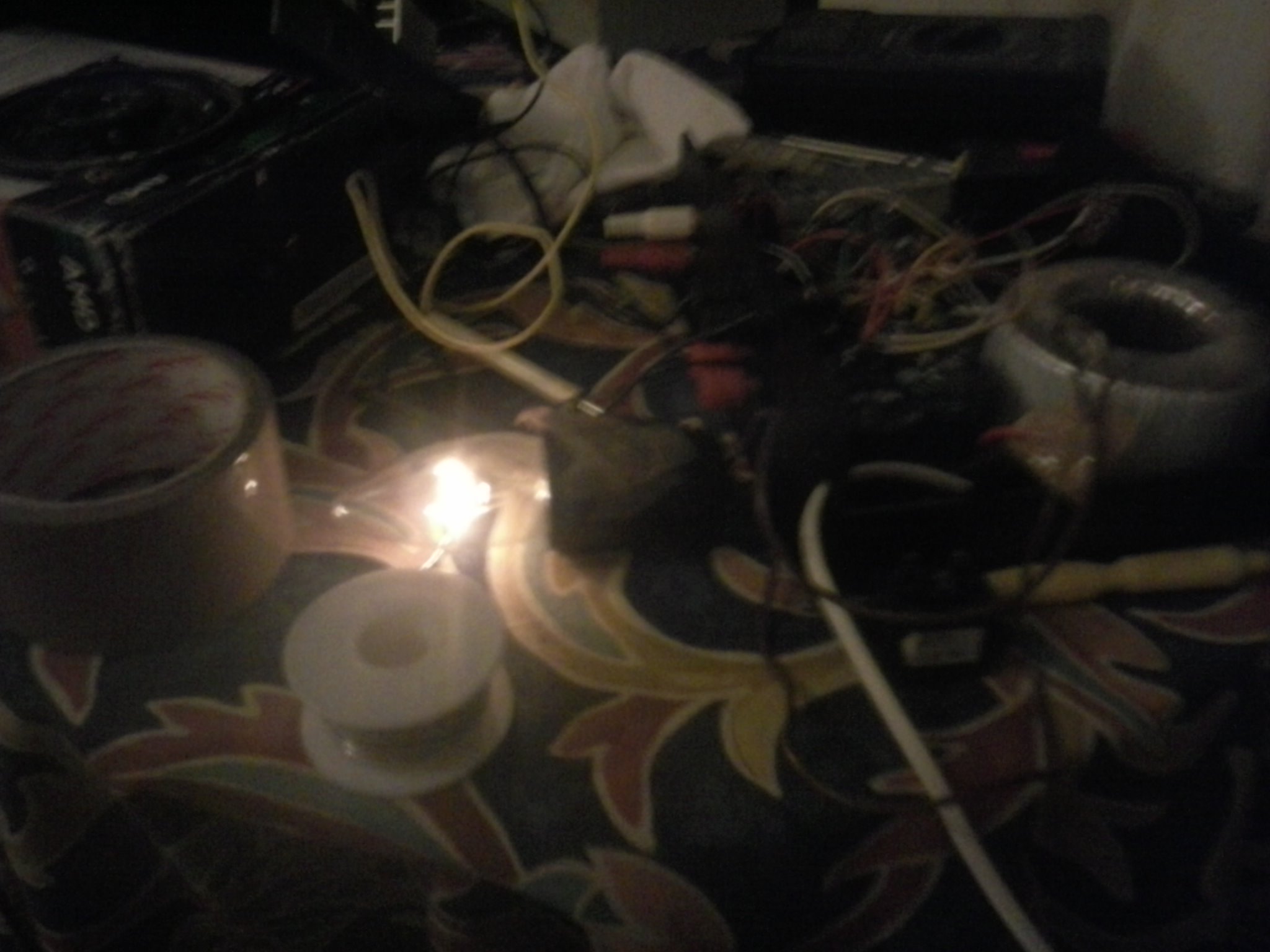

Yes ,large offset causes escess curent and heat to be profuced,when i turn it on one chanell has no dc offset and one has 3 v help me
the tes bulb glows bright,but if i unplug the speaker from the problem chanell the consumption goes to normal

Single or split supply?
Did you put diodes between Vee & Vcc? Maybe one of them is shorted...

i fixed it,the resistor hooked up for nfb at pin 2 made bad contact. still dont understand how that pissed it off.
now the amp is idling cool without diodes,and the 25watt tes lamp is orange-yellow.sound is a very quiet though my phone outputs 0.2-0,3v and gain resistors are 22 and 1 k so gain must be 23
23 x 0.2 should be still 4.3 but it isnt even close,

Lamp is this bright AT idle and that huge heatsink is at 50c,hmmm,oscilation? my analog multimeter reads 4v when music is playng but it isnt that loud,maybe most signal is drowned by oscilation. i used 10r resistors and 104 caps in zobel,.
How could we fix this oscilation bug?.grounding is correct and worked this way in my tda2003.Ocassionaly the lamp gets a little dimer for a second.thanks in advance

If that's a 25W lamp I'd think that's all quite normal, E-Core transformers have relatively high idle currents.

i have taken it apart and put it togheter and now its very cool,lamp doesn even light up,but still quiet,i will try to reduce current limiting
nope still quiet,25w lamp dosent light at all even when volume is at max but it is quiet,less than 1 watt
no longer quiet,but it seems to distort away after 30 sec on 100w,over a period which speakers go up and up untill it distorts away,sounds as if only one rail is present.
could it be because the rail voltage is going down,and the lm1875t acts weird on low supply voltages,or what. apart from this it works very well.

yes,the voltage is going down because of huge offsets in both speakers

Works,perfectly just very hot,need new heatsink,very clear sound,it just needed 2 10k pull down resistors from input to gnd and works perfectlly.
Moral of the story? no matter how much you are a professional you will still make mistakes if you dont listen closely to the diagram in the pdf

it ok to use 10r resisistor for zobel?
I think it's meant to be 1 Ohm? Increasing it can cause instability/oscillation and this can certainly lead to the high operating temperatures you're experiencing. It'll impede the sound quality too of course.
yes it wasnt ok,it works better with 1 ohm
