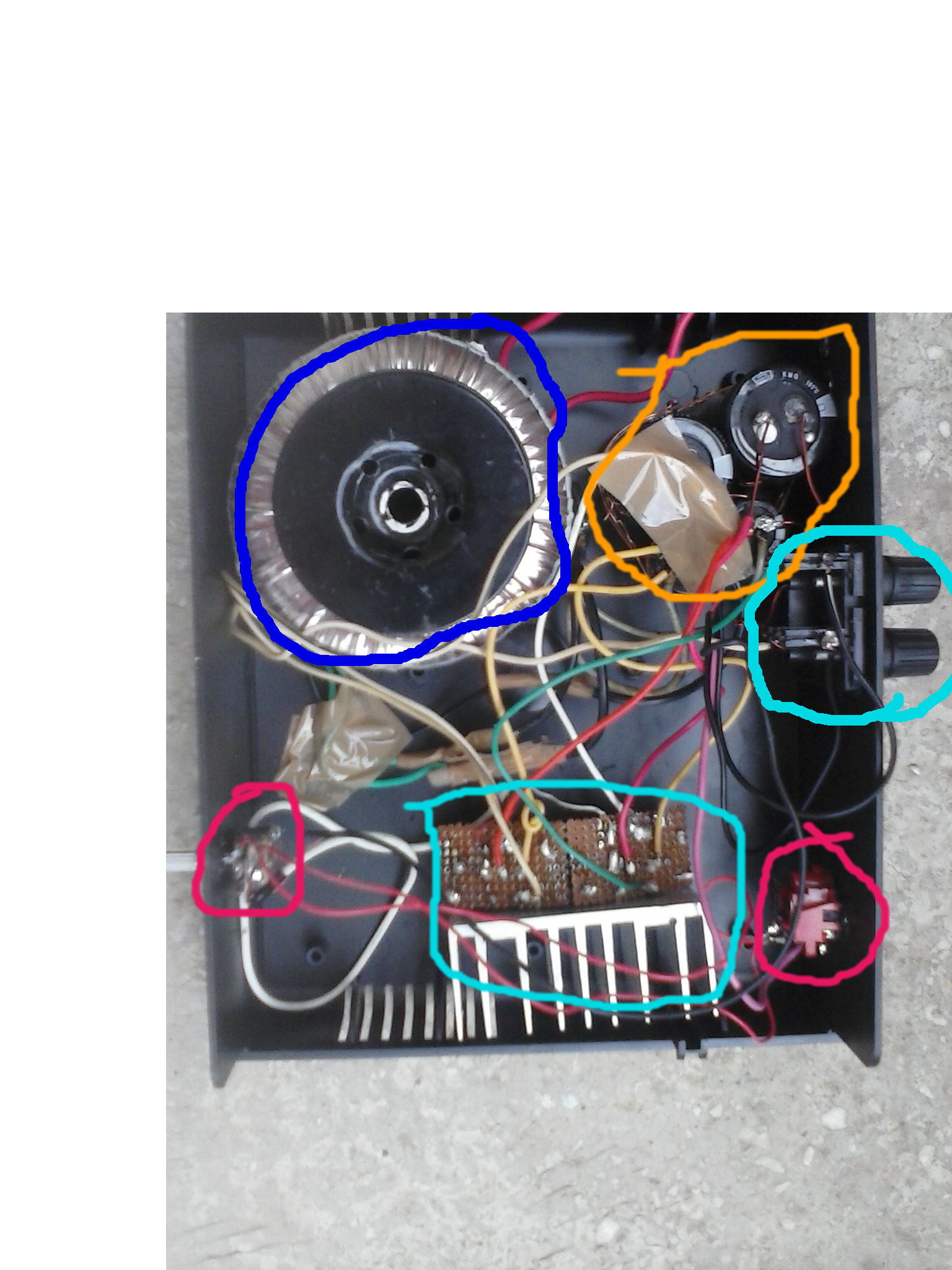

how loud was the transformer buzzing then ....?? if it just a faint buzzing close enough to the transformer to hear it then it is normal
About as loud as a gas powered chainsaw,but now i fixed it.its now as loud as a computer fan.
It seems to have reduced hum under load,in short circuit or during the charging period of the caps.
It is very variable in loudness,and teperature is about 60c-80c,is it ok?.noise is reduced when i press on the metal casing.I will start winding toroidals,since they seem easier but i need the calculations for them!

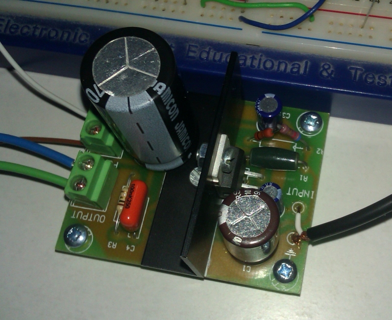

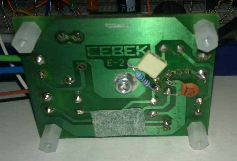

I dug out my TDA board, it's actually TDA2002 but same circuit topology:
Cebek kits (E-2 module)

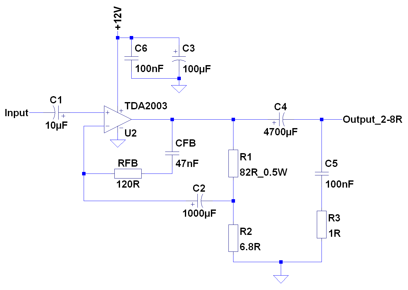

It's built to the datasheet application design and the first thing I noticed was far too much gain. This amplifier produces 2 Watts into 8 Ohms, so the voltage output is about 4V RMS. The voltage gain in the reference is set to 100x (40dB), so we could push it to clipping with just 40mV RMS input! I don't know any sources with such limited voltage drive, most can produce more like 500mV RMS.
R1 and R2 ratio can be altered to reduce gain, I'm not sure if there's a minimum but I'll present a design with 12x (21.6dB) gain, which I'm confident would be stable. On the kit I experimentally I added resistance in parallel with the 220R to lower its value and noted a substantial decrease in output noise, it actually became impressively quiet. In the schematic, R2 is also increased to lower gain further while keeping quiescent current reasonable. As a consequence, C2 is increased to keep PSRR high.
The high frequency feedback network is omitted on my kit but probably should be in place. The values I've shown should keep bandwidth to 40kHz or so, the 15kHz of the datasheet is somewhat restrictive.
The output coupling capacitor should be larger, not really to extend low end roll-off, but to minimise the voltage accross that capacitor and hence keep distortion low. This is optional and the device doesn't exhibit stellar distortion performance in the first place, the effect on turn on/off thump remains to be heard.
I'll give these changes a go on the little kit, shame it isn't the improved TDA2003 chip though.

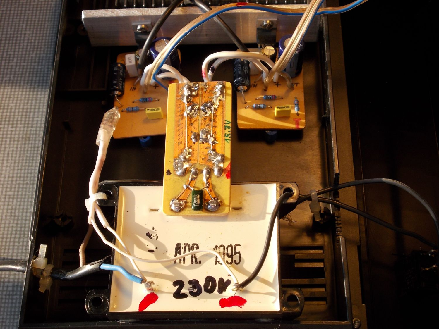

Mine has 250VA toroid inside, in the same case where i had my LM4766 that needs a bit work...
Has no PCB so... i soldered 4mmx0,7mm flat copper to copper heatsink and used it as ground
Most components are held by it minimum pressure on chip pins.
Make it look g00d even the inside of amp must look perfect.
