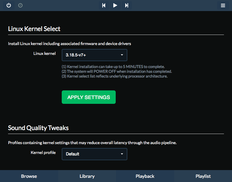

Interesting to watch the continued evolution of the Raspberry Pi 🙂
Here's a brief update on some features I'm working on that may make it into release 1.6 which is planned for sometime in February. Screenshots attached.
(1) SOX RESAMPLER seems to be working ok with standard conversion recipes (below). but needs more testing. The big advantage of using SoX over SRC is that SoX is much more efficient and uses significantly less cpu. This is goodness for feeding up-sampled audio to those NOS DAC's 🙂 🙂
Here are the standard conversion recipes.
- SoX Medium Quality: 95% bandwidth, 100dB noise rejection, linear phase
- SoX High Quality: 95% bandwidth, 120dB noise rejection, linear phase
- SoX Very High Quality: 95% bandwidth, 175dB noise rejection, linear phase
There are some additional recipes including SOXR_LSR0Q, SOXR_LSR1Q, SOXR_LSR2Q, that are designed to emulate SRC/libsamplerate Best/Medium/Fastest but are not yet offered in MPD. Maybe they will appear in a future version!

(3) NAME CHANGE FIELDS on the System Config page. Player, Browser Title, Airplay, UPNP, DLNA names, etc.
(4) PRESETS for Song/Radio Station accessible from the Playback panel for quickly changing whats playing without having to go through Playlist or Browse.

(1) SOX RESAMPLER: testing complete and fully integrated into the Player. Loving that low CPU utilization!
(2) KERNEL SELECT: testing complete, partially integrated into the Player.
The Kernel Select feature allows different Linux kernels to be installed right from the Player System Config page. Since each kernel version includes associated firmware and device drivers, if audio issues exist when running with with a particular kernel, another one can be selected that may resolve the issues 🙂 Tested up through 3.18.5 (latest Raspbian).
(3) PRESETS: several designs complete

TCMODS Player Release 1.6 is available for download from tcmods.org 🙂
This release includes SoX resampler, Linux Kernel Select, Raspberry Pi 2B (ARMv7l) support and support for Device Tree Overlay, a new method implemented in the Raspbian 3.18.5+ kernel for loading I2S and other device drivers.
Feature highlights:
(1) Kernel Select provides a Player integrated mechanism for switching OS kernels and associated firmware and device drivers. This provides enhanced device and platform support, and allows for new kernels to be added going forward.
(2) Device Tree Overlay provides a simplified method for loading device drivers and ultimately will allow device drivers to be loaded automatically by the OS. The link below has more information.
Raspberry Pi Documentation
(3) Also included are several great new radio stations, UI refinements and bug fixes. Refer to the attached release notes for details. Screen shots attached.
Enjoy the sound!
