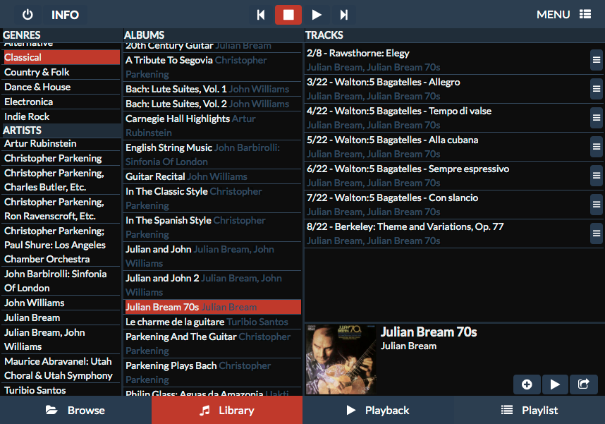

Working on cover art and metadata for the library panel 🙂
Before and after screen shots below.
tcmods.org
TC

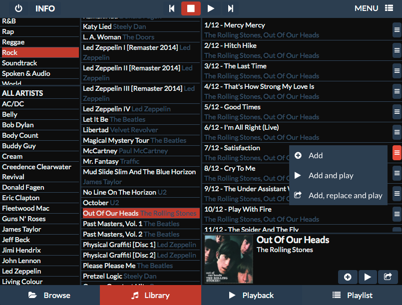

Completing the mods to the Library panel, the song rows now have a standard Action menu. Screen shot below.
When this code is finished and tested, I'll push out release 1.2 beta2 🙂 and then start working on the code behind the new Action menu for the Playlist panel.
tcmods.org
TC

Correction: should be Webradio Panel
One last mod for the Library panel 🙂
Non-scrollable, click enabled column headers to replace the scrollable "ALL..." item in the lists which require scrolling back to the top to click. Screen shot below.
A bit more coding and testing and the Library panel mods should be ready for beta release!
