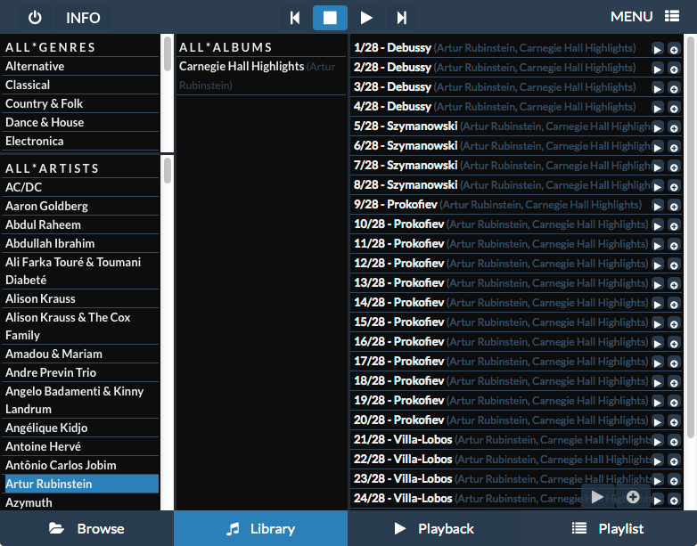

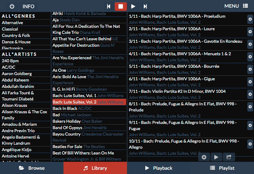

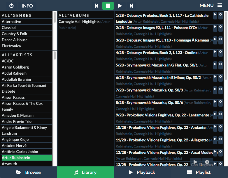

I've just finished fixing the Library parsing bug 🙂 This is where if a song title contains a colon character ":" everything after the colon gets truncated. It affects song title display in the Library, Playback and Playlist panels! BTW, song titles with a colon are commonly found in the Classical genre. In the example song titles below, the parsing bug would cause only "Szymanowski" to be displayed.
Szymanowski: Mazurka In G Flat, Op. 50/1
Szymanowski: Mazurka In E Minor, Op. 50/2
The screen shots below show the Library panel before and after the bug fix.
TC

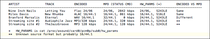

WRT odd bit depths being reported by MPD, I posted a few questions along with the table below to the MPD help forum.
The table data suggests that MPD is defaulting MP3 stream input to 24 bit but I'm not sure what is going on with the 16 bit WAV file (a CD track rip) being handled as 32 bit by MPD.
TC
Max over at the MPD forums provided a nice explaination of whats going on with MPD bit depths. This is what MPD is doing:
(1) MP3: The property of bit depth does not exist in compressed file formats until they are decoded back to PCM. MPD uses libmad plugin to decode MP3 format and libmad outputs 28/44.1 PCM of which 24 bits are used by MPD.
(2) WAV: The libsndfile plugin is used by MPD to decode WAV format files and this decoder always outputs a bit depth of 32 bits.
(3) HW_PARAMS: This is the bit depth reported by ALSA and is what is actually sent to the audio device. If its lower than the MPD decoded bit depth, it reflects MPD falling back to a PCM bit depth that the audio hardware indicates it can support. This was the case in the WAV example where the decdoded bit depth was 32 bits but the DAC (a BerryNOS) can handle only up to 24 bit.
Bottom line is that MPD bit depth reporting is OK, but its not necessarily the source bit depth but rather the bit depth output by the particular decoder MPD is using.
I think all thats needed is a bit of editing in the Input Media section of the Audio Info popup to indicate what the bit depth actually reflects. Something like "(MPD decoder bit depth)".
Case closed 🙂

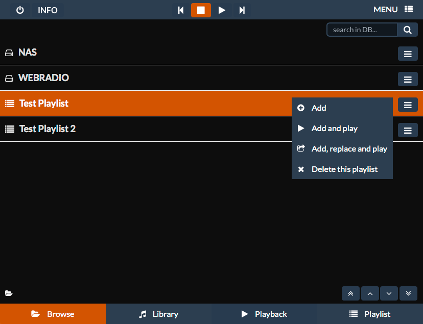

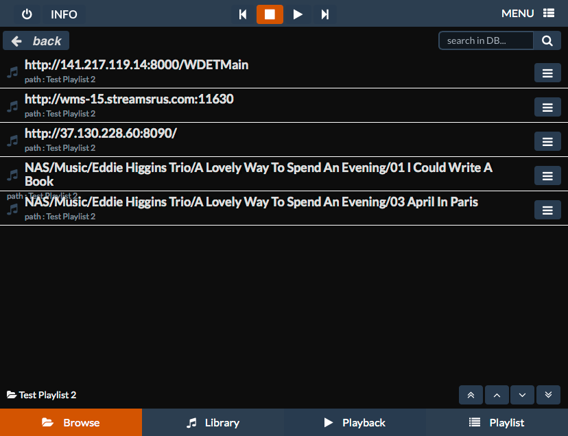

Continuing with work on "Up Next" items for release 1.1 🙂
I've just finished completing the saved playlist feature. The feature now includes the following fixes and new capabilities:
- FIX: Saved playlist name not showing up in Browse panel
- NEW: On click, list items in saved playlist
- NEW: Action menu for saved playlist includes "Delete this playlist"
- NEW: Action menu for saved playlist items includes Add, Add/play, Add/replace/play
The attached screen shots show 1 before and 2 after Browse panels.
Next I'll be working on general layout, text wrap and button size issues, the timed power off feature, then probably a release.
TC

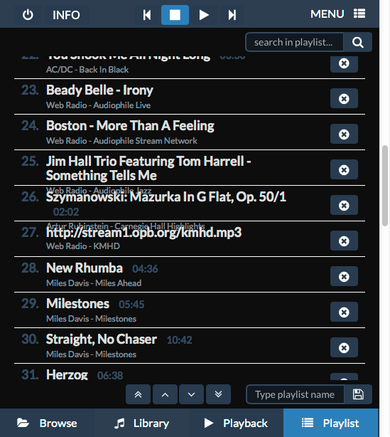

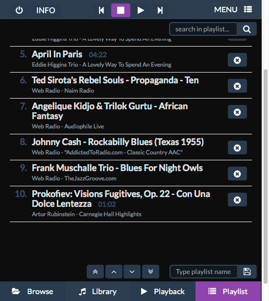

Just finished fixing the layout and text wrapping issues in the Browse and Playlist panels 🙂
In the attached "before" screen shot (blue), the title text wraps but the row height does not expand. This causes the line of text below the title to crash into the next row.
The "after" screen shots (amethyst) show the Playlist and Browse panels with the row height nicely expanding when the title text wraps.

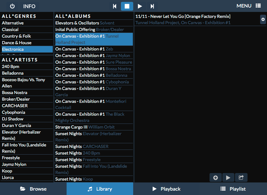

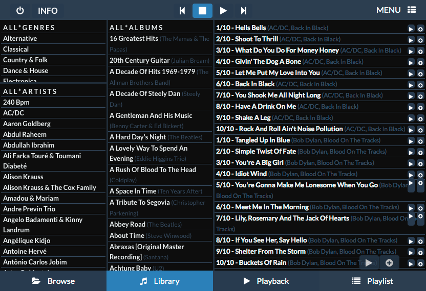

Here is an update on mods to the Library panel to improve the layout, text readability and action buttons.
The attached images show before (blue) and after (alizarin) screen shots of the panel. The new panel has a 20/30/50% horizontal layout providing more room for album names, double high song rows, larger text, larger Addsong button and three standard action buttons (Add, AddPlay, AddReplacePlay) on the bottom for handling song lists.
The 1.1 release is looking like this so far 🙂

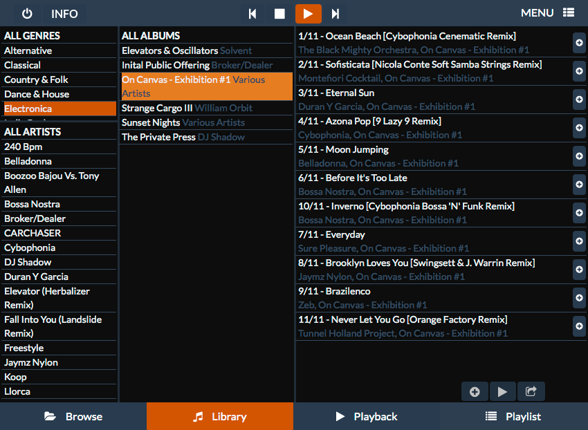

I started working on the Clock Radio feature but became distracted thinking about how to handle Compilation Albums in the Library. Currently, each compilation album shows up as a series of individual albums, one for each artist in the compiltion. This is due to how the Library is organized.
First step was to figure out how 'jotak's elegant and amazing core Library filtering and rendering code works and then determine whether its possible to integrate Compilation Albums so that each one shows up as a single, rolled up album.
It appears to be doable, but I'm not quite finished yet. When complete I'll post release 1.1 🙂
The attached images show before (river) and after (carrot) screen shots of the panel.

- NEW: Saved playlist Click lists the items in the playlist
- NEW: Saved playlist root Action Menu includes "Delete this playlist"
- NEW: Saved playlist item Action Menu includes only Add, Add/play, Add/replace/play (same for Browse item)

- NEW: Library panel compilation albums rolled up by album name
- NEW: Library panel Add/replace/play all btn
- NEW: Library panel double high songlist rows and large Addsong btn for ease of use on touch
- NEW: Library panel notify messages for Playall, Addall and Add/replace/playall buttons
- NEW: Library panel custom hover color for Addsong btn for improved visability
- NEW: Library panel animated icon on Library button for long running actions
