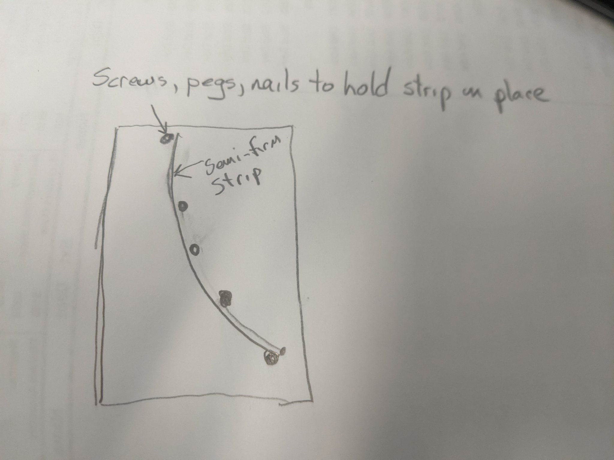

That sounds like a good plan. Another idea is to build the Frugal horns. Many people are intimidated by the curve, but it's not very hard to do. You can use a flexible but somewhat firm yardstick or other strip of metal or wood as a router guide. I included a very rough sketch of my suggestion for cutting the curve.

That one lends more to the TC9 I believe, have also looked at it. I have all the necessary tools for the curve, plus a good friend of mine is a professional cabinet maker with a CNC and can make those pieces for me for free; all I need is to provide the wood. Now which one will be a better sounding speaker, the Pensil or the Frugal?
