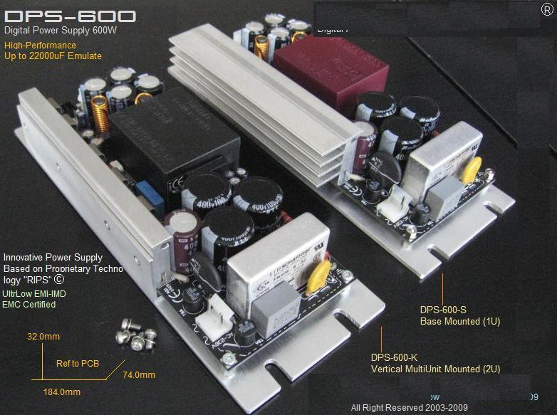

The TC modules are surprisingly natural sounding, but the downsides are, that you have to build your own PSU´s for both 50-70V and for 12V, and then you need a very high quality buffer.
Lately a friend brought around the Hypex amps, which were supplied from a huge UI core transformer, 1.5KVA I think, and smoothed by BHC slitfoil caps, but the TC module with ONE single 100VA toroid and less than 10.000µF smoothing capacitance, seemed both more powerfull and a lot more natural and present.
HI,
I'm curious to hear a TC module, (resolution and power at low frequency).
I may be surprised ..!

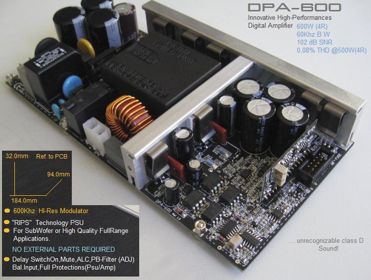

I know only that .. it took me 2 years to develop a new type of modulation on class D amplifier. (for now I can not mention the name)
I constantly during development compared a MosPower class AB, including the way of clipping, (up to natural pure square rail voltage), listening and measures with regard to class AB continuously.
I finished only when some audiophiles with anechoic chamber, have not recognized the digital amplifier between esoteric class AB.
As I said before, not enough fb and low-pas filter.se enough, all amplifiers will sound great!
I heard some sounds clean (up to 60% of PWM) but ... without big, deep bass (typical of good class AB) or with low resolution in the upper part of the sound.
I see many chip Class D up to 600W. also 600 small radio 1W .. do 600w!
during development I realized that despite THD (0.02% flat up to 40KHz), the sound was still digital amplifier, the mospower had a very different sound.🙄
Therefore, I remain of the opinion that it is not easy to emulate the good old class AB🙂
PS.
I think that will be marketed soon and I can send you one for test (without money). I think you have good speakers for your big class A🙂

Hi AP2
I do know it is not easy to make a good class D amp, but it is not at al easy to design neither a good class AB amp, nor a good class A amp.
Everyone of them are difficult in their own ways.
Linear amplifiers need very good power supplies, and IMHO very thorough regulation af the supplies for the voltage stage. They need to be masive oversized in every stage to perform effortlessly in any load.
That is both expensive and heavy, and worst of all, in class A it creates substantial amounts of heat, making listening to music a winter hobby.
My class A amp elevates the ambient temp by as much as 6-7 dgr. C.
The class D amp is a quite different challenge, which you probably know very well already.
What I do know something about is listening, and IMHO this amp will never come out of any listening test as a digital device. The first reason is, that it isn´t really digital, next is, that it performs very different from other PWM designs I´ve heard.
It does in fact sound pretty much like a very well designed class A amp, it has the smoothness and it also has the authority and effortlesness.
Excactly that has been my reason, to stay put with my huge class A amp consuming 1,2KW and delivering 2*100W of class A power @ 6 Ohm.
The only downside is in fact, that upstream components really have to perform, otherwise it´s a pain in a sore place.
In other words, this might not be an amp, which you with ease can put into any audio chain, this because it really seems as a wide range low Q component. Unfortunately I cannot give you any clou of what it sounds like, because I simply do not know any amp to compare with, but deep bass with awsome control seems to be one of he easy tasks for it, byt try it out yourself and be aware of the need for a good buffer.

Hi Kurt... The TC modules are surprisingly natural sounding, but the downsides are, that you have to build your own PSU´s for both 50-70V and for 12V, and then you need a very high quality buffer.
... but the TC module with ONE single 100VA toroid and less than 10.000µF smoothing capacitance, seemed both more powerfull and a lot more natural and present.
Are you saying that you are running two TC modules with one 100VA PSU which has less than 10,000uF of smoothing? And that it is achieving comparable results to your Class A amp? What is the Class A that you are using?
What very high quality buffer are you using?
Is your 12V supply regulated?
Also, what is the PSRR of the TC input stage?
How do you think the TC modules would perform with an SMPS with 60V or 70V DC output? Actually, do you think that the TC modules sound different with 60V or 70V DC PSU?

Hi Kurt,
I fully agree with you, PSU is "soul" of good amplifier (if amplifier is good).
sorry, I do not want to make publicity in this forum, I do not need, but I think that when it comes to real new technology may be interesting for everyone.
Now upload a photo of innovative integrated amplifier and PSU, look carefully, at present no company has ... the courage to put on a psu on amplifier board with audiophile performances.😀 Sound is very rock, not decrease under burst voltage (-2.7 V at 500W burst), this is impossible when I watch amplifier while playing.
power supply and amplifier have required very big money and long time for developments...I think!
research so it can produce results!🙂

Hi AP2
Yes PSU is both the heart and soul of a good amp.
I´ll have to ask a few questions about the nice pictures.
The left one looks to me like a class D amp with onboard SMPS - am I right?
Is it a full bridge design or is it a 2 channel amp?
How much power will the SMPS deliver, and is it smooth and silent?
Does it need external smoothing?
Does it feature low impedance?
Lot of questions 😀
Actually it looks pretty cool - did you do that?
yes, DPA600 is integrated amplifier one ch 600w (4R).no bridge
psu on board not is traditional, true new topology IMD free.
at 600w 4R (80hz) without ripple! this is impossible, psu not have big capacitors.
but complex new technology, I think a short time,laboratory publicate this "RIPS" (rotary power system) on the web.
psu not use traditionals chip and trasf.
this psu tested with a Big mospower 500W class A-B without ripple at SIN 120hz(4R).😀

just to be precise, amp in photo is a commercial audio version. There is also a version for lovers / audiophiles. tasks change, ex. toroidal filter is different, solder color is red. PSU not change.
soon as possible, I would have the pleasure to send you one to listen (if you want).
Power out is to punch in the stomach.🙂
