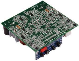

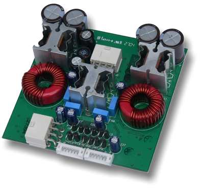

Kurt and Hurtig have given any further consideration as to how LME49990 can be used with the TC module.
