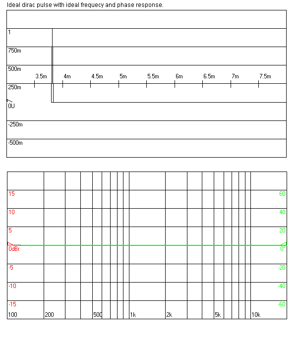

The first attachment is a Praxis display of an ideal dirac impulse response (IR). The data for the IR consists of just one positive integer preceded and followed by long strings of zero values. In the old days, we would graph this with bars. Since we were working with discrete data values we graphed them as such. Today, most of the software tries to imitate what would be seen on the screen of an analog oscilloscope displaying an analog signal.
For this example, the three data points graphed have time signatures of 3.7926667, 3.8135, and 3.8343333 msec. The only actual time signature with an associated data value is 3.8135. Regardless, as is proper, the graphing shows symmetrical rise and fall.
The second graph in the first attachment shows the frequency response and phase response of the ideal dirac. You can't actual see the frequency response because it is a perfect match of the phase response and is thus hidden.
Now, how do you get the phase response. Phase is an arbitrary concept. You might have seen a few SpeakerWorkshop posting with this weird looking increase frequency sawtooth pattern overlying the frequency response. This is caused by the arbitrary start of the phase transformation being set to the start of the data file and not the relevant data.
To get a more useful phase transformation you have to account for this difference in the beginning of the data set and the time position of the relevant data. For Praxis you input a delay value. This moves the start reference for the phase transformation to whatever data file time position you want. For the phase transformation presented her, that delay time was set to 3.8125 msec. This places the start for the phase transformation to the center of a data place.

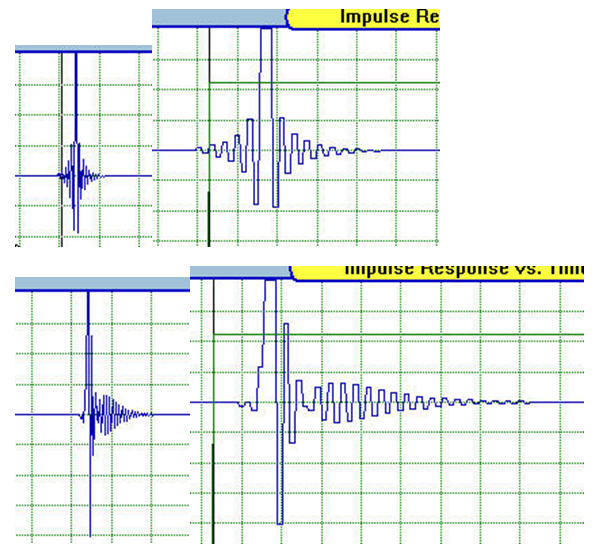

However, how critical is the quality of the generated impulse?
below are impulses generated from two different cards. If we do a loop back test, both will give perfectly flat phase response overlapping the frequency response. Does this make a difference during measurement? Something to think about.

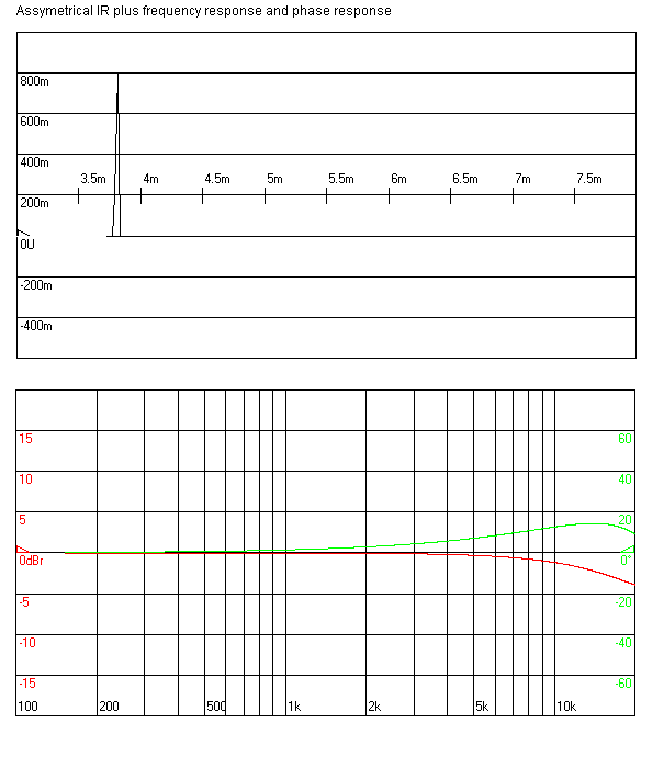

My second attachment shows the frequency and phase response when the Praxis delay is set one sample before and one sample after the data. Remember there is only one sample with data value. For this first run I am working with an ideal dirac.
If the delay is set to the sample before the ideal dirac, then the energy is lagging this arbitrarily determined point. And if we set the delay to the sample after, then the data is leading this second arbitrarily set point. Of course, this leading and lagging is frequency dependent and the transformation produces a graph showing the amount of lead or lag increasing with frequency.

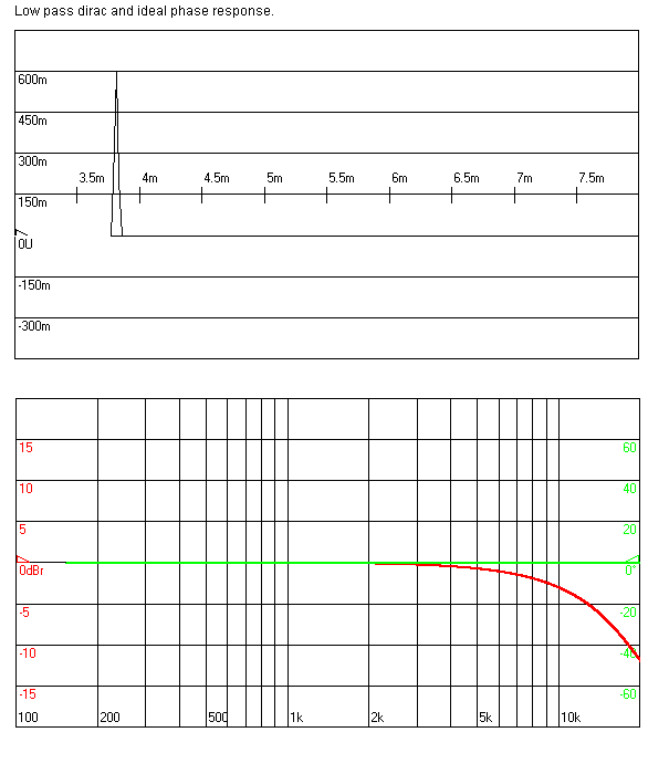

The dirac pulse in this example has been low pass filtered. It does, however, still have identical rise and fall times. The data has been redistributed to represent this bandwidth limitation while keeping the energy level the same. The ideal pulse was one significant data point with a value of 1. This second sample has three significant data points with values of .2, .6, and .2. The three significant data points still sum to the number 1.
Despite the symmetrical data, the software graphs the resulting IR as having asymmetrical slopes. Also, by using the same delay from attachment one, while the high frequency response is now limited, we still can show perfect phase. It does this because of the symmetrical data. When measuring transducers, you will never find one with perfectly symmetrical rise and fall times.

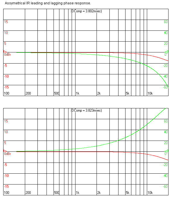

With attachment four, the impulse response is made asymmetrical. First significant data point has a value of .2 and the second significant data point has a value of .8. Again, the sum is one.
This type of data envelope is commonly seen in transducers. This impulse response is the pattern for when you have a bandwidth limited rising response. The magnitude of the error with actual transducers is usually much worse than shown here, but these two simple imperfect impulse responses of attachments three and four show the sensitivity to error.
We use impulse response transformations to increase our understanding of what we see in the impulse response. Mainly we use a frequency response transformation. Phase response is used less often and is more arbitrary in its presentation and interpretation. I find phase response of little value when evaluating a minimum phase system such as a full range transducer. Still, it is very useful for providing clues for when the data is problematic (whether because of a sad lack of knowledge on the part of the tester or intentional deception).

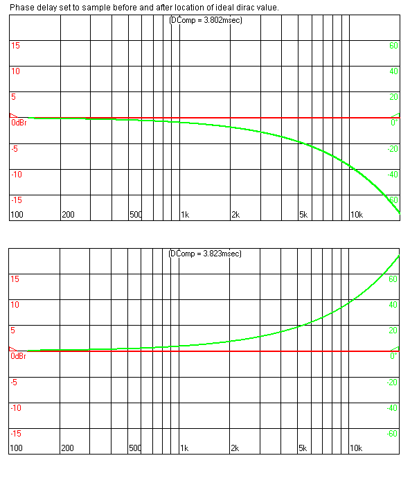

Attachment five shows the one before and one after sample delay offsets for leading and lagging phase. As stated in the reply of attachment two, this is a phenomena of the extremes. Here I have shown high frequency examples. The same applies to the low frequencies as well. No transducer is capable of infinite frequency response and will always show high and low frequency roll-off.
When examining an impulse response file with a phase transformation, look for the unexpected at the extremes. This will always show when excessive equalization has been used.
Also look to the bandpass. As the leading and lagging graphs show, phase will still be zero away from the stop band. When a transducer is claimed to have flat response and yet you cannot get the midband (bandpass) phase close to zero regardless of how you adjust your delay, this is a clue that something unnatural has been done to the data.
This assumes that you have access to the impulse response file. I doubt that I will have many people willing to send their impulse response files anymore. Since my interest was not in if the files were altered, but rather how, I am not concerned with ending my access to questionable data.
