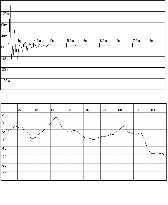

data revisited
I downloaded the data off the Dave's Web site. It was formatted as binary files instead of ASCII, but that was no problem.
In this and the next message I will attach impulse (time file), linear frequency response, waterfall, and step response.
There is a problem. I have an idea what it may be. For now, however, just look at the four interpretations of the time data and see if anything looks odd or out of place.
Looking at the impulse (time data) attached to the last post, read the data from left to right. Each time the magnitude changes direction equals a "spike." Counting from the left, spikes four and six are the oddity or problem.
All other graphs are just interpretations of the same data. Still each one shows the problem.

Isn't that interesting!
I read your second post. Nice eye Mark!
MLS measurements (such as MLSSA, used in my test suite) are not robust when measuring non-linear systems. When MLS based measurement is applied to a non-linear test path, artificial "spikes" can appear in the impulse response.
For background:
http://ieeexplore.ieee.org/iel1/2190/10505/00487942.pdf?arnumber=487942#search="MLS nonlinearity"
Perhaps this driver has some serious linearity issues, not visible in the frequency response. I'm hoping these issues are at 8 kHz, near the break up, but now I plan on making near field THD and IM measurements, to double check this.
FWIW, I can guarantee the test equipment is linear: the MLSSA card, the mic, pre amp and measurement amp.
Let me also go back and double check the impulse, to make sure this is in the other off axis files.

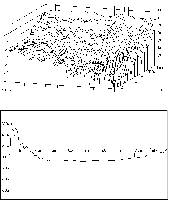

Uh Oh
Mark,
I went back and looked at my TIM files in MLSSA on the measurement PC.
The reason I didn't notice the errant spikes in the impulse responses is because they aren't there. When viewed in MLSSA, there are absolutely no out of ordinary spikes in the impulse response.
I don't know if this is a fault with MLSSA are your post processing on my files. MLSSA applies no smoothing in the time domain, so the spikes should be clearly visible if they are there.
I don't know why your version of the same file looks different than that presented by MLSSA.
Dave
Mark,
Dave

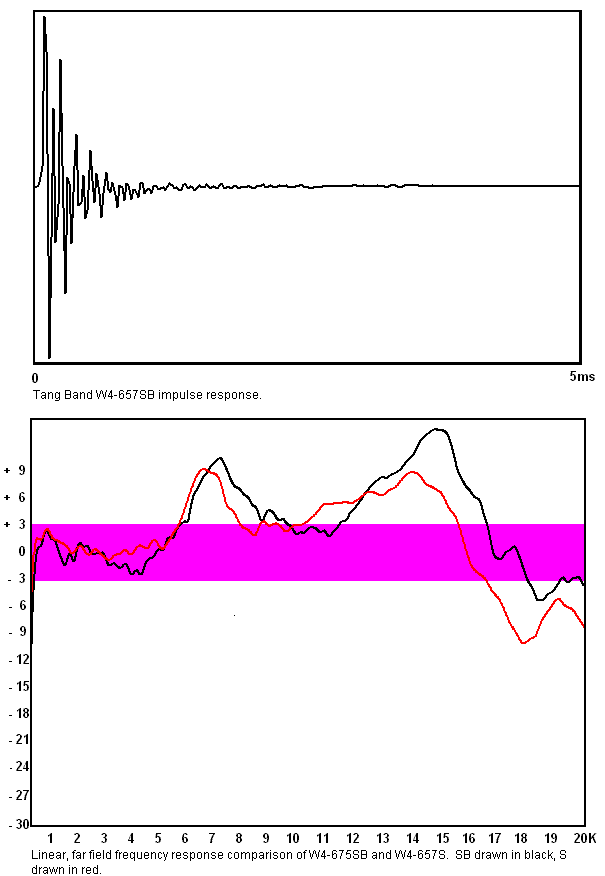

First, as to my now old posts, I was just using your raw data. I used what is called a "rectangular" window. I started the window where shown in the impulse response graph and ended it just before the first room reflection. The first room reflection may have been the floor. The first room reflection had not high frequency information. Could be a rug on the floor.
In the response, a little of the first room reflection may be present. The little tail at the end of the step response graph may be the floor.
Now, I have acquired a new W4-657SB. It is different than the S. The basket is taller and to match everything up, the VC former is taller. There is now more former in front of the spider before joined to the cone.
I have attached a comparison of the 657S and SB to this post. The two drivers differ in degree and not in kind. The SB is a poorer performer, but every error is still matching up.
Notice spikes four and five on the SB. Like what was found in Dave's mlssa data.

There was an error in my posting of the IR and frequency response for the W4-657SB. I still had the passive equalizer from the 657S mod in the circuit. This bumped the high frequency output for the 657SB. My apologies.
I have attached a file to this message and the next showing the comparison performance of the stock 657S and stock 657SB.
The 4 dB increase in magnitude for the 7 kHz cone vibration mode is more than the previous modification design can handle. So a new design would be needed for the 657SB. Also, I do not know what additional changes might appear in the 657SC (listed as a new transducer on the TB Web site). PE is still shipping the 657SB.
The fluidity of the offerings from TB is disturbing. I had offered several free modification designs for TB transducers. I did this to help amateurs who might not want to spend the big bucks necessary for quality performance in a stock unit. Many of the designs I offered have been invalidated by the worsening of the performance in the updated designs. To date, I have not measured a Tang Band updated transducer that was not a poorer performer than its predecessor.
I do not have a problem with this. TB changes the model number when they change the transducer. As long as diyers carefully watch the model numbers, they will not have a problem. You must not, however, assume that a revised model is the same as or better than the old model. To date, this has not proven to be the case.
Anyway, I hope interested parties will find the comparison graphs useful or at least entertaining. If you have an opinion on what a 3D waterfall graph should show, let me know. Waterfall graphs are not used all that often and I find them more useful for design level analysis than A/B comparison of transducers.

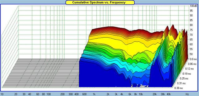

MarkMcK said:Attached to this message is the second part of the file containing the linear frequency response comparison and the waterfall plot for the 657S and 657SB
Lots of drivers seem to have this canel shaped response at the top. Which is an interesting thing to investigate.
Golly, 4" are really not much larger than 3" ones, yet they seem to decay lots slower. I wonder whether this has to do with the motor strength?
The "canal" shape to the high end is caused by two vibration (or breakup) modes of the cone. They are at different frequencies and start at different regions on the cone. Yes, it is common but never identical.
The waterfall plot shows many things. At the low end you are seeing the effects of Fs. At higher frequencies you see mostly cone artifacts. Motor differences will have little impact.
Mark
Mark
