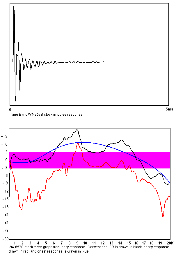

I have attached a gif of my measurements. These are far field measurements off of an infinite baffle (the term applies both to the baffle dimensions and the complete separation of the backwave from the test environment).
The response is typical of a metal diaphragm. Lots of undesireable vibration modes of high Q. There is also an edge hole/surround problem below 1 kHz. It is barely visible in the stock response because the mid treble diaphragm vibration modes swamp the response down to 1 kHz. When you control for the mid treble vibration modes (whether mechanically or electrically with a notch filter) the edge hole/surround problem becomes visible. As a result, a surround modification is required in addition to the cone modification.
The onset response shows that the mass and VC inductance are just too high for 20 kHz response. Yet with just a simple two component passive equalizer I can get the on-axis frequency response out to 20 kHz. This equalizer is providing a high frequency boost. Yet doing so will make the impulse response (greatly improved by the cone and surround modification) worse. Yet the transient misbehaviors are isolated to frequencies above 13 kHz and so are not as audible as they might be at lower frequencies. Part of the problem is enhancing yet another vibration mode with a center frequency just below 20 kHz.
I would judge the modification to be of moderate difficulty. It requires some mechanical skill and a steady hand. The cone modification can be done from the underside (with increasing difficultly). The basket has very narrow supports and thus allows better than average access to the underside of the cone.
The metal diaphragm is fairly robust. With care, the modification is removable without damaging the cone or surround. Should you mess up in application, you should be able to start over. Still, as with all mechanical modifications, it has to be a proceed at your own risk.
In sum, if you were going to try to redesign a metal diaphragmed transducer, this is a good one to choose.
But all of this modification stuff is for later. For now, it is just about the stock performance under standard and comparable conditions.

I remember now, seeing your measure when I first started playing with the driver.
Rest assured, what you see in my plots is what I got. These are properly taken quasi anechoic measures, via MLSSA/B&K windowed rectangular to maintain resolution. Trust me, they're good. Looks like the QC on these drivers may be a bit wild, yours and mine look like different drivers in some respects.

The only concern with differences in measurement is what they may mean for a modification. I am not criticizing your measurements. If there is a wide range of performance differences amongst stock units, then it becomes impossible to predict what you may get whether you stay with stock or with a modified unit. I do agree with you that there is little correspondence between your postings and my postings. (And my versions in stock condition have the midrange compressed bright sound consistent with the measured rise in output.)
So, one avenue of investigation is to ask that others test and post. Can we cobble together data on more units?
Also, equalization is just an option. The question is whether the end performance of a crossover or equalized top end is better (or less crummy). Because I do worry about transient response, my choice would be to equalize rather than crossover to a tweeter. Regardless, I have documented in fine resolution the crumminess of equalization.
