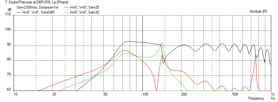

Sim of IG's W4-1320SIF DBR
Using the dimensions provided by IG, here is the sim in AkAbak with the speakers far from a back wall (60 in) and measurements at 1 m and 1 watt. The bass extension and location of the 150 Hz is quite close. The oscillations would be damped in reality but I have no way to model the damping.
Not bad! Thanks for doing this.

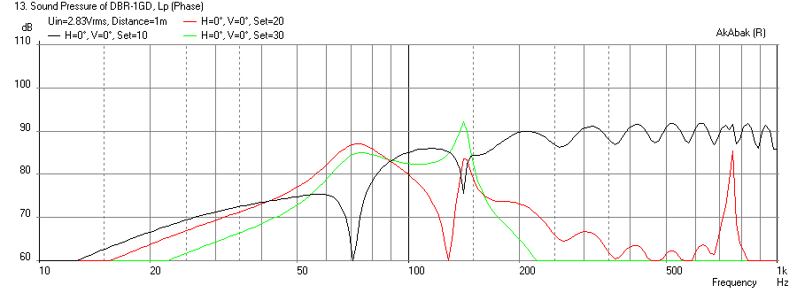

Here are very nearfield measurements to try and isolate cone output, vent1 output and vent2 output.
Blue: cone
Red: vent1 (top)
Green: vent2 (bottom)
Very close indeed, right down to the 750Hz peak on the red trace, which I assume is the 9" half-wave resonant mode of the main chamber.

A notable difference is the tuning of the main chamber; I measure ~60Hz compared to your model's ~70Hz.

The simulation turned out better than I expected. AkAbak works pretty well. Here is the plot for the output from: cone, vent1, and vent2.
Very compelling comparison of simulation v measurement.
