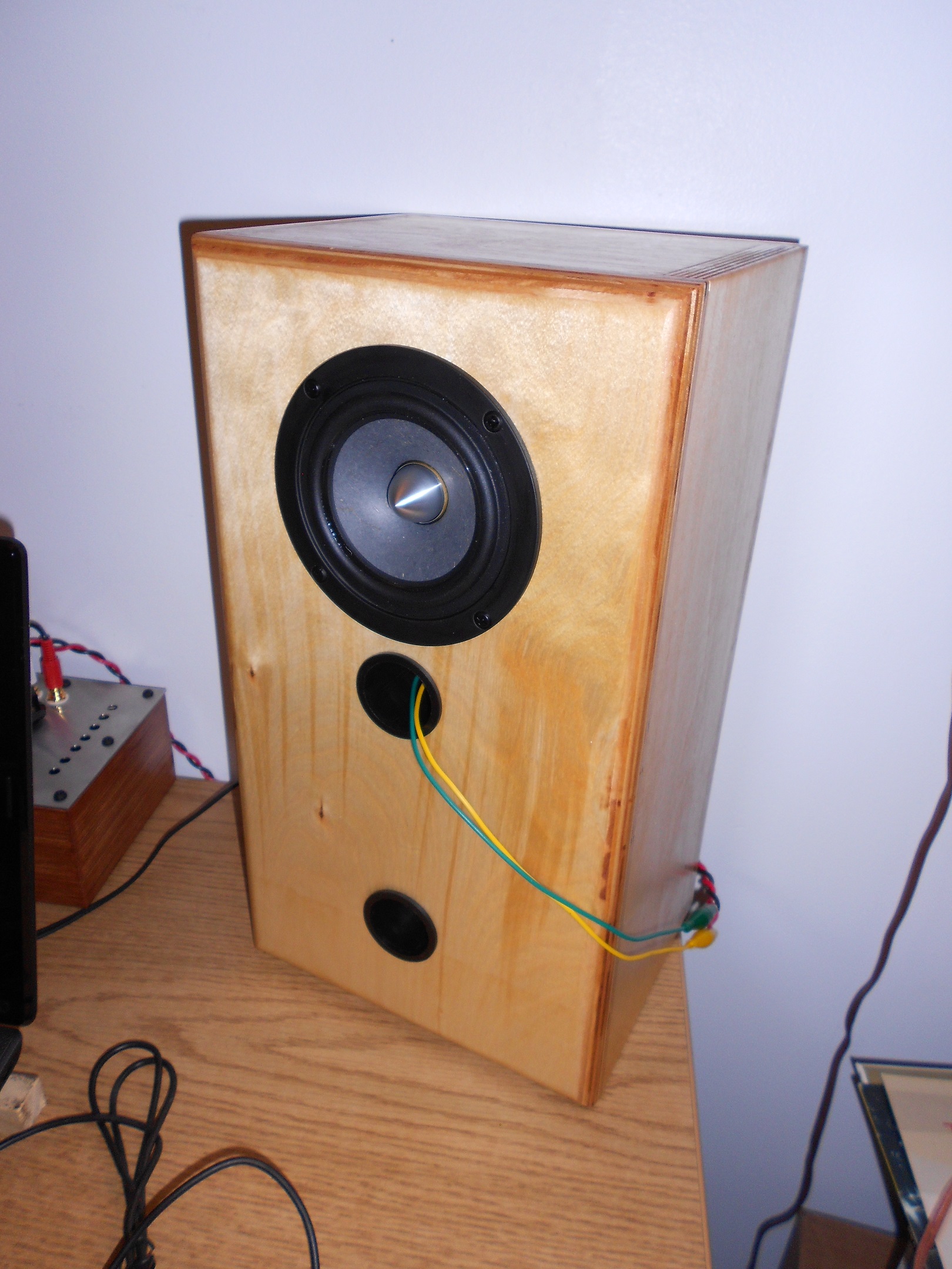

Here are some small-ish desktop speakers I built for use with my laptop. The driver is the Tang Band W4-1320SIF 4" Bamboo cone fullrange. I decided on a DBR for the enclosure as I never heard one before and don't see many folks building these. I used a technique that I believe is originally from George Augspurger and is found in a Weems book. It's pretty much what is detailed over on this webpage. There already was a DBR project online, called the Bandit, but I went for somewhat larger dimensions in my build. I still wanted to know how such a bass alignment might turn out, so I simulated in this very neat online simulator that is very flexible. I know of no other software that lets your do DBR, other than making your own in Akabak. Hornresp can do Fostex-style DBR though, but the Augspurger/Weems method gave better results in simulation.

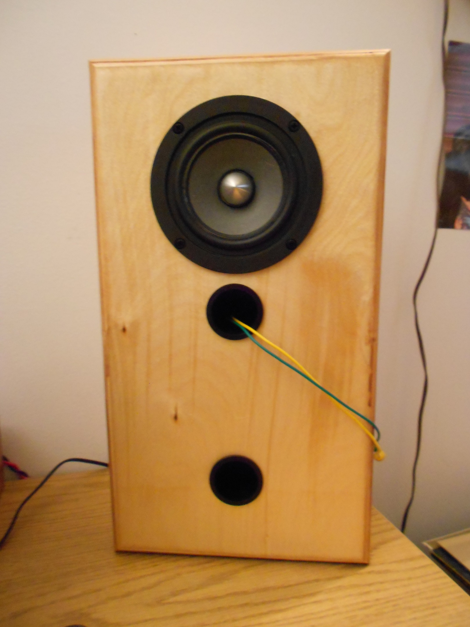

The larger chamber is ~6L and the smaller one ~3L. The external tunings are ~70Hz and ~140Hz. I'll measure the actual frequencies soon. External dimensions are 15.75" high, 8.5" wide and 7.25" deep.
It's not final, as I still need to make gaskets for the drivers and glue the vents proper if they don't need further tweaking. I also have yet to add any lining material to the driver chamber. No binding posts yet even, hence the gator clip wires coming out the vents. I was itching to listen to these. smile
They can do some useful bass, pretty much what I was expecting from the simulation. Midrange is quite clear, but seems a hair recessed since I'm used to the Fostex FF125K on which it actually was prominent. Highs seem well extended on-axis, but you quickly lose them when moving a bit off-axis. There is a bit of brightness that I'll for now attribute to the ~7kHz peak we see in the FR. It's not too aggressive and I can bare it, I'll see what happens with break-in. No real need for BSC with such a placement IMO. I've played various tracks covering a wide range of genres I listen to and they did well on pretty much everything. Even some Devin Townsend (Canadian heavy-metal dude with a wall-of-sound approach to mixing/mastering) sounded good, though I would not drive them too hard with that stuff. They have a headphone-like quality. Driver centers are 12" off the desktop, whereas the FF125K boxes had it around 8", a definite improvement.

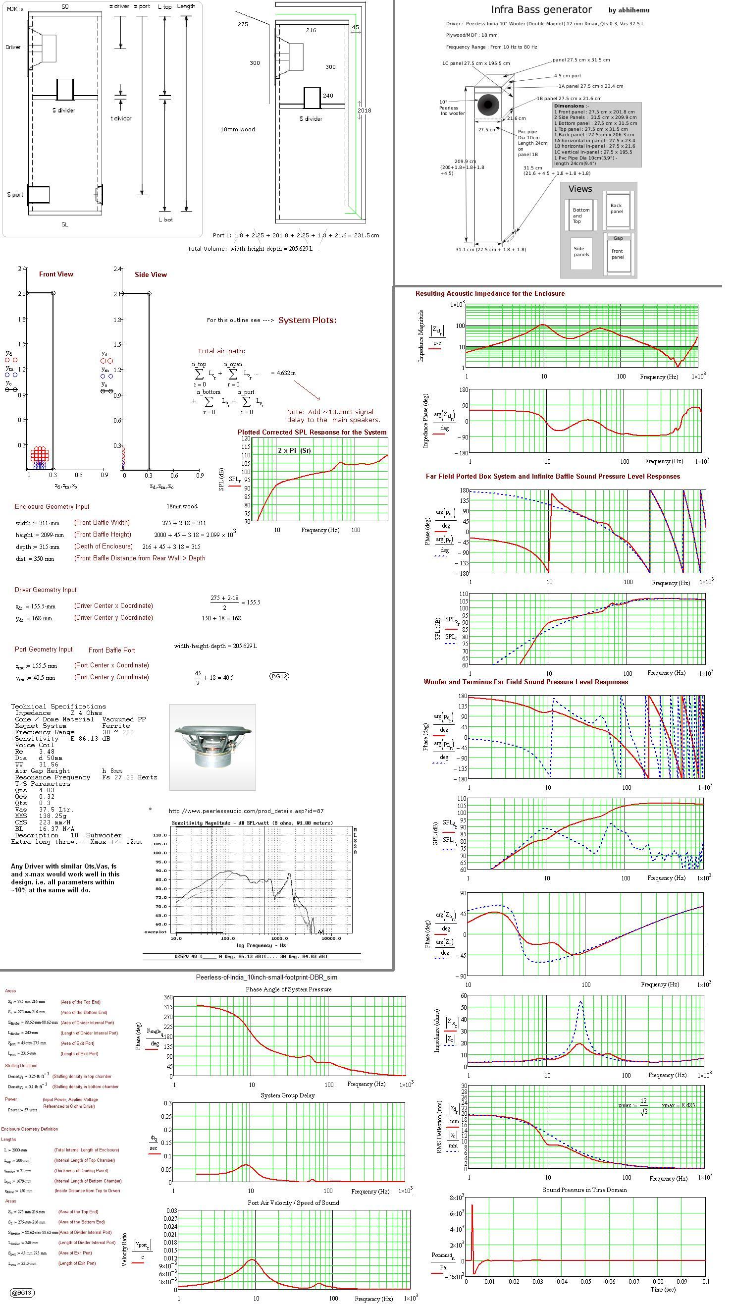

FYI: The upper Bass notch can be avoided/suppressed if a DBR dimensions are elongated in order to form a quarter wave design instead of a normal chubby BR type.
See an example of an Quarter-wave infra DBR design located in the : Graham-Holliman thread:
http://www.diyaudio.com/forums/subw...oupled-infra-bass-speaker-31.html#post2879125

That notch will often be located high enough that a mass-loaded QW chamber won't need to be too long, good tip!
In my case, it's very narrow and only a few dB's deep. Look at the simulation versus measured response:
IG

Internal width is 7.25", depth is 5.75". The top chamber is 9" high, bottom chamber 4.5" high. All three vents are 1.375" in diameter and 4" long.
