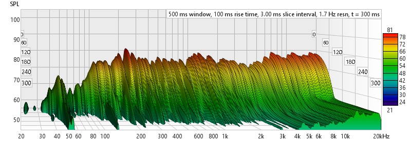

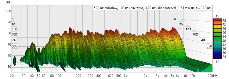

@wolf_teeth fair. I found that spectral decay is the best on axis (essentially has no bumps) but increases off axis. And your tweeter is different, so it may not even have the dip at 10k. So it's the tradeoff between spectral decay and tweeter diffraction on edges with woofer.
This is waterfall on axis. This W6 speaker is really good.
And this is 8 degrees, you can see it gets worse but not much. It gets a bit worse with every step beyond 8, so perhaps 8 degrees area is the compromise with diffraction.
