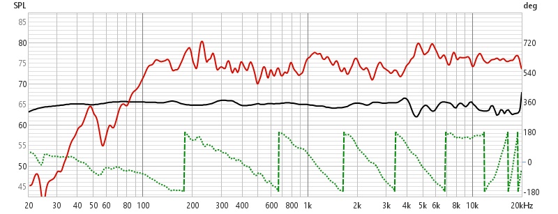

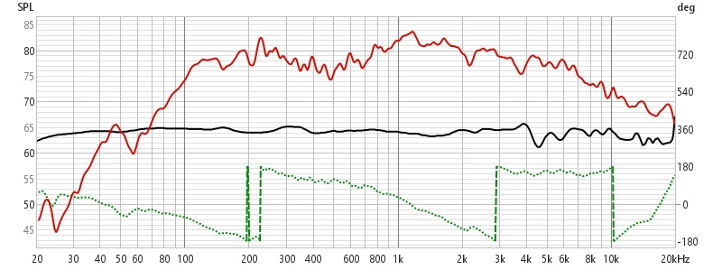

Finished XO from post 191 except the tweeter is inverted. Here each driver separately and all together, measured at the actual listening position from a pic two pages ago.

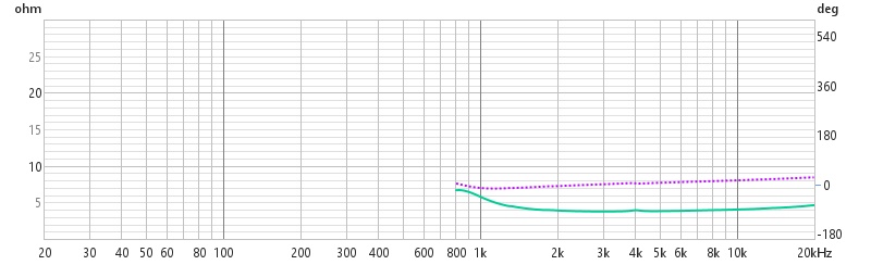

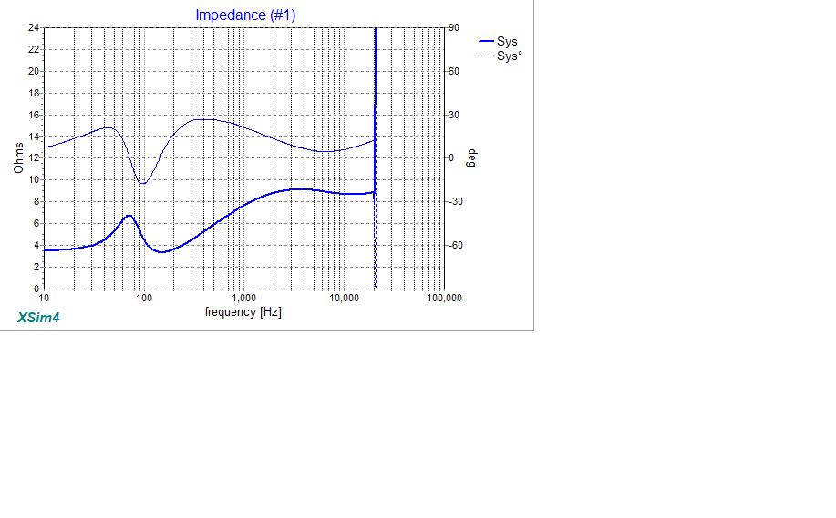

I've used 18 gauge inductors in the woofer, and there are 2 of them serially. I think if one day I change them to 14 gauge. My current DCR is 0.5 Ohm + 0.22 Ohm. Theoretically I can move them to 0.25 + 0.11 Ohm. I am not sure what is the exact formula in Db gain is, if the impedance of the driver itself in the target area is 8 ohm, so the effect is about 5% reduction of the impedance. I am not sure adding resistance to the tweeter is sonically identical way. My Aegir amp kinda prefers sub-8 ohm load.

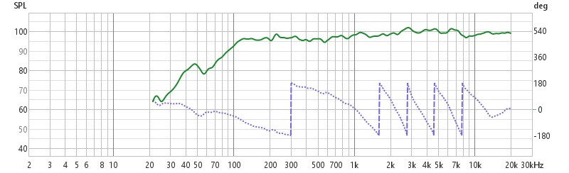

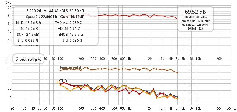

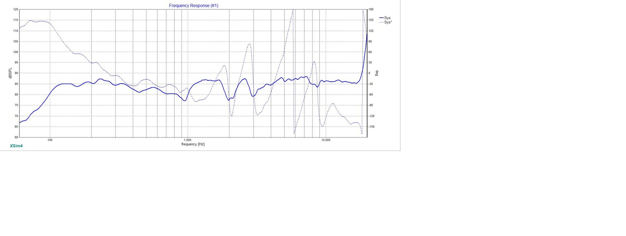

Here I measured only the woofer with low pass distortion using stepped sin 3 measurements per octave. I don't think it has any distortion on the sin wave. I am not sure if I can measure anything but sin with a microphone, perhaps an oscilloscope is needed for the square wave?
More comfortable explanation is that the fatigue is coming from the elevated 1k-8k level you can see in the post 443. I can try to keep the crossover frequncy the same but just push the curve 5 db down.
I'm happy you tried to measure if there are indeed distortion area, not just guessing.
My pair is distortion free through the range.
And yes, I already mentioned your curve is too hot.
Try to get the XO to follow my red line instead and you will have zero ear fatigue while still preserving details.

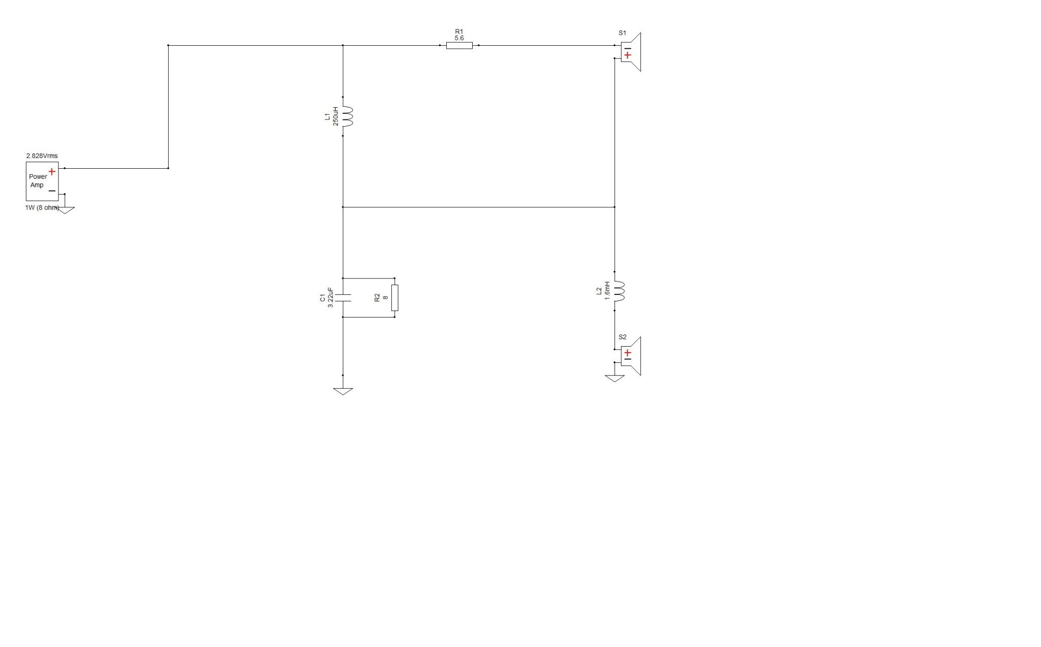

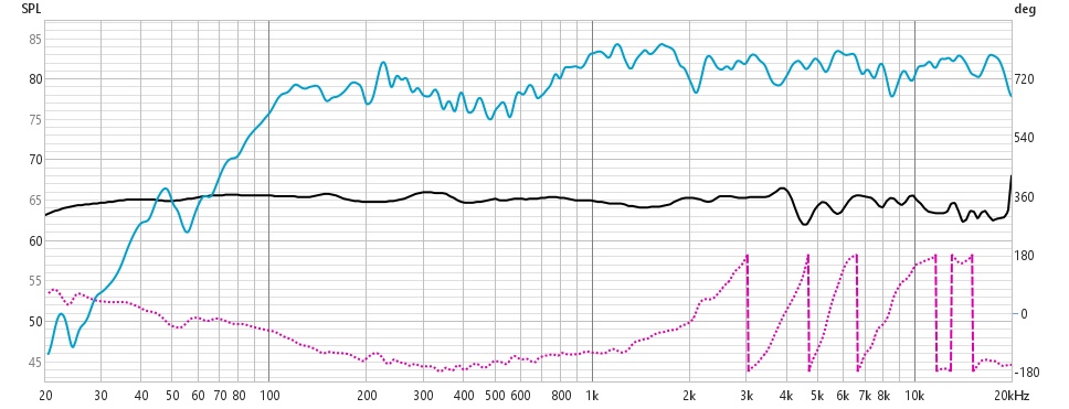

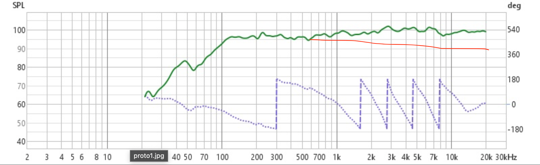

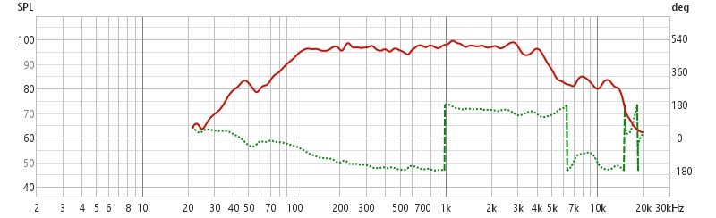

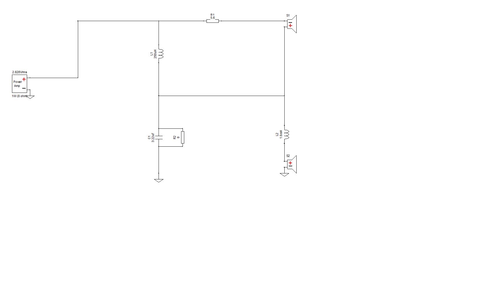

I was not totally happy with the crossover above and decided to finally try the clever @perceval serial, based on #430 but slightly tuned. This is how it models:
And this is how it really measures:
The quality is indeed better than the classic crossover, I've got very detailed, accurate sound, nice soundstage. I finally have better confidence that this could be an end of road driver.
However as you see the response curve is very incorrect and for now I'm lacking skills to fix it. I was swapping some spare parts and this is the best I've got so far, which is quite pathetic. I had a similar problem with previous XO, the woofer just can't get to the same loudness. Need some brain...

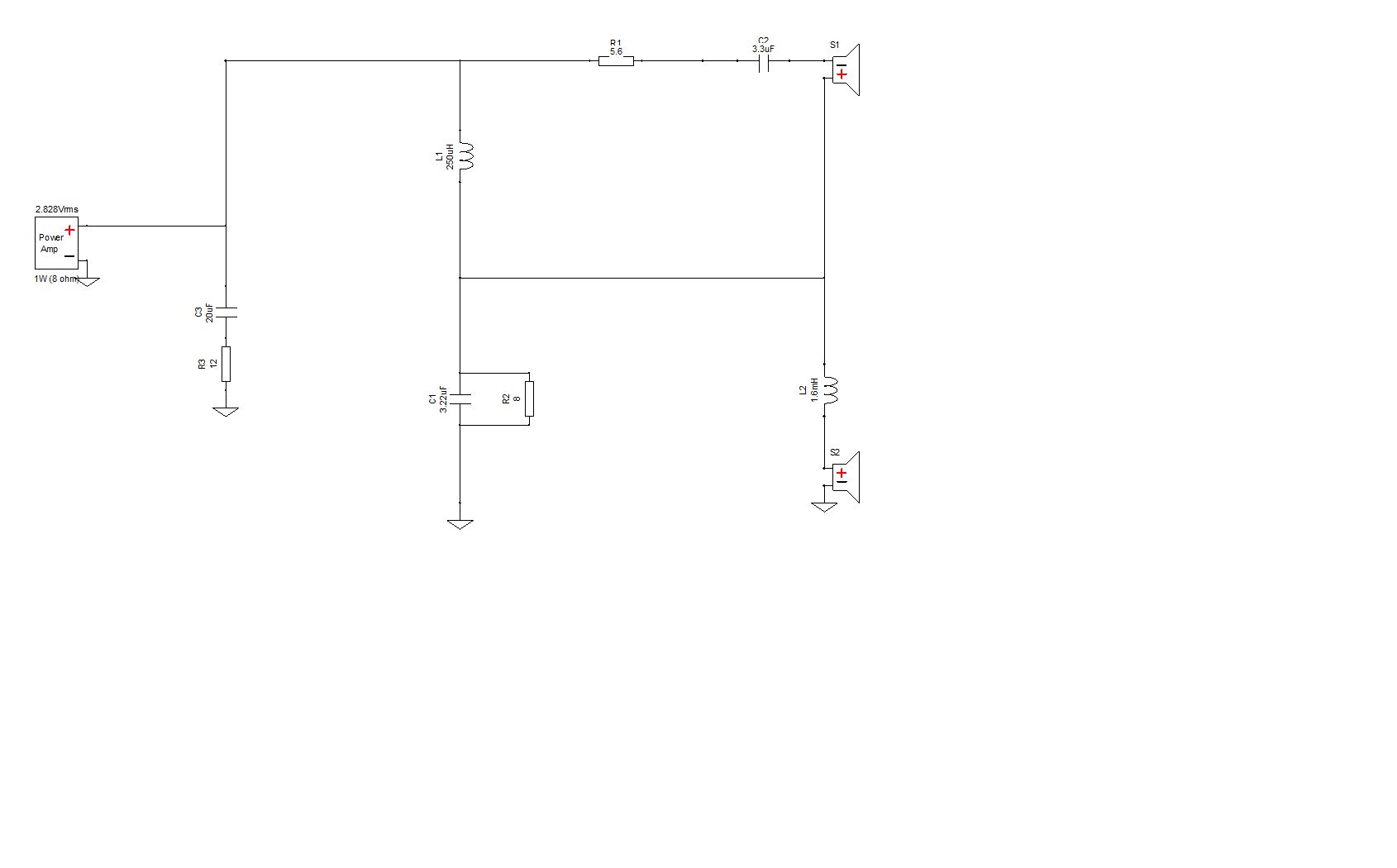

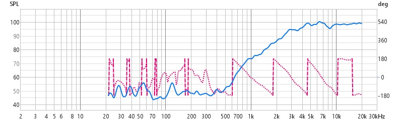

@perceval your original circuit is dangerous because it makes the tweeter to play down to 1 khz. I've added a capacitor to bend it down below 3.5 khz. Also added an impedance reduction chain.
Now there is a distortion jump in the 6 khz area, I suspect this will be fatiguing, only just started to listen. The sound is pretty good but of course too bright, don't know how to fix it yet.

The concern is that whatever I do the tweeter is much, much louder than the woofer, in any xo variant. And with 454 variant I've got a significant distortion at 6 kHz. 453 no distortion but the whole tweeter area is much louder.

Just had a look at post #430 and your XO.
You changed the values of many components, and your measurements differ from mine quite a bit. I'm not saying it's a bad thing, it's ok to experiment, but we have different output, that's for sure.
The tweeter should be at -15dBs around 1kHz, which should be fine for most applications. This is not a driver intended to play techno music at a dance hall in the wee hours of the morning! 🙂
Hi Perceval! Of course I've started with your XO almost exactly with the parts I had, I saved the measurements (attached) and moved interactively changing 1 component at a time. The box difference, placement difference, huge flat monitor in between, only 1.5 ft from the wall. I presume each driver is different a bit. This is why we DIY, we can build the speaker for the actual location and not in the middle of a huge room with dome ceilings. And I am still working on the left speaker to perfection, the right one is months away...
