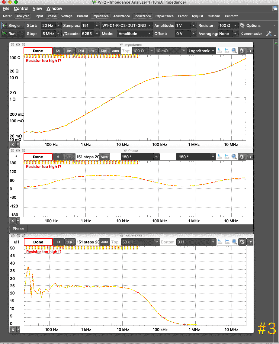

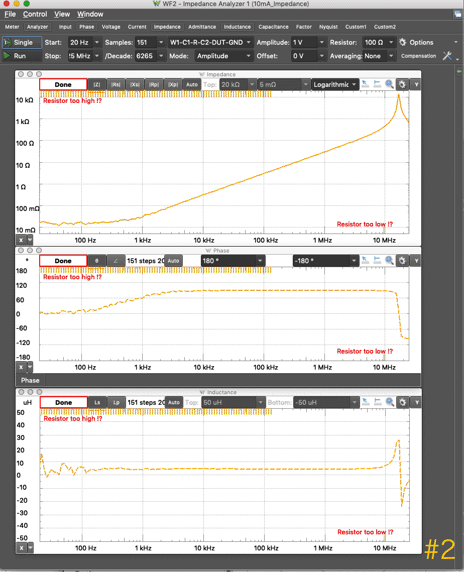

Hi chchyong89-San,
Good point!

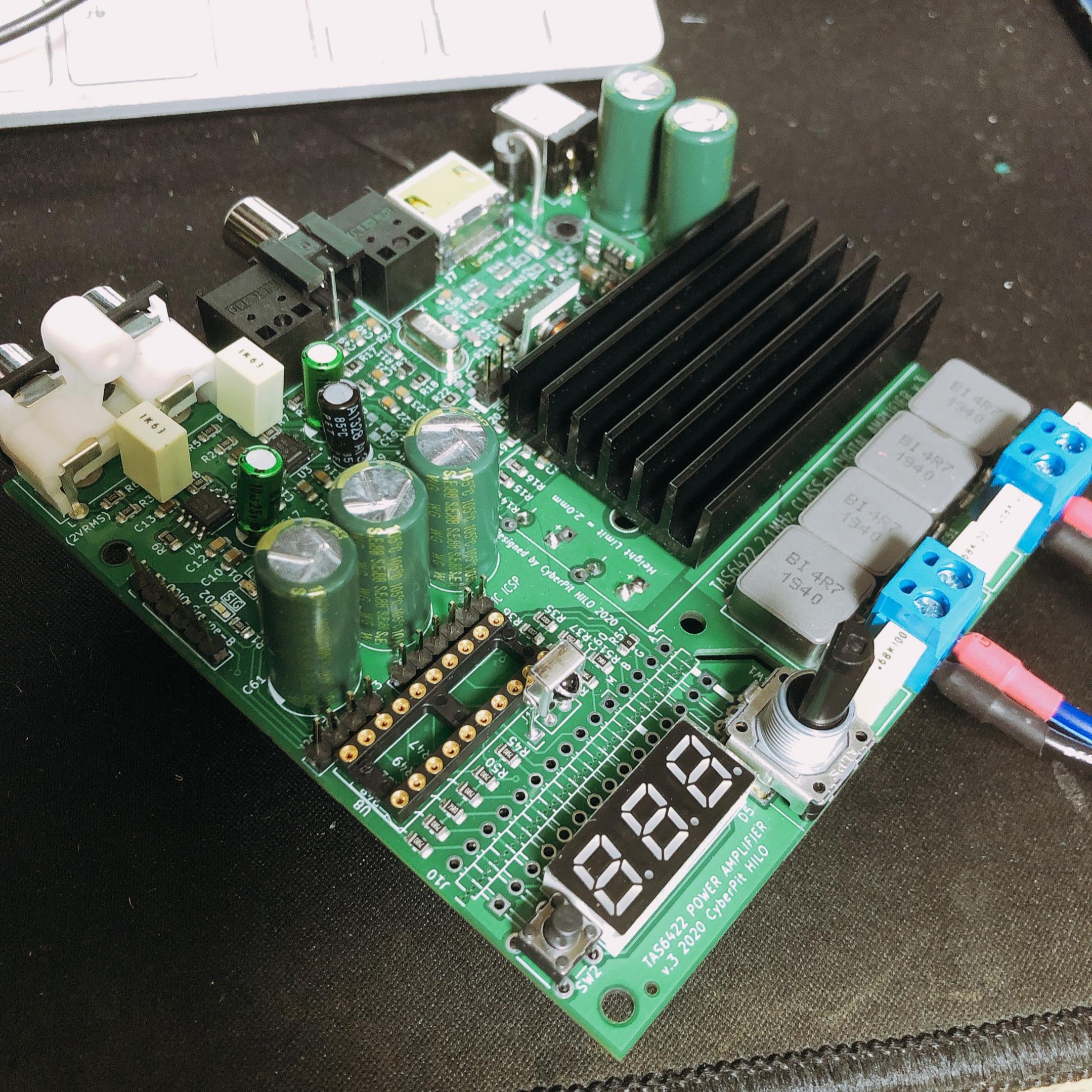

High frequency switching circuit requires good quality parts. This reconstruction filter is not in a feedback loop, so it might not be a important, but I had interested on my using inductors.
This ver.3 board picture uses #2 inductors.
My board has 2 various inductors for reconstruction filter.

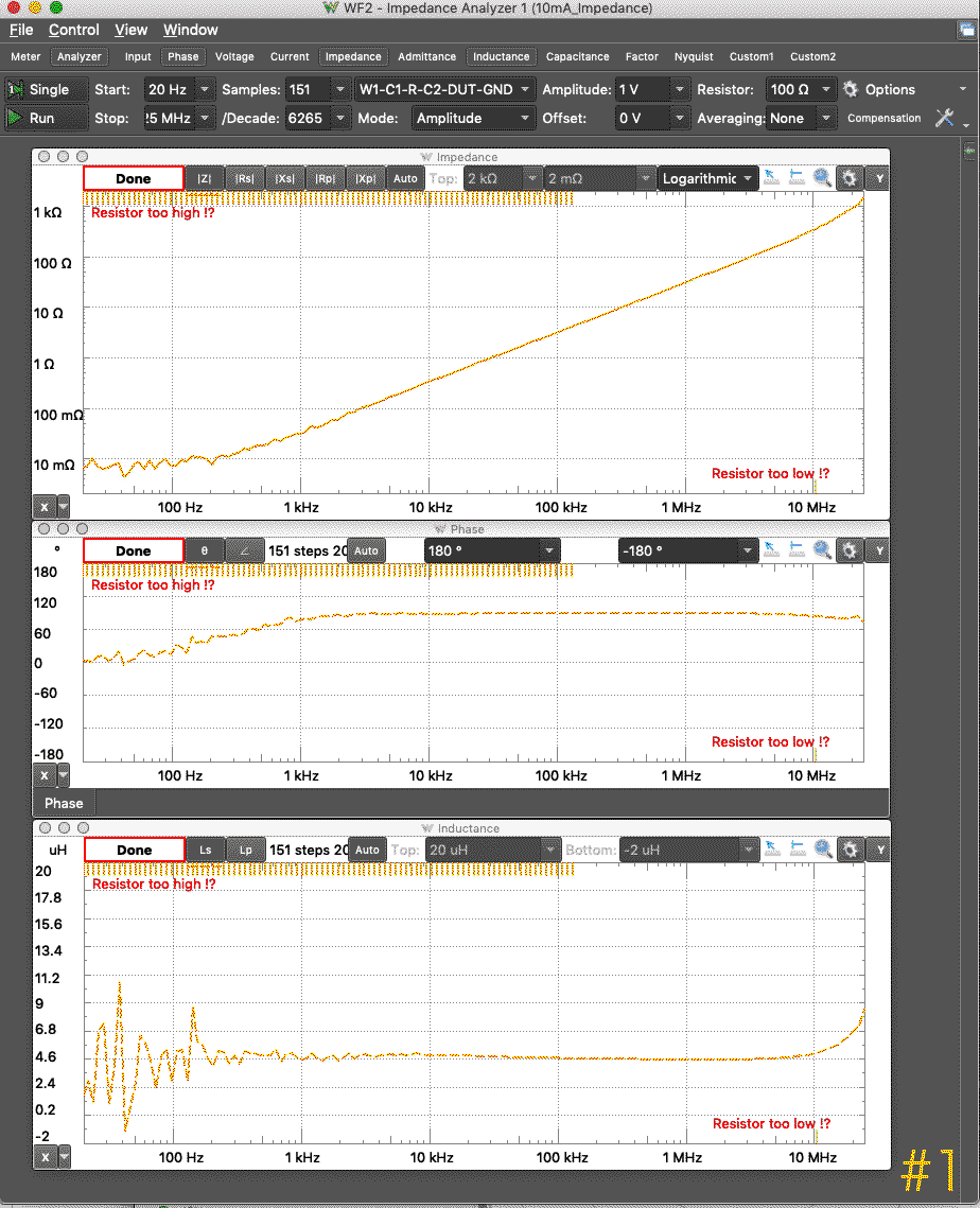

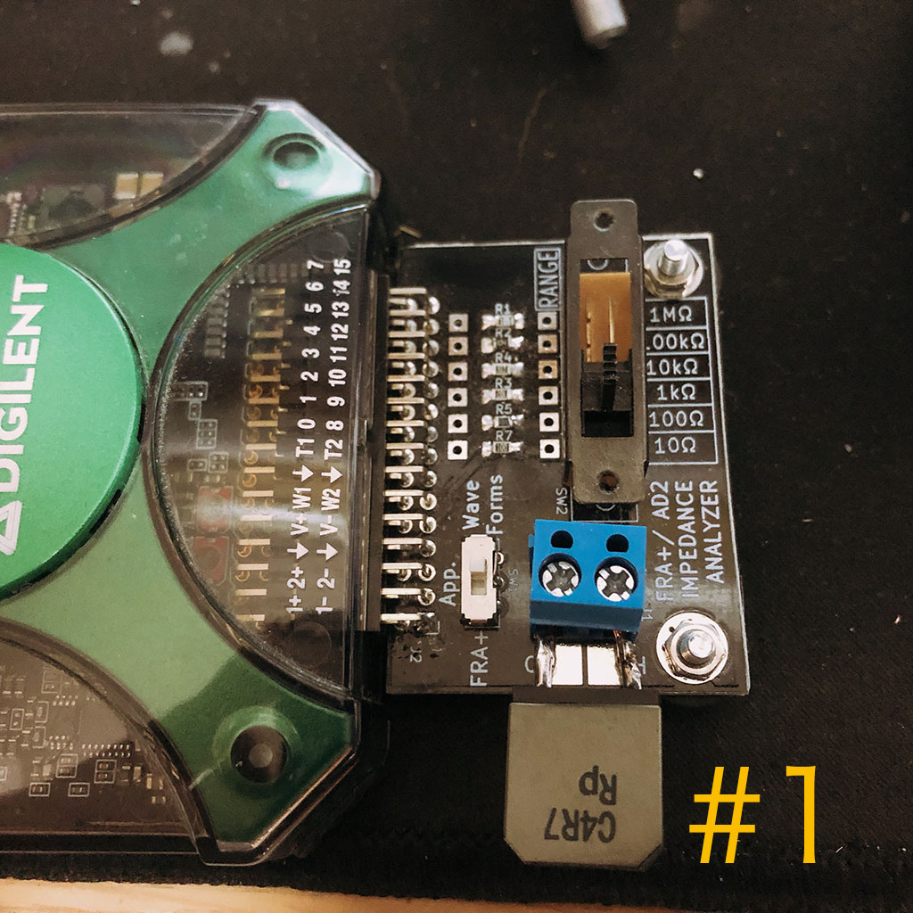

#1. Sagami-Elec 7G14C-4R7N-R (4.7uH, DCR=4.9mOhms, 20A max.)

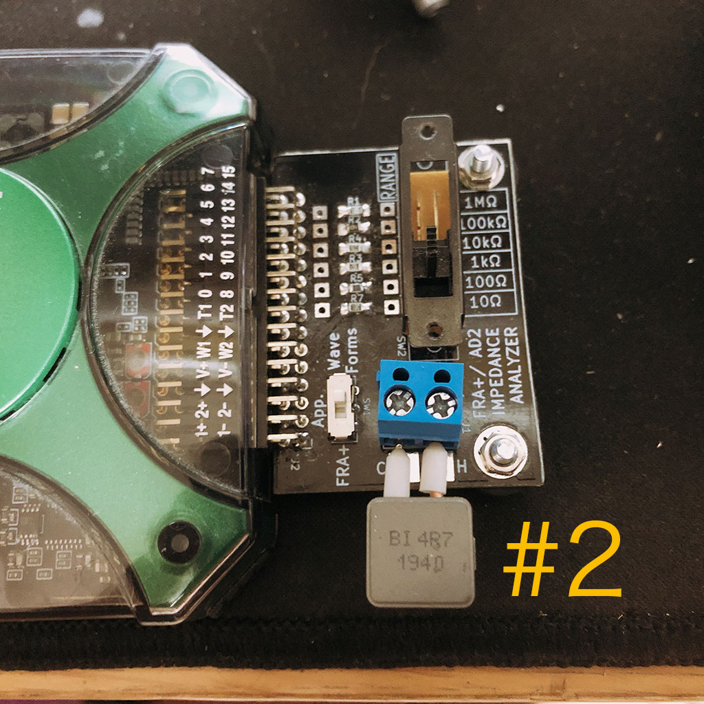

#2. TT Electronics HA72L-12654R7LFTR(4.7uH, DCR=11.2mOhms, 13.5A max.)
And I attached one very bad example which mounted on HX-M190

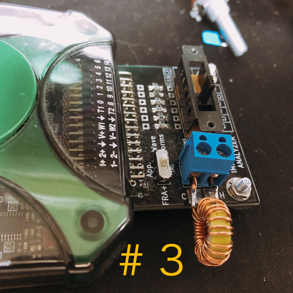

#3. burning-hot toroidal inductor removed form XH-M190 board.
According to the measured result #1 and #2 inductors are keeping inductive over 10MHz or more. So I think those are good enough for my 2.1MHz PWM amplifier. 😀
In other hand, #3 inductor is terrible quality part. As a result of this, XH-M190 has a burning-hot reconstruction filters.

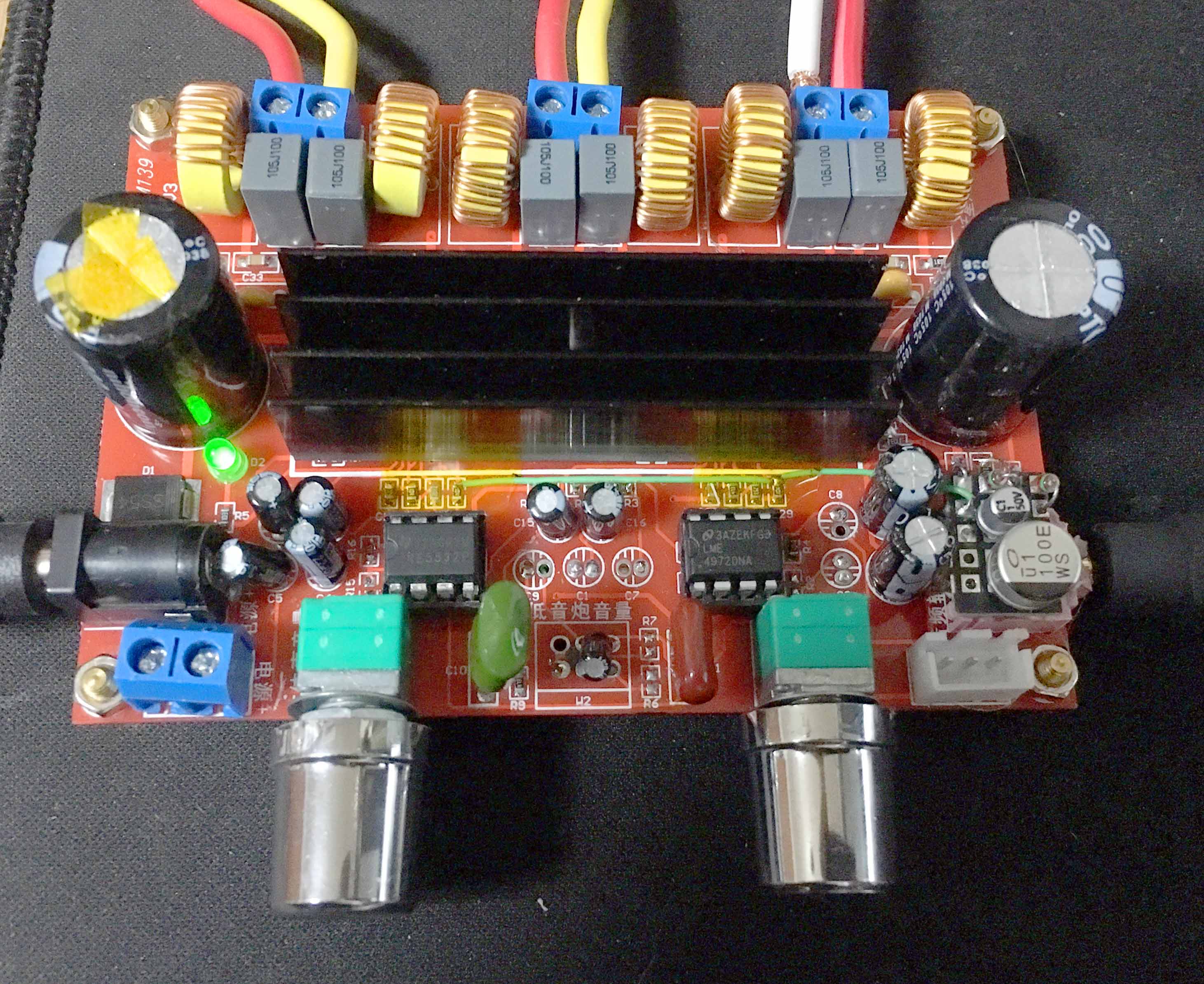

Model Name Wrong XH-M190 --> HX-M139
Sorry!!
I made mistake Model name of Burning-Hot #3 inductor was removed from XH-M139. (Not XH-M190)
A picture of "Burning-Hot" XH-M139(On the way of modification Snapshot)
