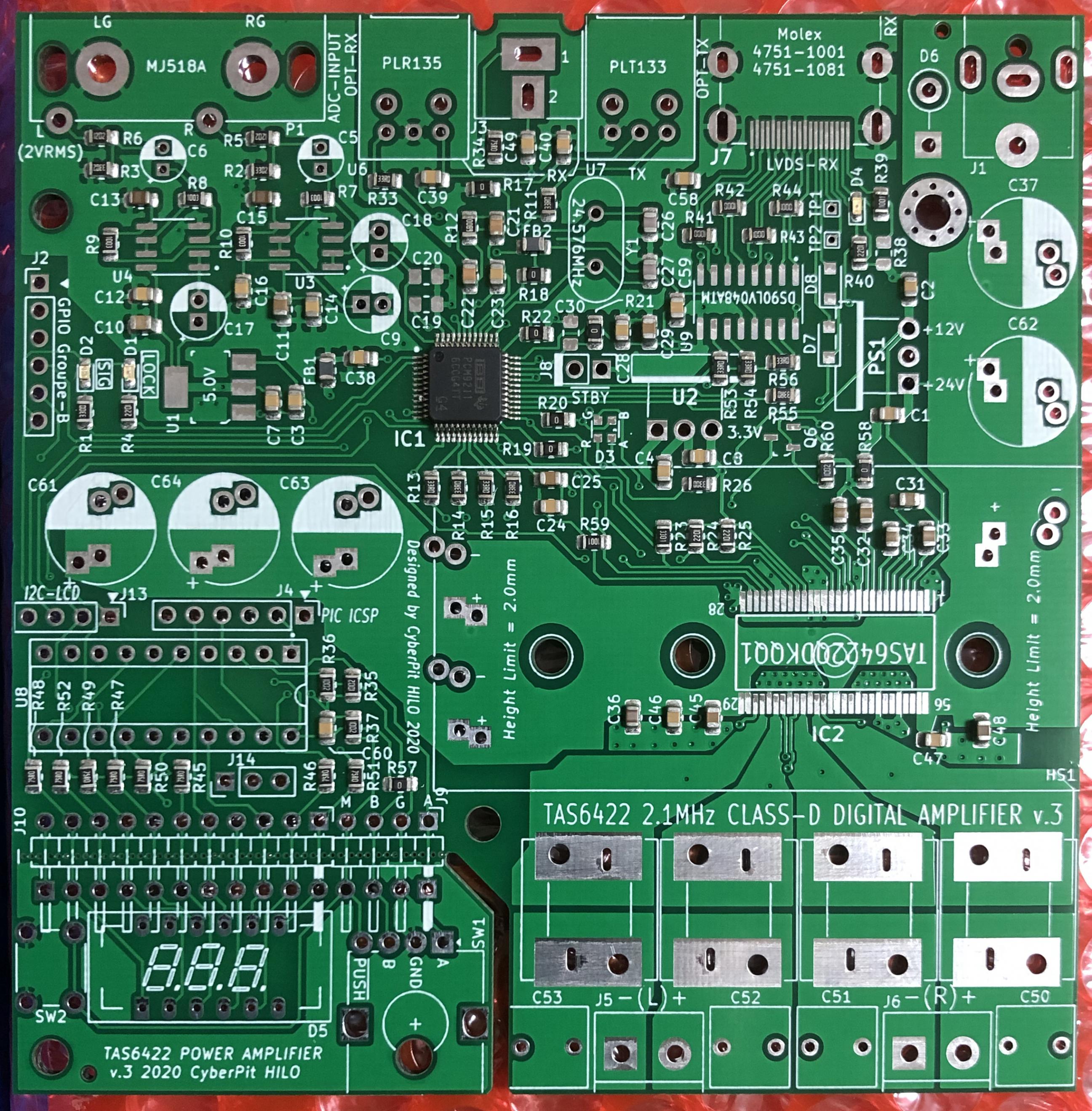

Hi chchyong89-San,
Good point!

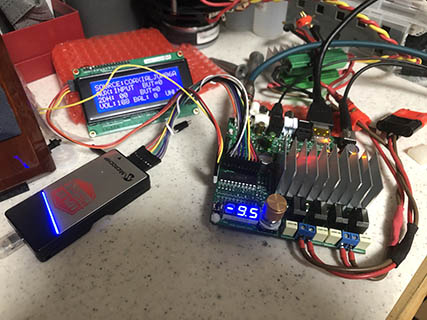

High frequency switching circuit requires good quality parts. This reconstruction filter is not in a feedback loop, so it might not be a important, but I had interested on my using inductors.
This ver.3 board picture uses #2 inductors.
My board has 2 various inductors for reconstruction filter.
#1. Sagami-Elec 7G14C-4R7N-R (4.7uH, DCR=4.9mOhms, 20A max.)
#2. TT Electronics HA72L-12654R7LFTR(4.7uH, DCR=11.2mOhms, 13.5A max.)
And I attached one very bad example which mounted on HX-M190
#3. burning-hot toroidal inductor removed form XH-M190 board.
According to the measured result #1 and #2 inductors are keeping inductive over 10MHz or more. So I think those are good enough for my 2.1MHz PWM amplifier.
In other hand, #3 inductor is terrible quality part. As a result of this, XH-M190 has a burning-hot reconstruction filters.
