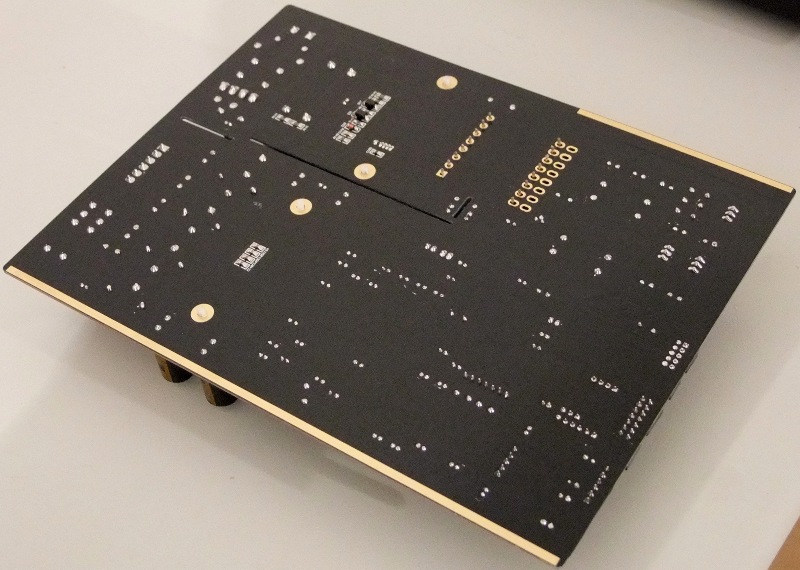

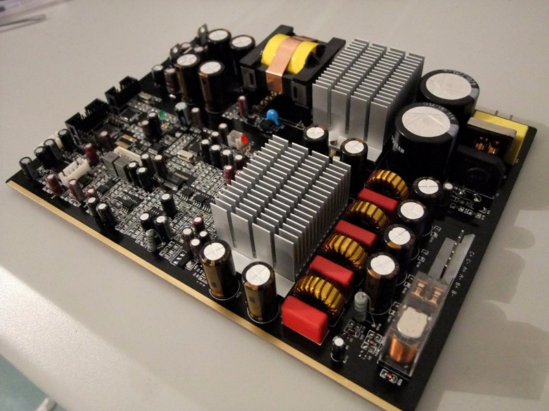

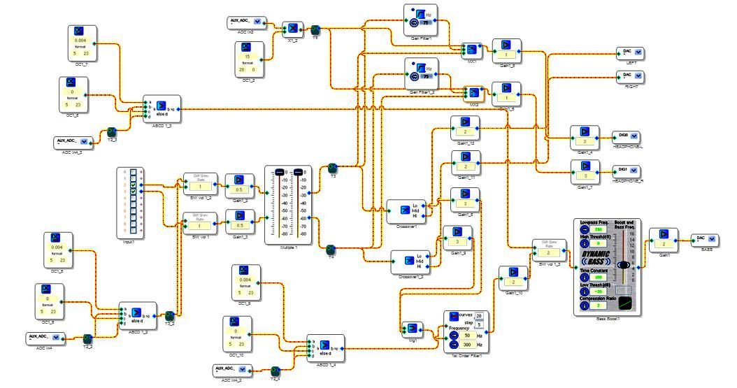

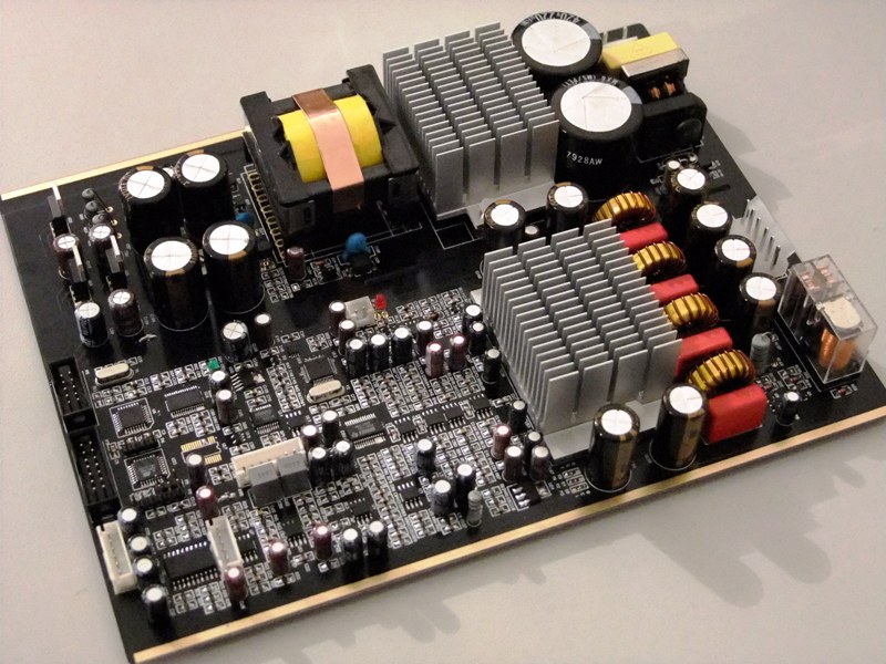

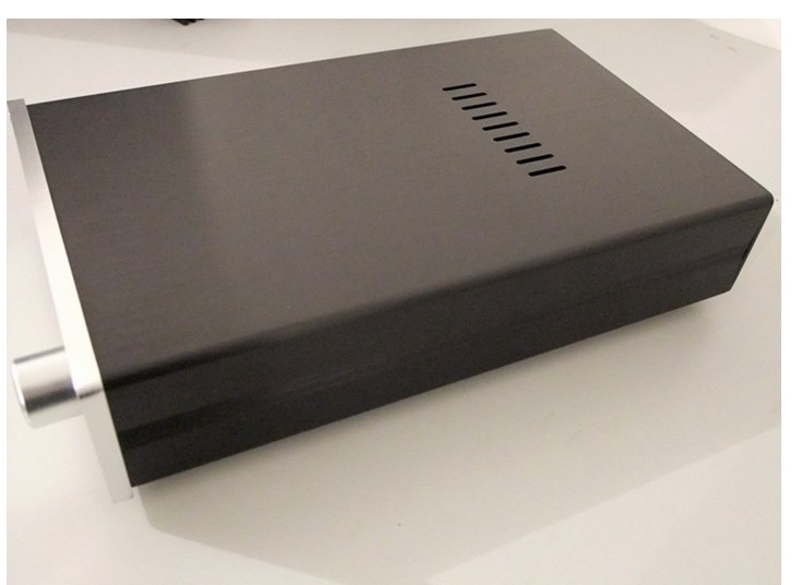

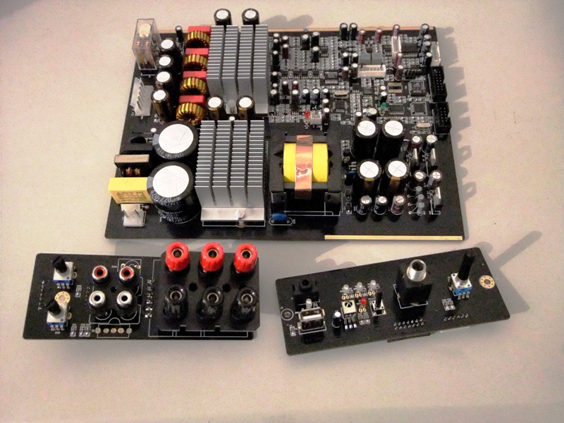

DSP+2.1AMP+SMPS BOARD FINISHED!!!
2.1amp board finished now,case is manufacturing now,I take some pic just ago,paste here,corresponding circuit have tested for a about 4 month,works stable and sound good.
SPDIF and USB and 2analog input,can be selected by remote or front panel key.subwoofer frequency and gain can be adjusted alone.
We have no plan to develop one new software for mcu controlling,due to Sigma software so good and all code are perfect with software,still no better software can exceed it now.Mcu only
discreteness control,we sure believe ADI forbid sell it DSP algorithm routine.
We fix all the curve and code when selling.of course customer can modify all the parameter by Sigma software through ADI USBI.
Features list:
Power supply: 90-265vac 50 or 60Hz
Sourece: Coxial Spdif/USB/2 analog
Output: 1x200W/4ohm(subwoofer)+2x50W/8ohm or 4ohm (stereo)
Low cut switch:70Hz(on/off switch on rear)
Sub Franquency: 50Hz-150Hz
Core chip:
DSP:ADAU1701
AMP:TAS5630
USB😛CM2707

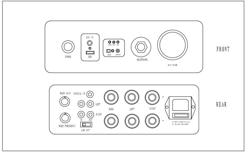

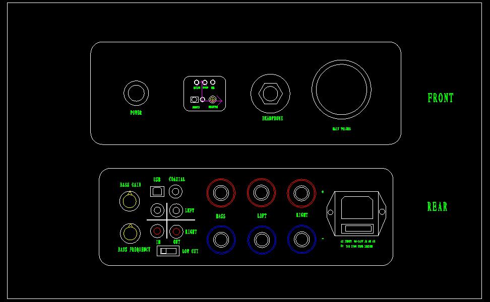

2.1AMP+DSP+SMPS
Front panel and rear panel planed drawing.case and panel are manufacturing now,if friends like pls mail us,(authlxl@gmail.com), we will arrange the delivery things and PI for you.
Front board+main board+rear board pic
Why is the USB connection at the front. Would the rear not be more practical? Otherwise a very nice product.
Thanks a lot ! very good suggestion,we will produce two version of it,one with rear USB,the other with FRONT USB.
Thanks again!
Very interested in amp with USB on rear. I will send you an email.

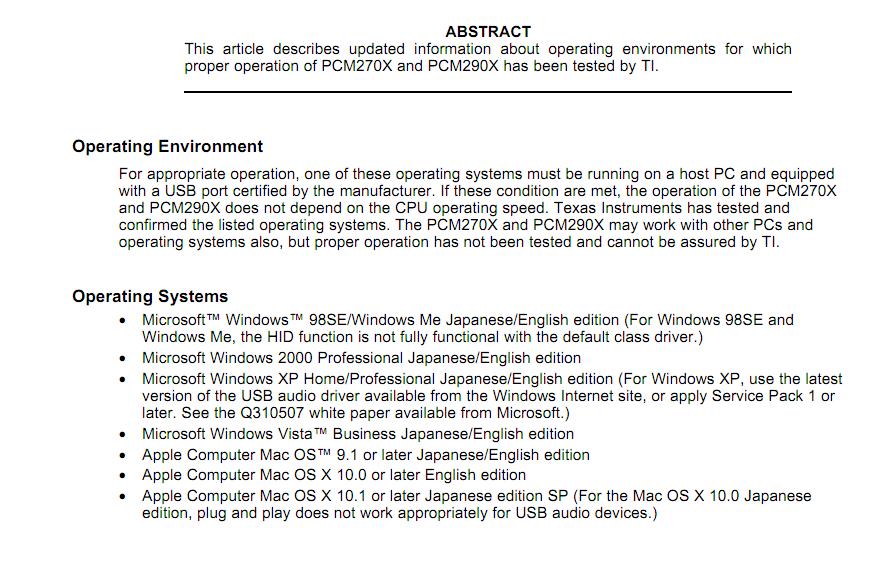

how can I get one?
and will the software for it run on a Mac?

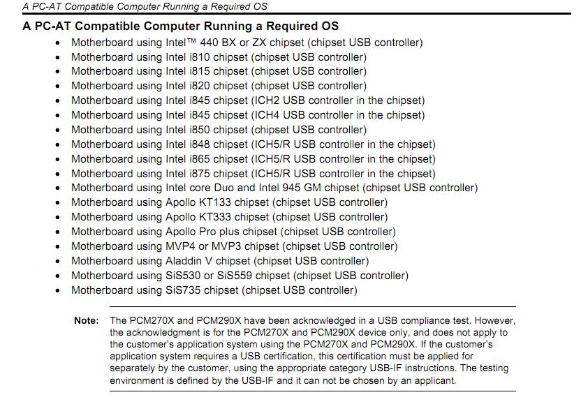

About USB audio Operating Environments pls reference the TI website note,it can applicate in most cases.
Updated Operating Environments for PCM270x, PCM290x Applications (PDF 40 KB)
http://www.ti.com/cn/litv/pdf/slaa374
