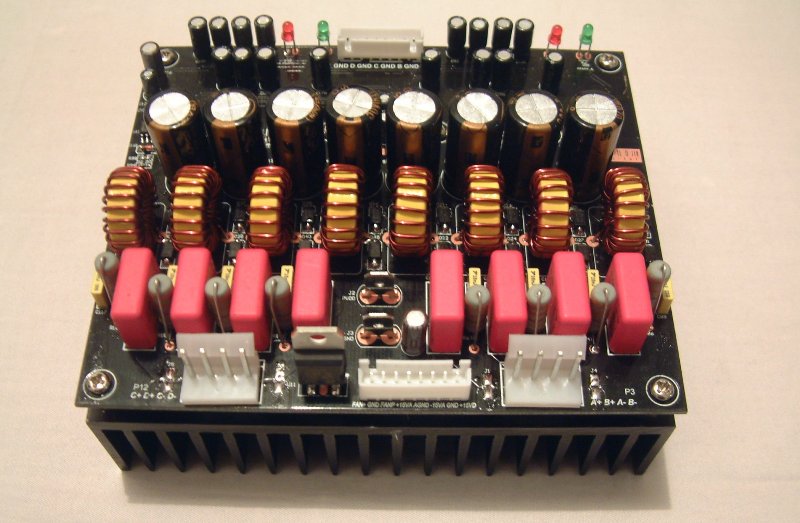

Maybe problem of us,we think tas5631 same as TAS5630,only add LC low pass on it,the core same as tas5630,we think tas5630 sound will better than tas5631,of course it is ourself idea,maybe problem.
Pwm DSP Tas3308 or other chip suit for tas5631,but if you use adau1701 or adau1702 as dsp and use tas5630 as amp,we think sound will better.
We are develop one system like sunshine request,now in debuggind,but HDMI have not add.

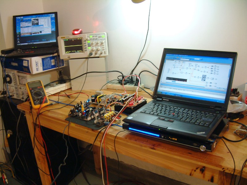

the amp module have two tas5630 chip,we revised the tas5630 recommand circuit,in this module it can works at full power continued
2X600W/2ohm or 4x300w/4ohm.
The dsp chip is adau1701,so much functions of it ,we have use it 4years,some functions have not skilled yet.
Send pic here

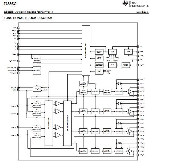

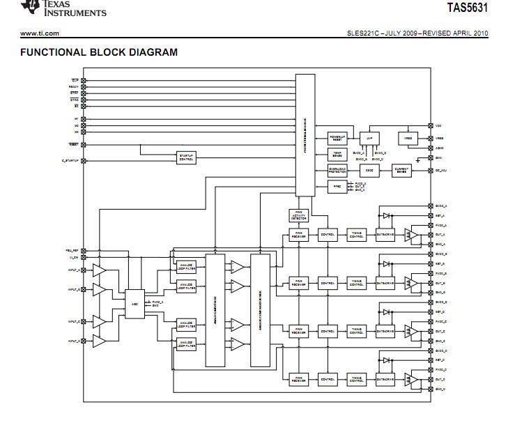

tas5631 & tas5630
two chip block comparison:
I Understand what you mean. Instead of finding a way to eliminate the analogue conversion TI just through another (substandard) converter on into the chain for those who want to come in digital first(??!) Not what we want at all! We want what Tact does with direct digital to the amp and then using only that (plus adjustable setting for volume control) to drive the amp output and making the amp the one and only D/A converter in the chain, not multiple conversions!

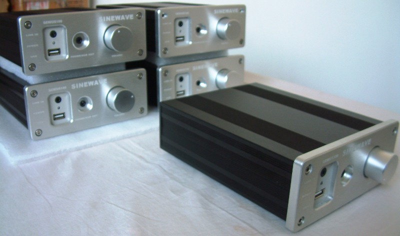

New product for audiophile,desk amp,stereo mode,2x100W G100 SERIES list.
Suit for desk amp or studio amp,sound good.
USB CHIP 😛CM2902B
AMP CHIP:TAS5613
SMPS:85-265VAC 50 OR 60HZ
Max Power:2x150W/4ohm
The 2.1 version will finish this month!2x50W+1x125w/4ohm rated power,max power 2x75w+1X150w/4ohm.
Have mass produce,pls give good advice.we will send 10PCS as gift for 10 excellent advice provider.

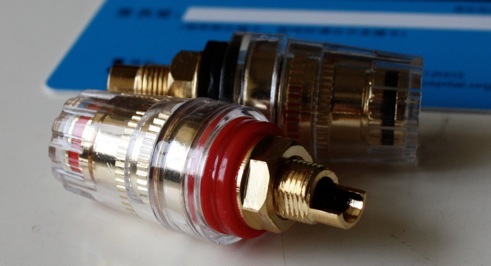

Maybe one last advice-the speaker terminals on the picture you have provided are the worst possible and in my opinion shouldn´t be on any quality audio product- they break easily (the springs inside), they have weak contact and they are almost impossible to use with some bigger diameter cable. I will strongly suggest to use something of higher quality-see attachment.
