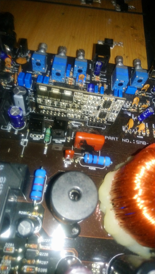

8 and 9v of drive for all FETs seems too high for those voltages. If one was 9v and the other much lower, I would think the duty cycle was far off of 50%. Re-check and repost the voltages for both banks with the load connected.
Its only the one bank that change voltage with a load attached and the other doesnt change at all
Ive taken the drivers out and checked them nothing wrong with them not leaking and its reading right. But why does the amp go into protection. Could it be because of the driver board
