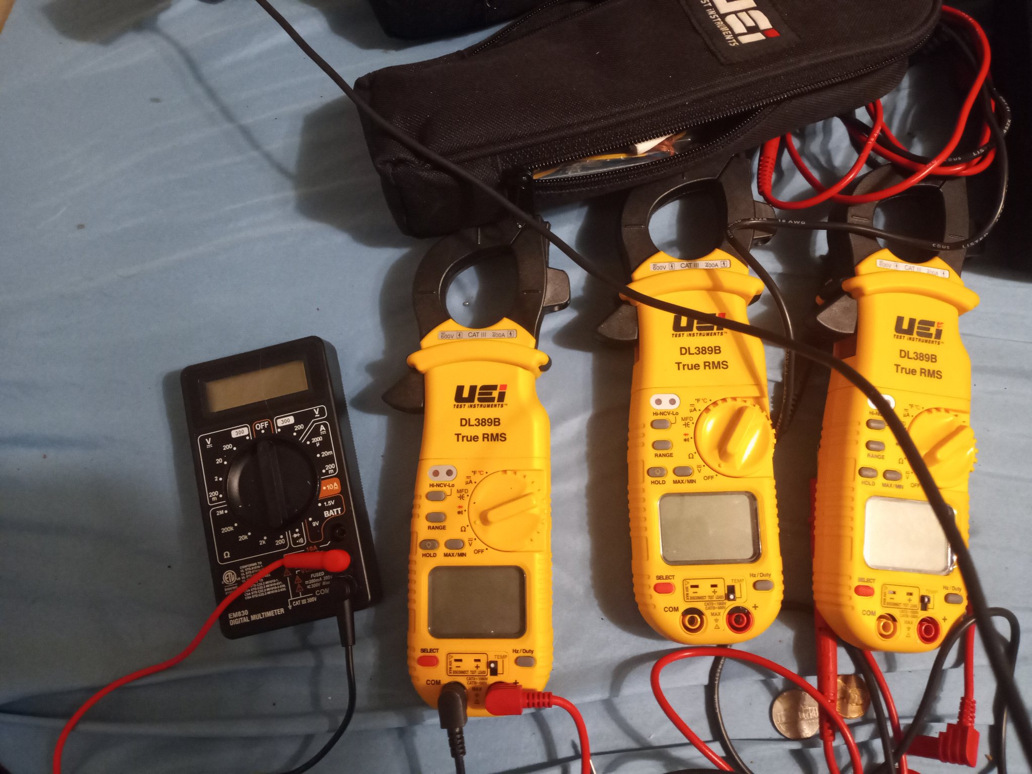

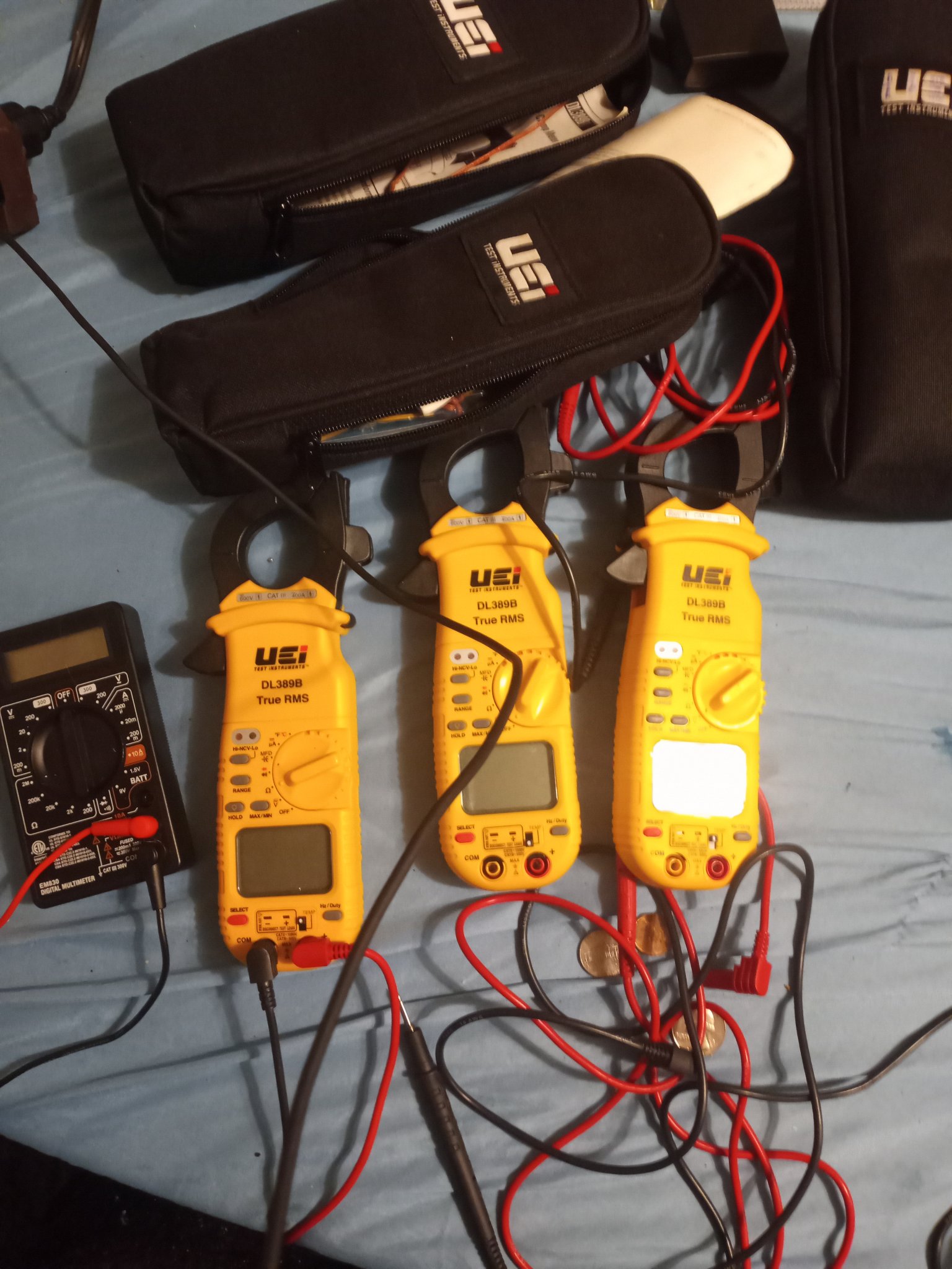

My nice ish meter is a ueidl389b
Commercial electric I never use it's a 20$ home depot cheapie digital ... I have an old analog laying around and I might have a klein in garage but the uei is my only decent meter
Find the manual for the Commercial electric meter you have and post the link. It can't give worse numbers than the ones you're getting with the UEI.
Uei I had cause I used them for residential service work .... in that line of work as long as voltages are close thats all that matters makes no difference if you have 110 or 120v you in the ballpark your fine and amp clamps for measure breaker capacity is needed and I also use uei for temperature function to use on ac and furnace work

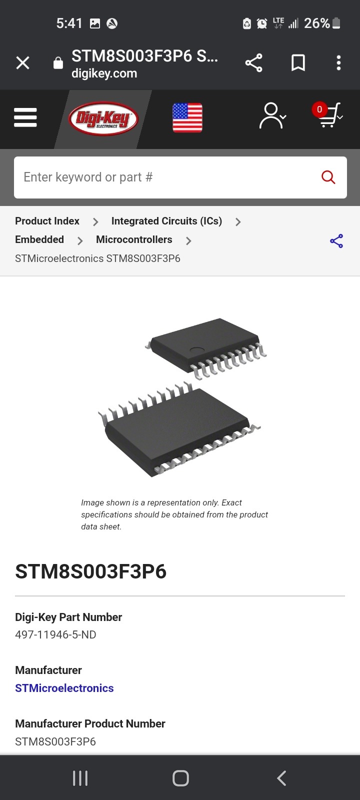

That part MUST come from the manufacturer. It has to be programmed, otherwise, all you have is a blank piece of paper (silicon).
Taramps told me it's programmable .... but I promised you I'd get you a part # for mc1 when magnifying scope came and it kind of turned into a personal mission with myself lol I spent hours staring at mc1 from every angle trying to read the markings .. victory is mine!

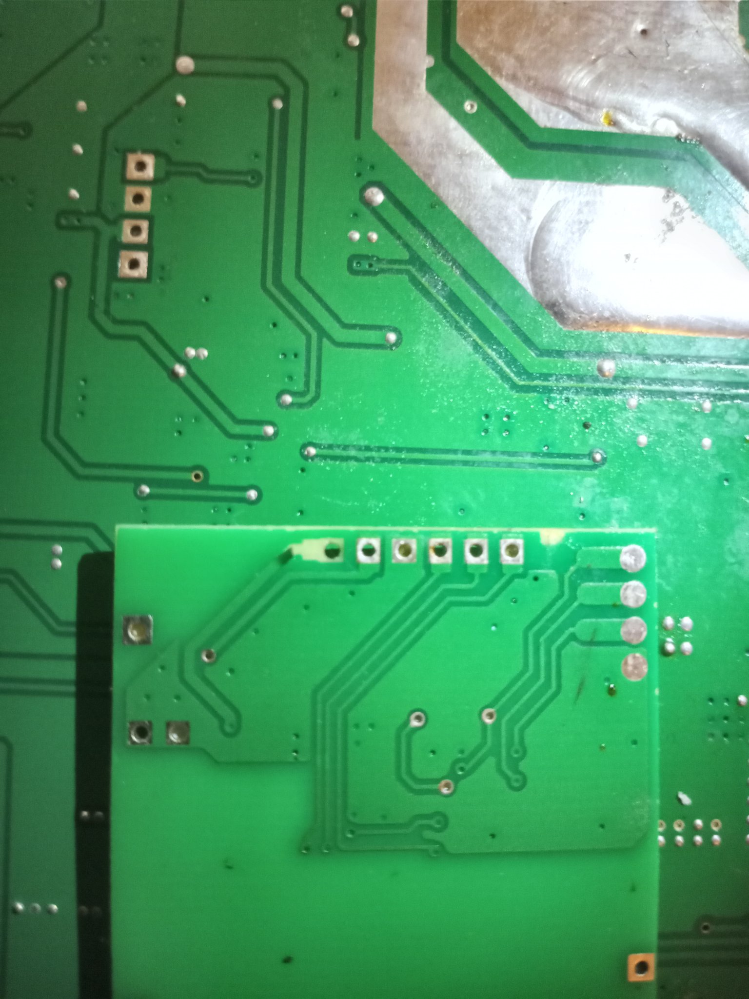

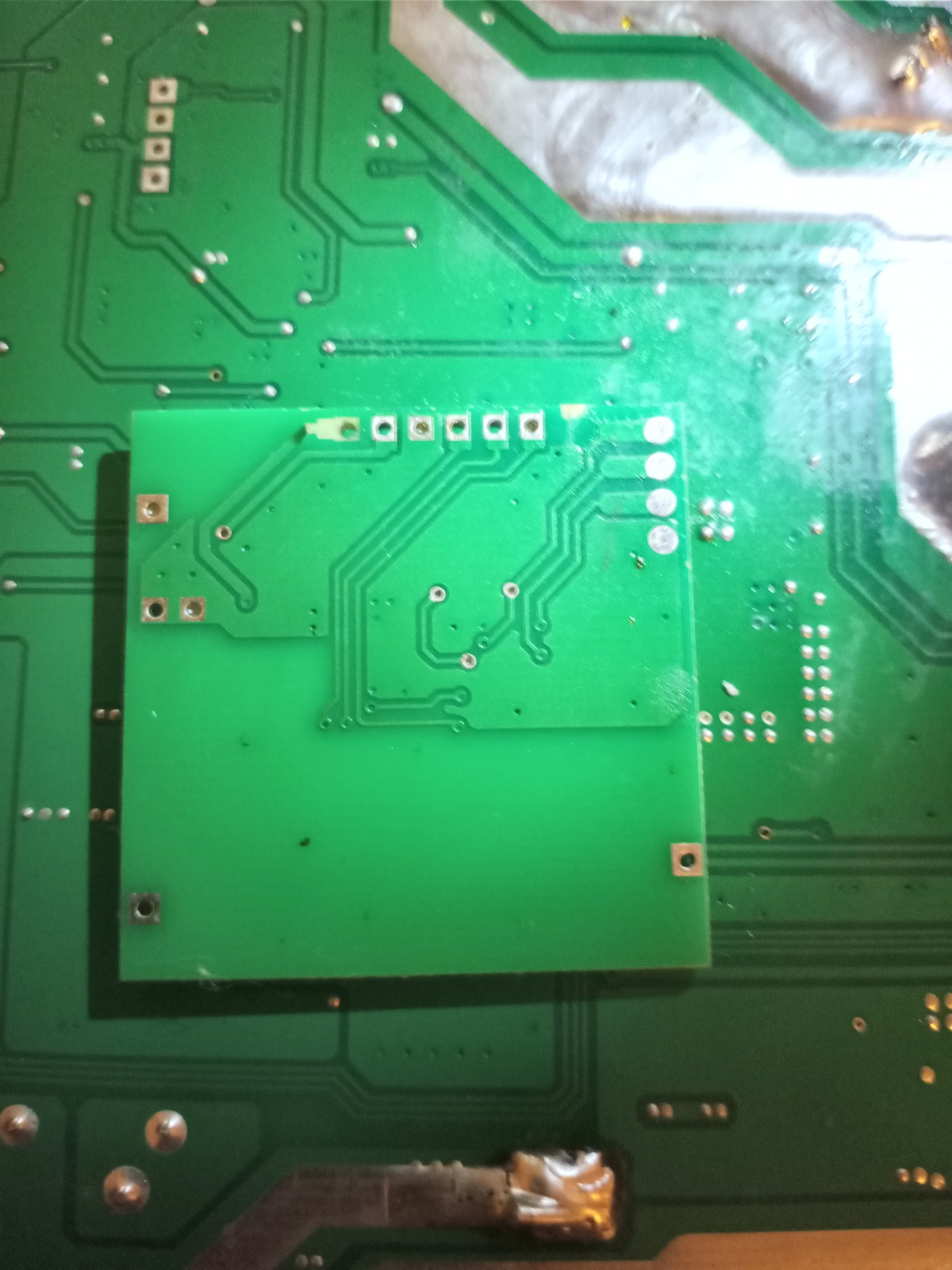

So I found what I think might have been the missing 5v remote problem I started with ..... I desoldered the smart led board and found a broken trace .....FINGERS CROSSED pic 3 any advice on best way to fix that trace or just cut it back until trace is solid on board expose bare copper and copper and solder wire any tips would be
I never doubted you for a second .... the reason I thought it went to pin 15 was due to my inexperience.... I definitely set us back alot of times but I learned alot 2 and have alot more I need 2 learnIf you look at the datasheet, you can see that the supply voltage goes to pin 9.
It looks like the solder was not hot enough and when the board was lifted, it ripped the trace.

Why not use the black meter you already have?
I have no clue as to what's causing the readings you were getting.
That $175 uei meter is a joke .
. I cannot believe it's what causing the weird voltage readings.... all of them are giving those voltages ... I have a feeling I'm our issue again not the meter.
I did try that meter ... but I'm more than fine using that one right now ill take voltage readings and post em
