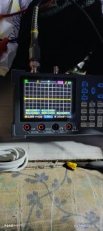

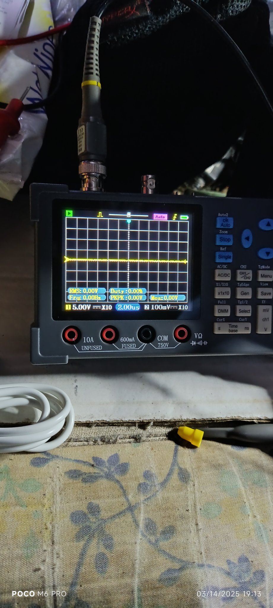

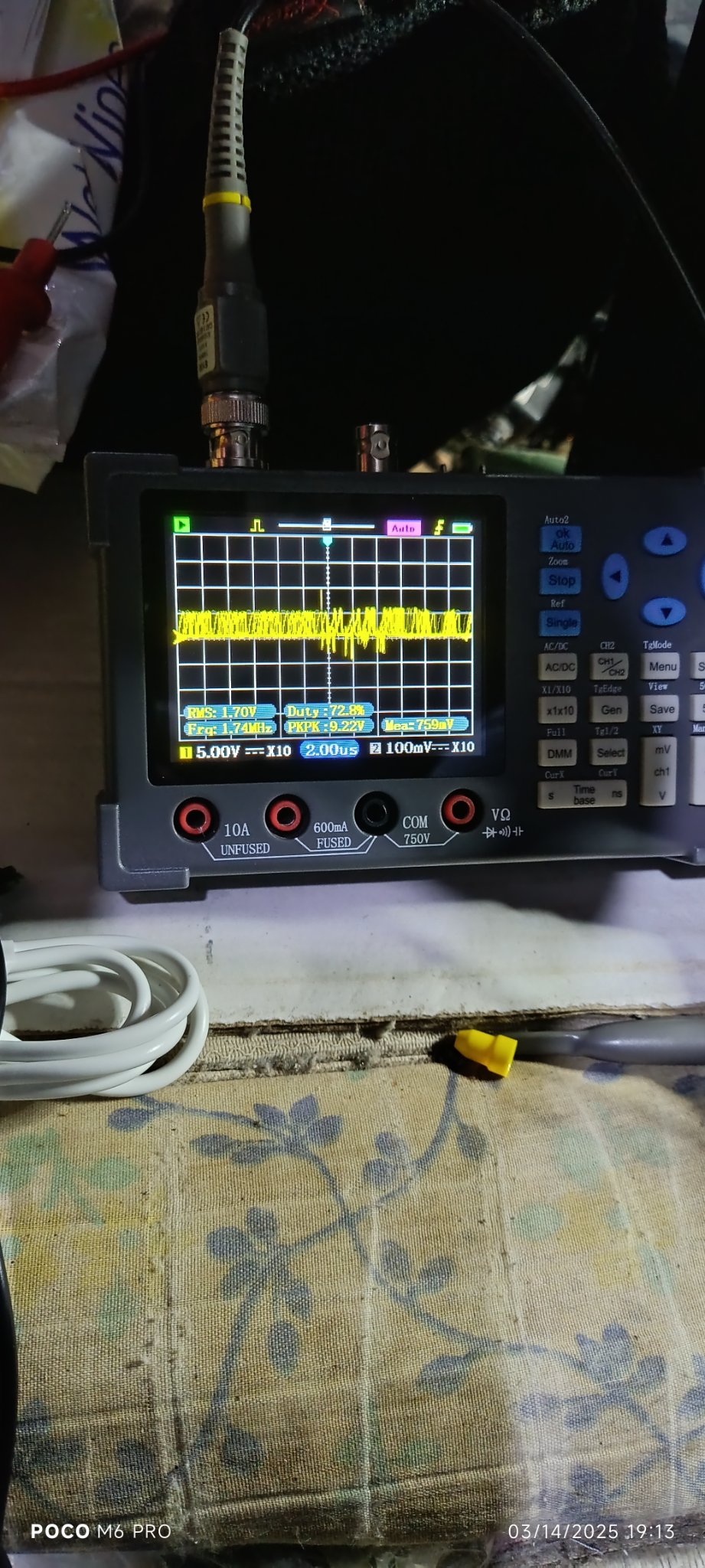

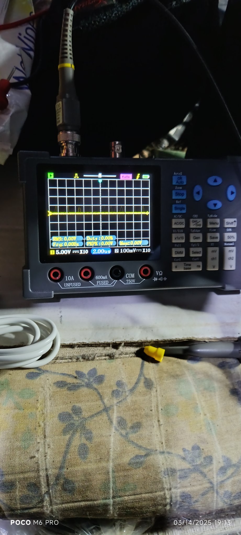

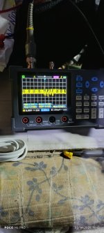

I don't understand the first question.
Yes, it's either none existent or, for a lack of a better word, weird.

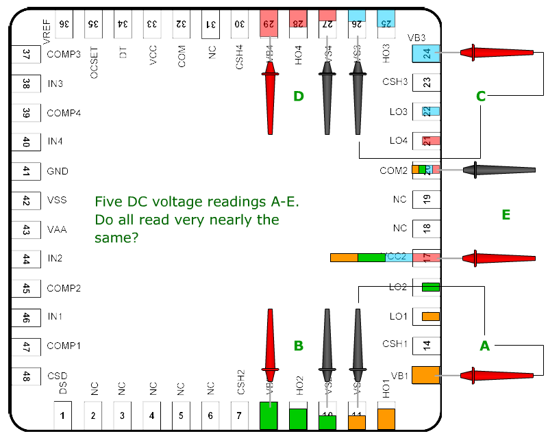

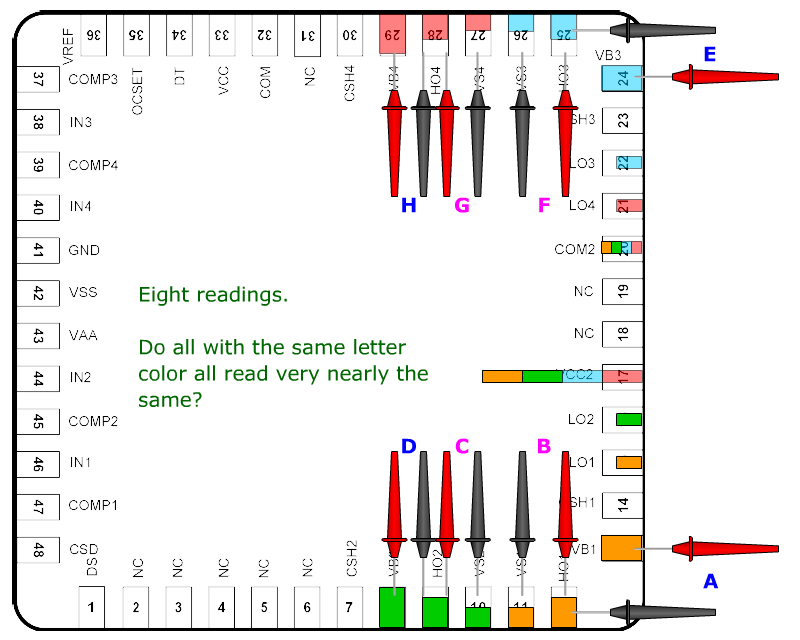

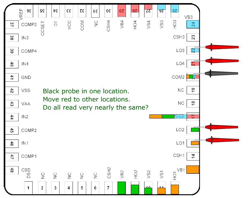

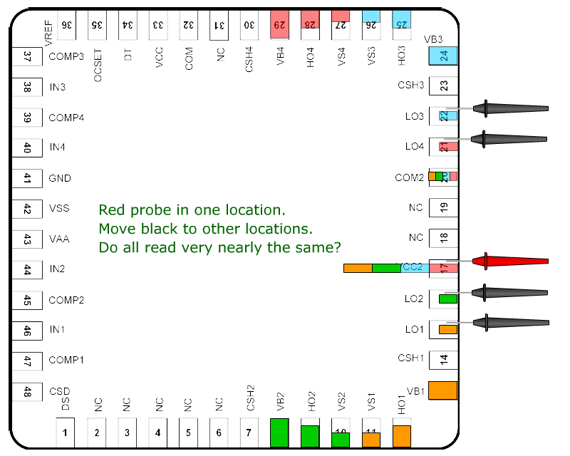

Connect a jumper or solder bridge across it.
Measure with a multimeter from gate to source for all of the output FETs. Do any read near 10v DC? Don't let the probes slip.
What's the rail voltage in the amp? Black meter probe on either of the center speaker terminals, red on the center legs of the rectifiers.
