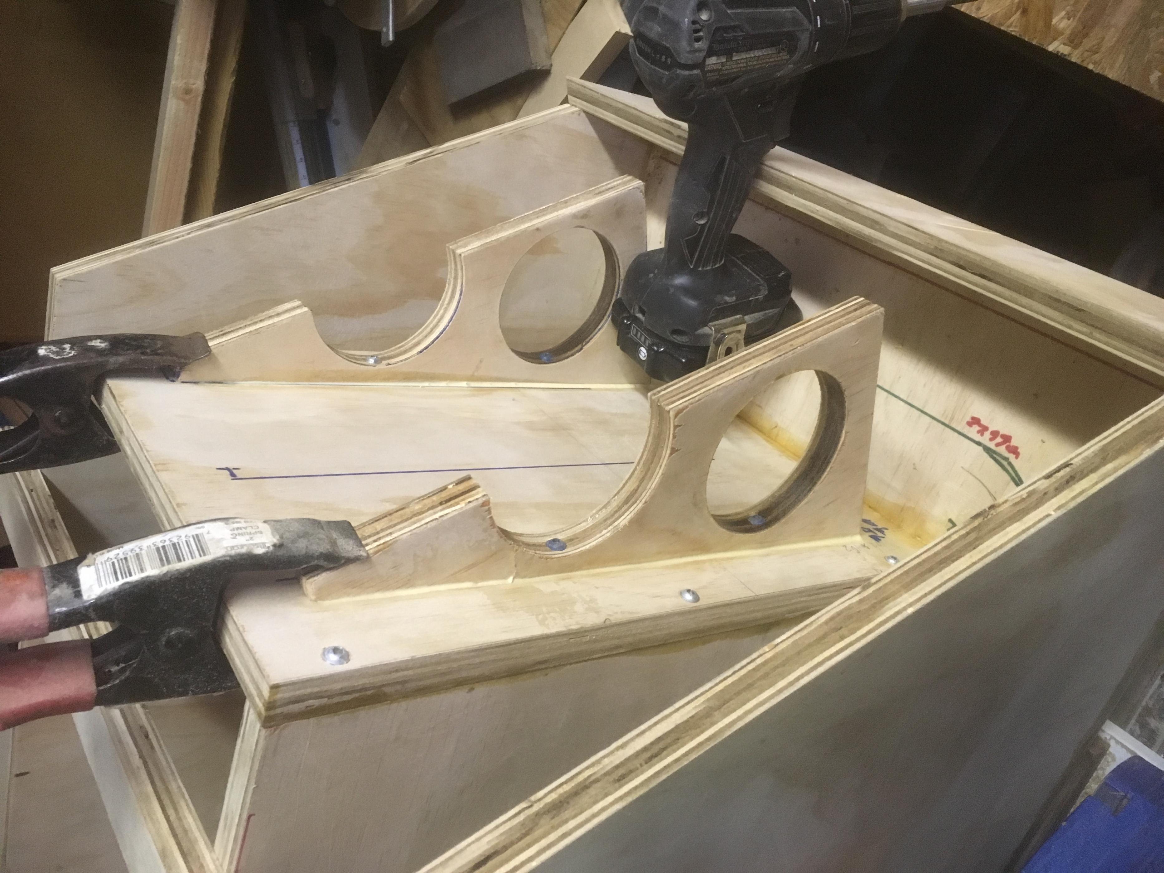

You called it. BW is hotter up top and favors some particulars :clown:

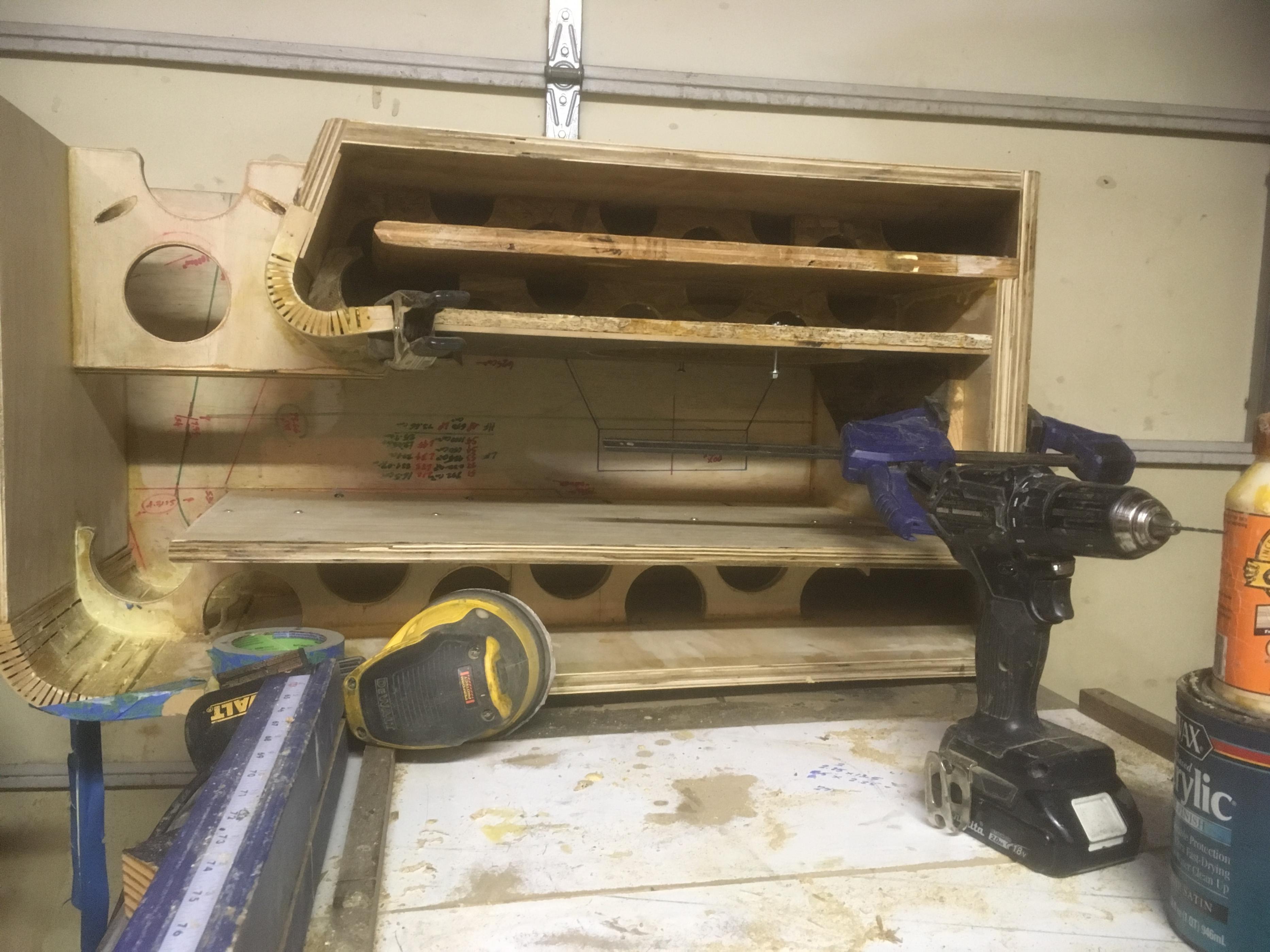

not too shabby, but if i could do again id grab a longer wider second half of the split csaLF path and drag it lower. Its so incredibly loud theres no need to not grab gentler and lower just ‘because’.

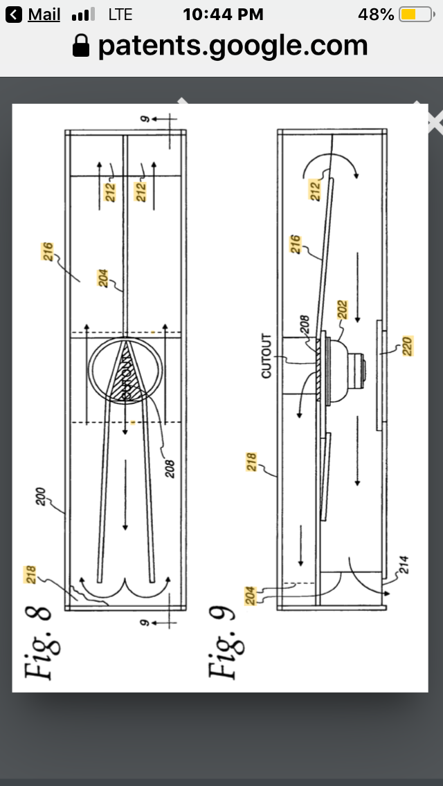

OK, assuming a 1/4 WL offset, this is essentially a Danley DTS concept TH.
GM
I think so? Im not sure which Danley but ‘tower of power maybe?

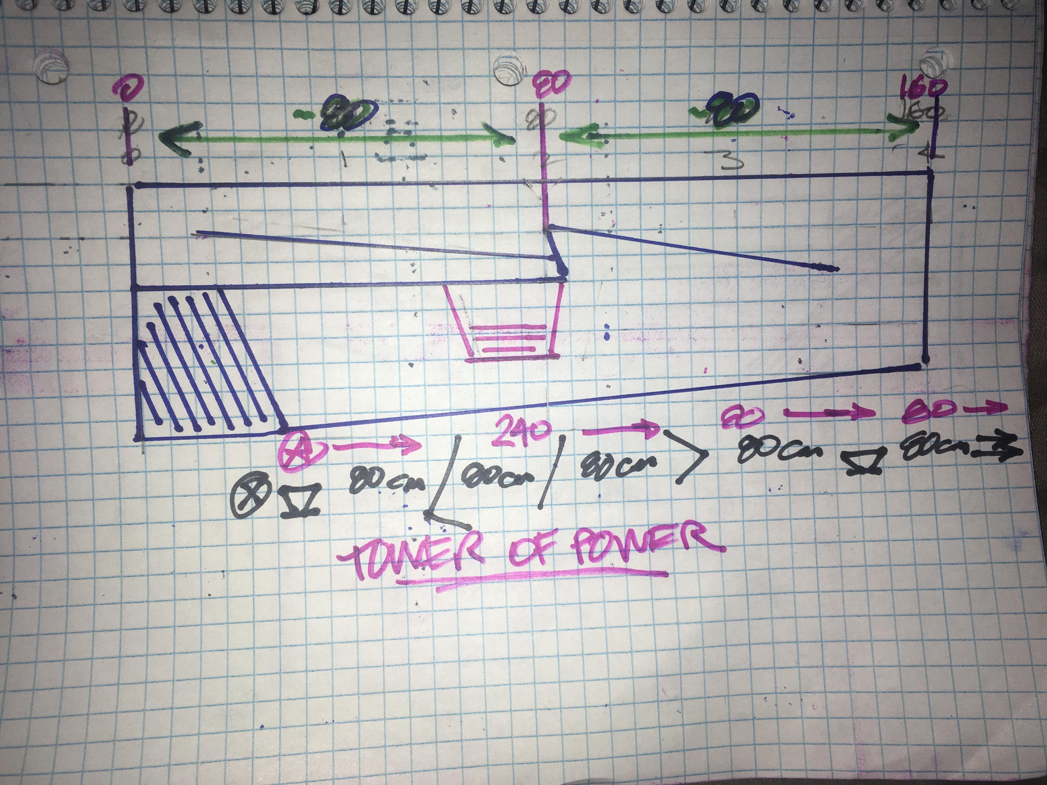

Starts at center of the bisecting box panel in the tapped entry, then is sent to a closed, where it goes all the way to the other end of a fold and makes another trip to the drivers motor side tap and has the rest to travel til the exit
That as
(driver(-)), 80 cm, (then fold), 160 cm, (then fold), 80 cm (then (driver(+)), then 80 cm (exit).....
But theres other lengths that can fit than... hmmmmm

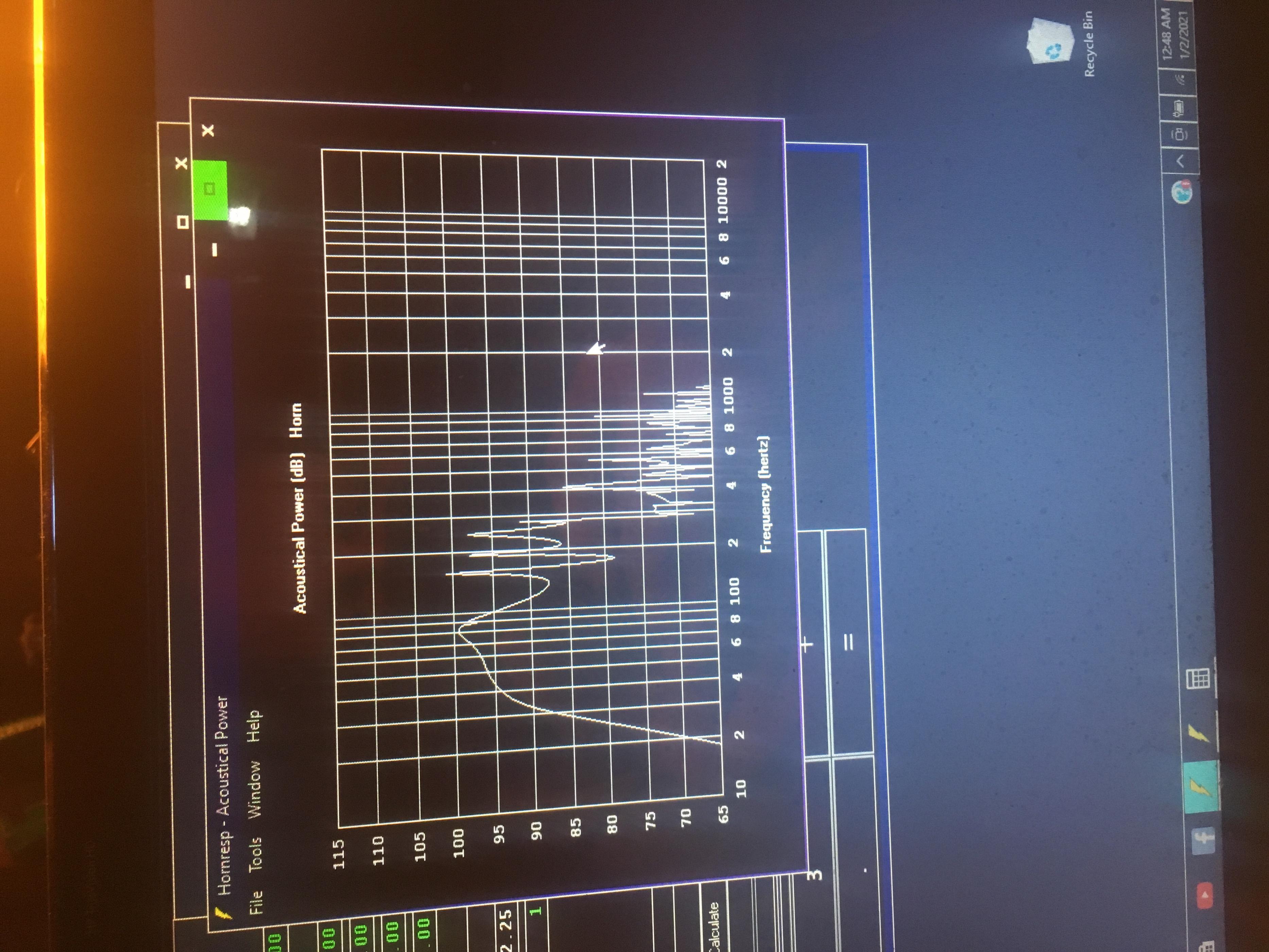

I ve got to plot that out as frequency, fillter LP, freq, filter LP, freq, polar shift, freqency , polar shift. the ladt two ‘polar shift affect all frequencies not just LP filter. Or thats whats suggested to me by the sim...

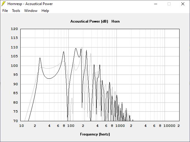

Why are simulation pics posted sideways?
Cheers!

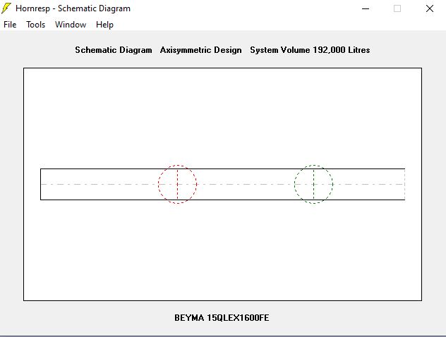

The black curve is the 120 + 120 + 80 cm tapped pipe version.
The grey curve is used as a reference and is 20 + 278 + 22 cm. Both have a 600 cm2 CSA and both use the same Beyma 15 inch driver.
What am I missing here (or what have I got wrong)???
I think i finally figured this all out. And its probably confused a lot including me😱 the idea of building on the harmonics is a great one. Thanks to Greg over and over again, and quite a few people in the qw section of the FB tech groups including paraflex and MLTL, and USRFObijuan i was able to chase down a few things and even managed to put together some great crash test dummies🙂
it seems the pattern i was insistent on can be found in ‘tower of power’, and some folded bose wave can on ideas too. theyre still pretty tricky to incorporate in a design because of fording and turns eating the math that you need to be both standingwaves AND an overall Fb(CSA expansion too).

Guerilla, the phone sometimes is in potrait mode and sizes a square otherwise i think. Sorry bud. I just realized that.
