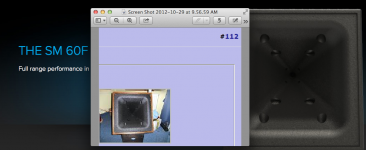

That is a Danley Sound Labs DSL SM60F "full range" molded Synergy horn.post 112 right pic ,is that a seperate hf unit?

so hf driver in the midlle,then 2 holes for each of the 8"driver and 4 hh holes at the end?

Hi weltersys,
Yes it is DSL SM60F, I have heard and seen this speaker 2 weeks ago in my city where I took the photo we had Hi-Fi fair and it was playing in one room. I was expecting more from this speaker in the terms of the sound it was good but not to throw me out from my shoes - that is happening only with my Hi/Mid and Low TH suwoofers at home......🙂
Four outer holes are bass reflex ports, four middle bandpass holes for the two outer speakers, four little center bandpass holes for the coax cone, center hole for the coax HF driver.couldn't quite see the scale of it .

Very coherent single source constant directivity dispersion, though the conical expansion is not the most sensitive type of horn.
Hi
It is as Art identifies and an implementation of a Synergy Horn as built as Fig#7 here;
Patent US20090136072 - Sound reproduction with improved performance characteristics - Google Patents
The SM-60f is a 3 way Synergy Horn system which also has a pair of 8” woofers feeding the horn (not shown in Fig#7).
The idea is that you are adding these three frequency ranges at dimensions that permit the wavelengths to add coherently like two close coupled subwoofers do except in the throat of a constant directivty horn which governs the radiation pattern.
The passive crossover accounts for the front to back time delay caused by the driver placement and the result is there is no normal crossover phase shift and so what one measures / hears appears to be from a single driver. With any of the Synergy horns, you can walk up to one and even put your head in the mouth and you cannot hear any hint there is more than one source somewhere in front of you.

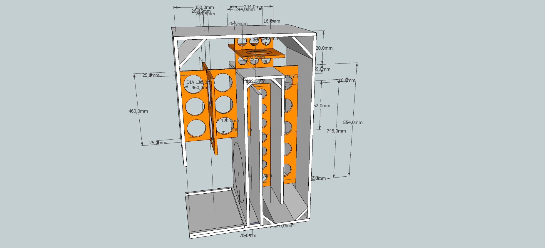

Whow, but no sections are conical? Just all straight like cyclops?
@parsleybasilkale: Consider doing hornsections conical to improve efficiency, should be no problem to build if parts are made by cnc.

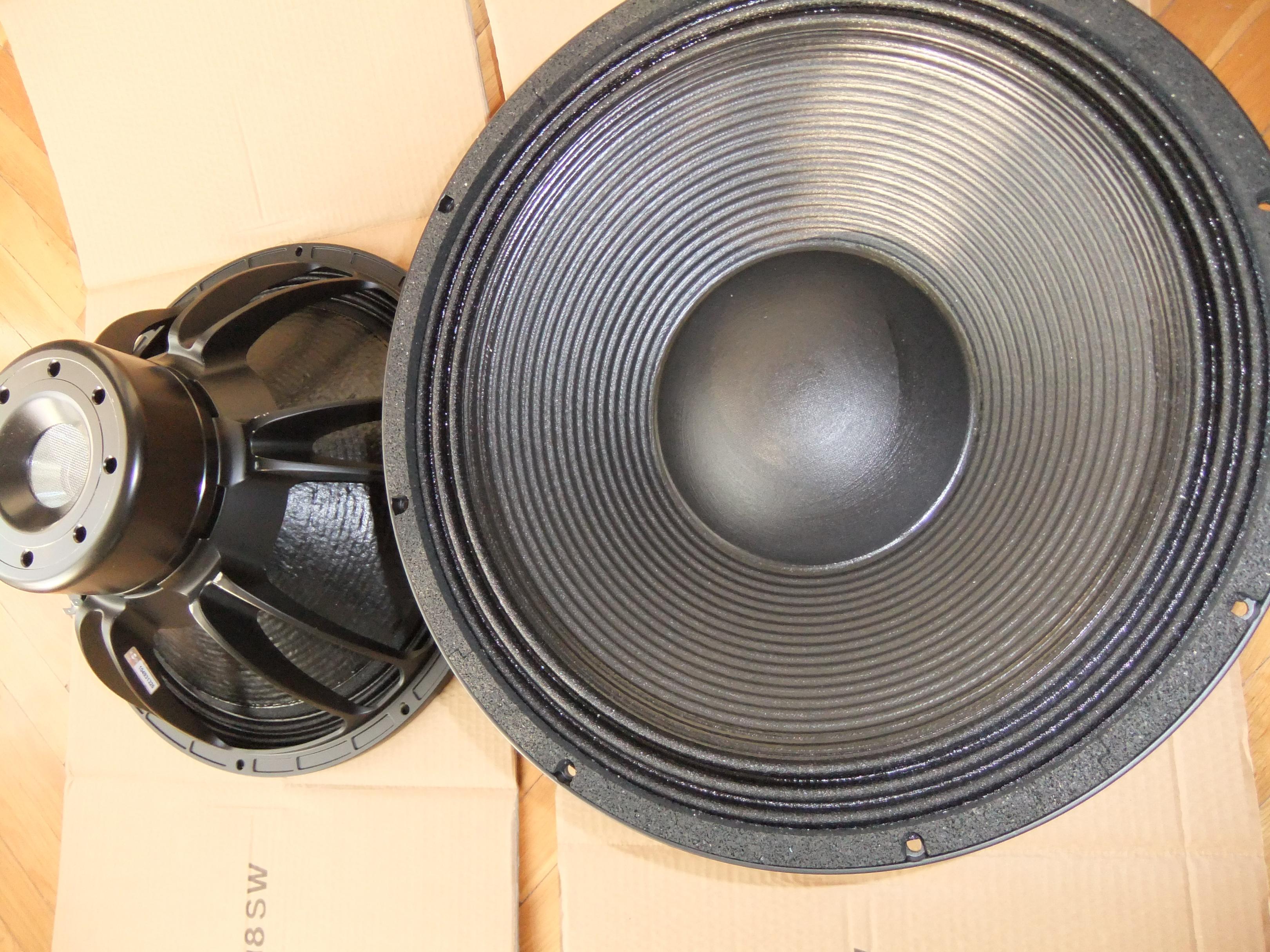

Small corrections, planing this spring to build two (2) new TH1819 with B&C 18SW115 - 8 ohm drivers!
That cross bracing looks nice! Is that a stepped TH or parabolic TH?
Stepped TH sounds right.
I believe conical is more effective?
I'd rather do this if I was doing cnc, angles are harder by hand than by cnc🙂
Doesn't make a difference at bass frequencies.
That's interesting!
But why does anyone care to make it conical then?
I guess one step is to little, there must be some limit🙂
I just got 4 CBe cyclops, they're stepped as well.
Then I'm designing another tapped horn, people tell me not to put corner reflectors as more volume gives more bass. Yet if you look at THAM15 with corners it has a possitive SPL effect
No one builds a conical TH. When the sides of a horn are parallel and the top and bottom increases or decreases, it's parabolic.

Read jbell's original SS15 thread and he explains how he tested the corner reflectors in his design. You can have them, but you should factor in their volume in your model just like with speaker basket volume. Plain and simple, if you add anything inside the enclosure, its going to decrease the volume of the original model. That why HR has the displacement feature for each section of the horn when you view the enclosure.
