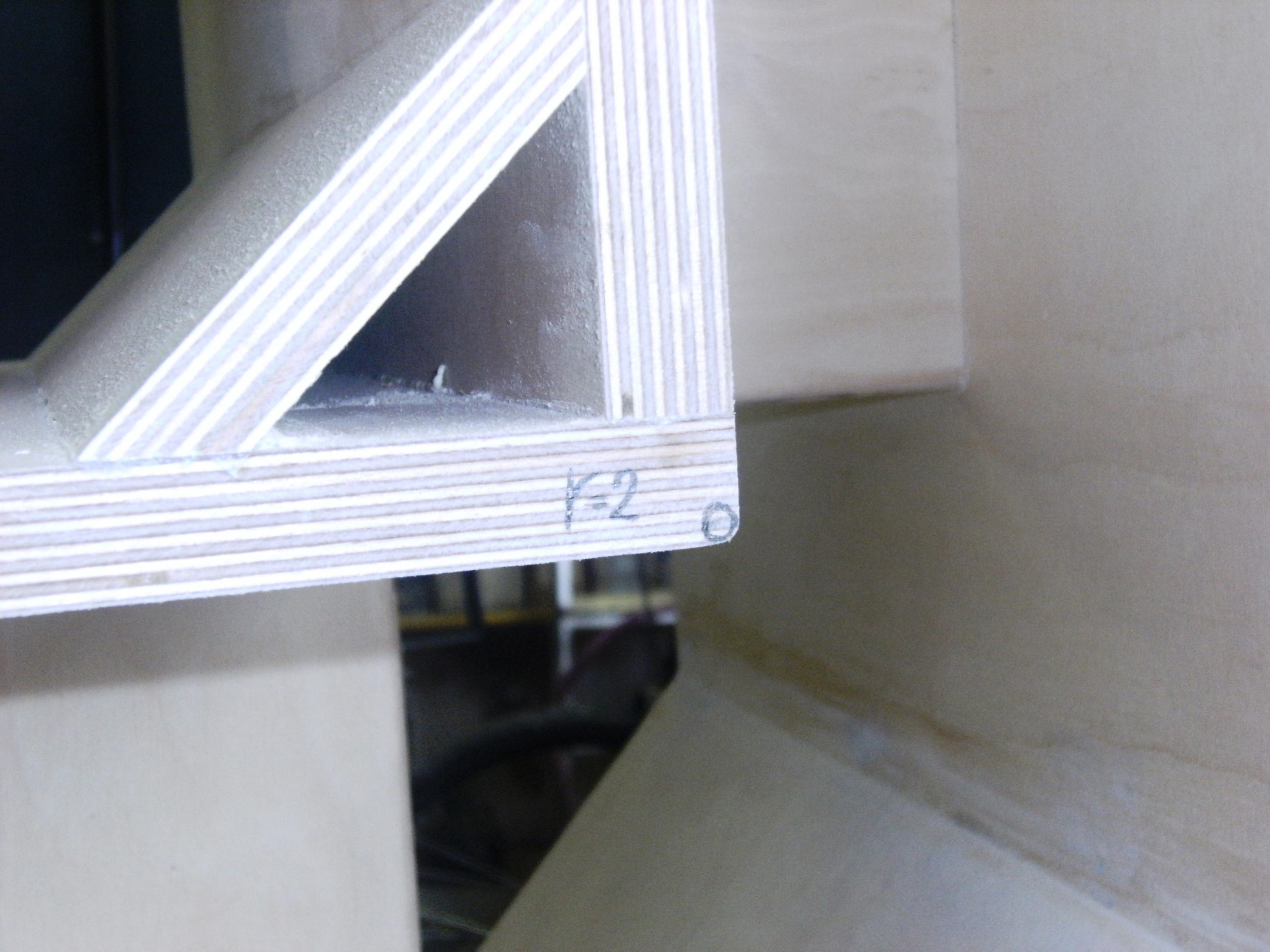

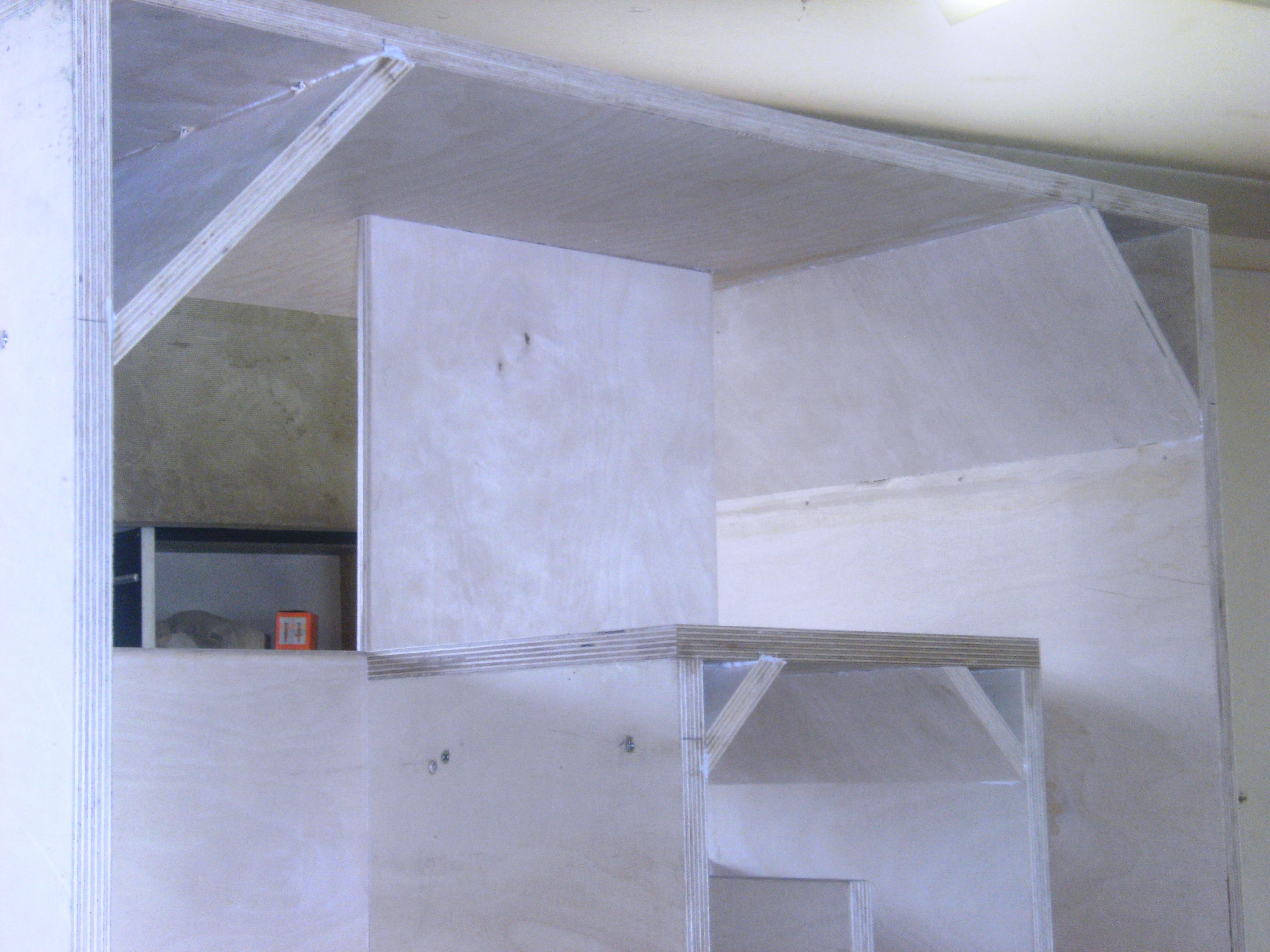

Also ZivkoF, would a cone compensating device be needed in this design? Thanks!
Hi djlivex,
Sd/S2 compression ratio = 2,16 : 1 🙂 there is no need for cone compensation device. Some inner photos before final painting.

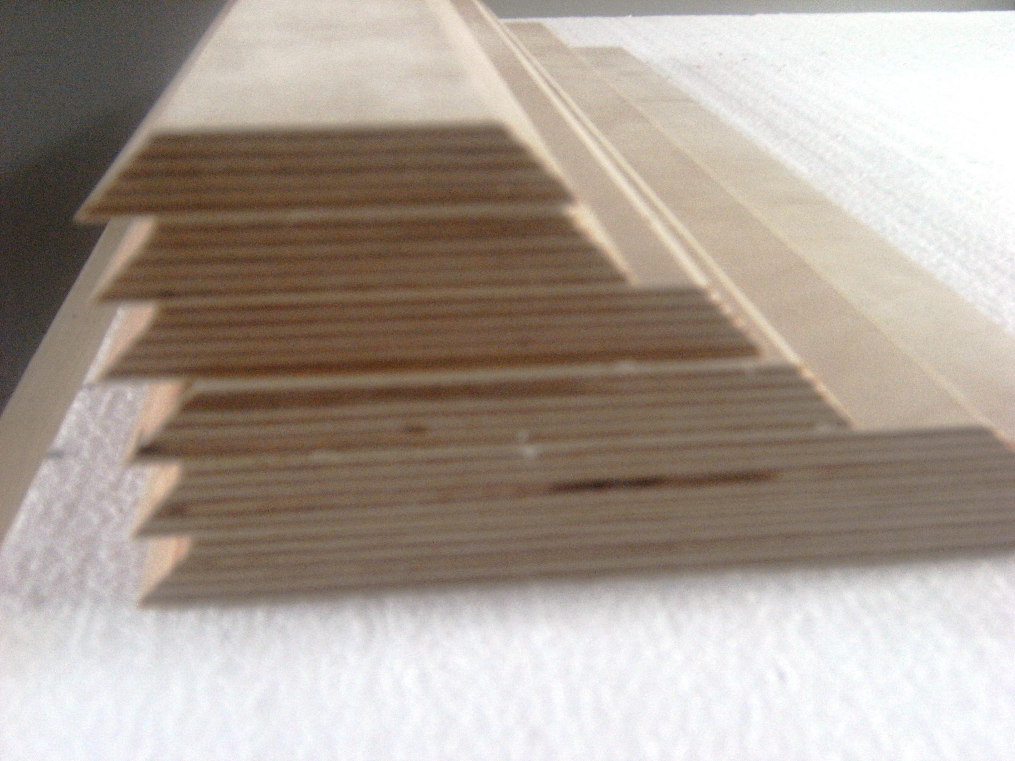

I was just curious about the long thread on TH18 with the compensation device. If I use 15mm version can I use Arauco with 5 equal plies? Or just use the 18mm version in Arauco which is about 62 pounds per 4X8 sheet instead of 76 pounds for the BB? Thanks!
Hi djlivex,
Better is 18mm version in Arauco, and 15mm version Arauco you can use for all internal brace, that is in original plan, the box is not small so 18mm is more rigid 🙂

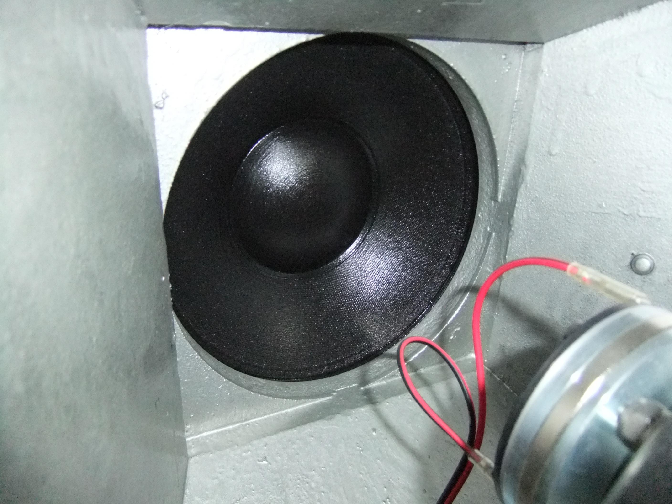

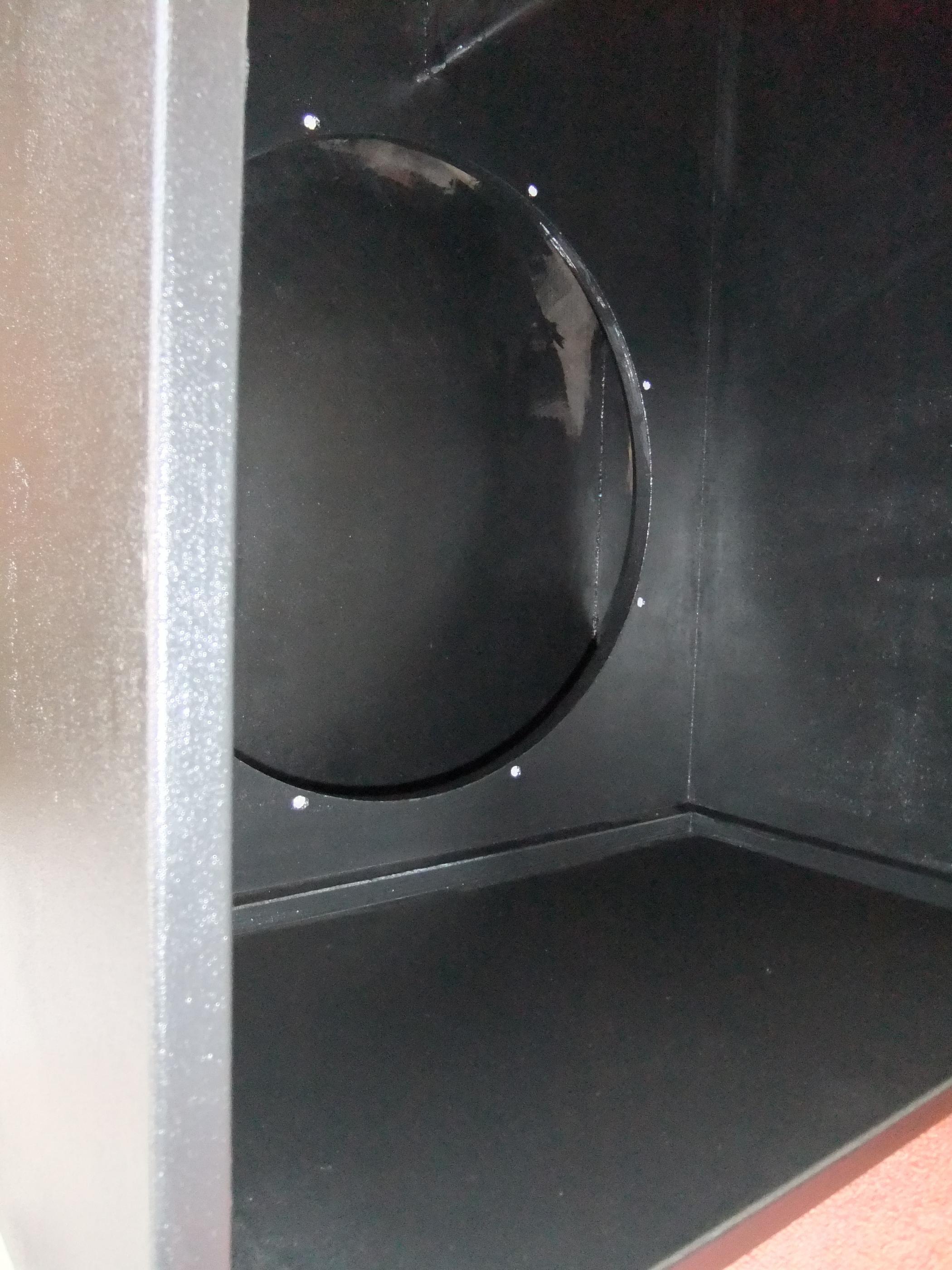

10-inch Mid Neo driver vs 2 x 8-inch LF driver

Nice response!
Hi BP1Fanatic,
I like the sound too, this responce is 1/2 space or 2Pi outside for one, I have two of them and they are colocated as I can read +6dB with SPL meter at my LF with two of them playing. I have them in left and right front corner which might be translated to 1/4 space or 4Pi or close to 1/8 space or 8 Pi inside with room gain 🙂 and responce is even flater.
