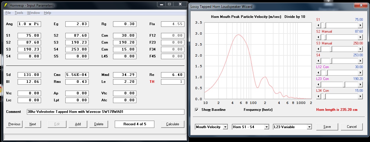

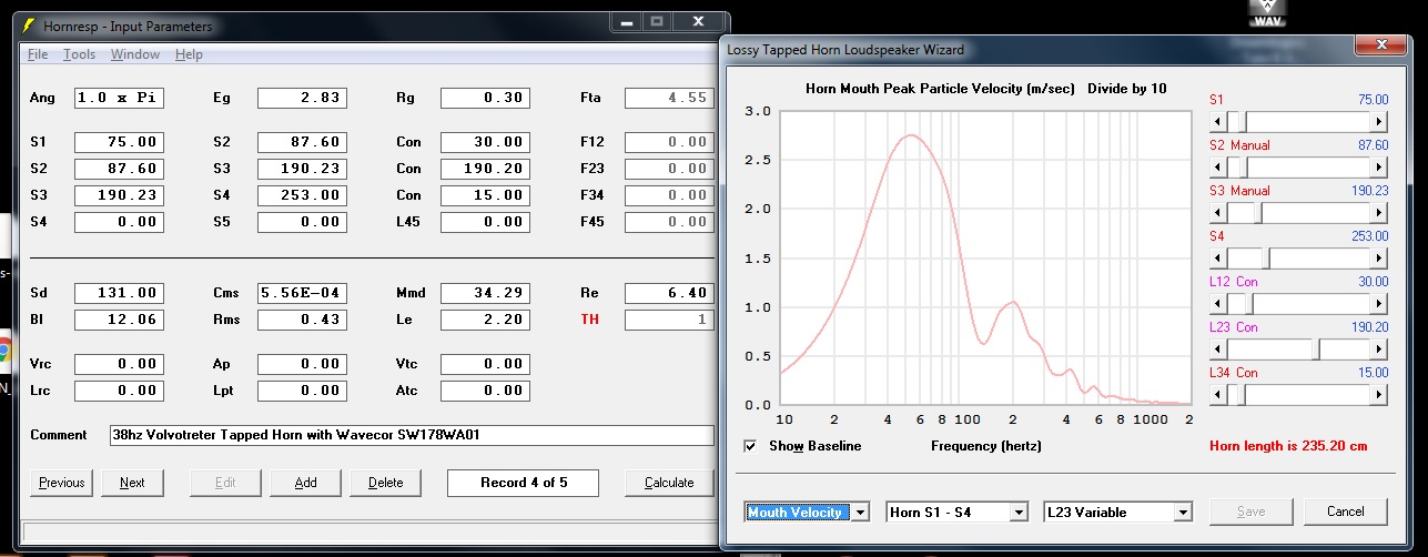

Modeling an increase in S3

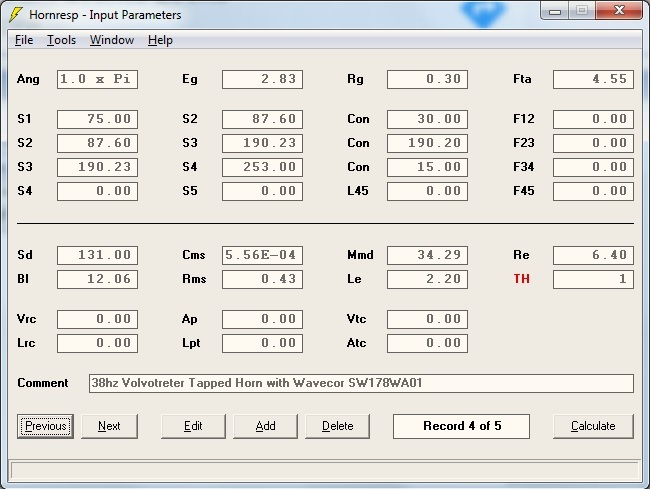

Here is the original model, all original dimentions.
Now I increase S3 to about the same as mouth opening area. From 190 sq. cm to 250 sq. cm. This is the cross section area of the last horn.
Why is mouth particle velocity increasing and not reducing like I need it? I am trying to reduce the airflow velocity so that the "chuffing" is reduced.

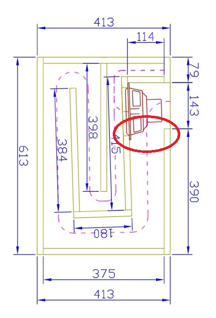

Also, if you look at the area of S3, it is 190 sq.cm. But 2(Sd) is a lot more, 260 sq.cm. So is the exit of the tapped horn pinching the air and creating the intense chuffing?
In HR, why is it when I increase the last segment S3, the horn mouth peak velocity increases and not decreases?
Hmm, looking at your charts, your descriptions don't mirror them, so rather confused ATM.
Regardless, the last segment is S4, so if S3 is increased, you've created a higher acoustic power alignment [it's bigger], hence will have a higher vent mach, but if you double S4 [its mouth], vent mach sims a ~50% drop.

Possibly pinching the air and causing strong chuffing?
Correct, so vent mach is probably higher than simmed, but open up S4 as I just posted seems to 'kill two birds with one stone' 😉 with no [simmed] audible change to the frequency response.

I see what you are saying but my point was the pinching is occurring at S3, the part that I circled. S4 is already much larger so that will not be the pinching area.
But I'll try something. I'll flip the driver so that the cone faces the horn mouth. The good thing is that the Wavecor driver has a shallow basket and the magnet clears the internal wall. Nice! I'll post my findings.

I built the Volvotreter 38hz folded tapped horn mini subwoofer. Tried the original Tang Band driver and also a Wavecor driver.
I built the double fold version:
https://volvotreter.de/downloads/TangBand_W6-1139SC_38Hz_TH_Rev_1.pdf
The Tangband 38Hz Tapped Horn – Volvotreter Homepage
The mouth of this tapped horn makes way too much chuffing noise. Using it 35-75hz.
It's a pity and I'd like to ask for help identifying the problem. Is it a bad design?
Can I increase the mouth opening, or modify it in some way to not scrap all the wood?
Any advice and thoughts on making this design work for me would be very appreciated.

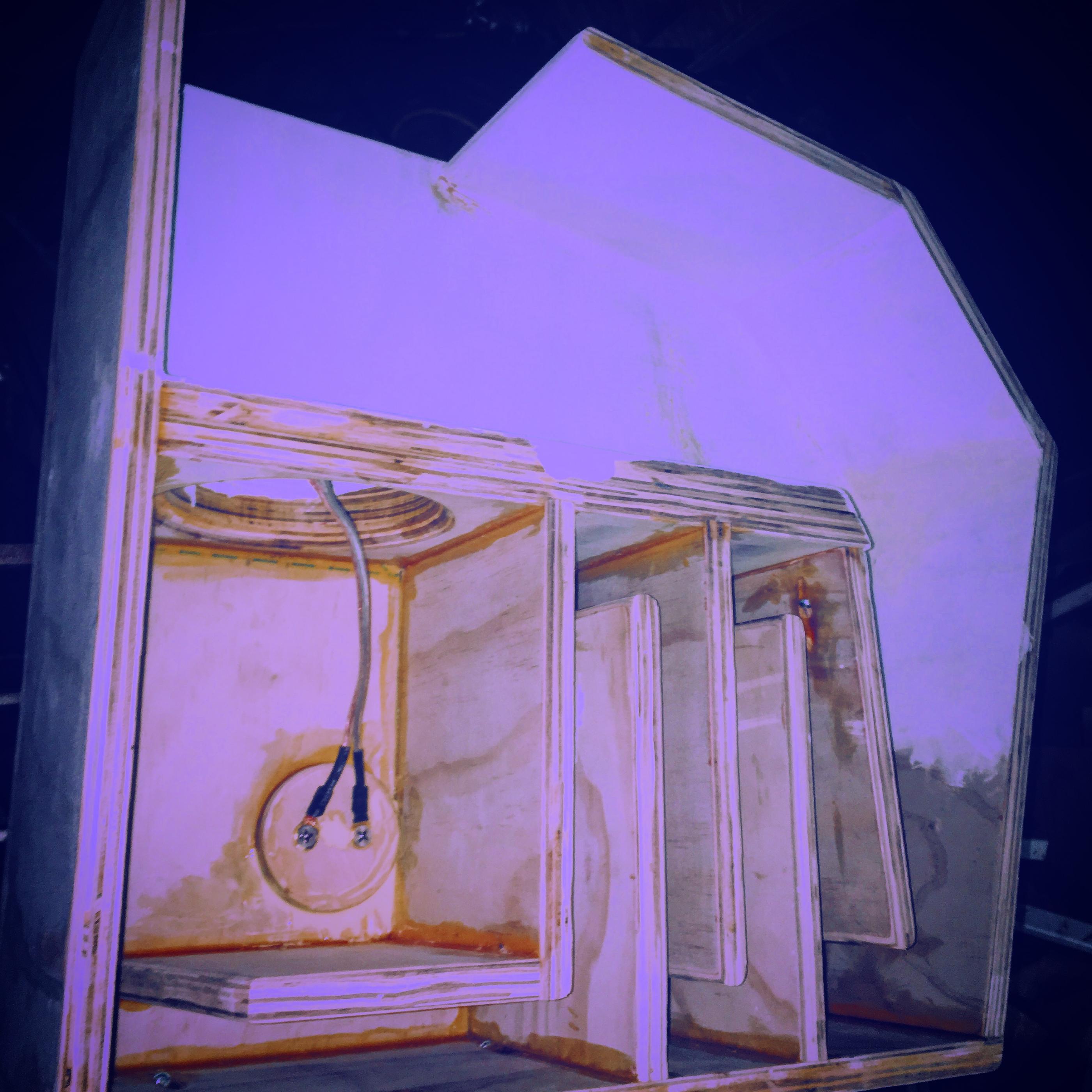

Tangband w5. Trial and error. Later trimmed down the mouth and throat chambers and it flattened nicely into a response which was tuned in the low 30s at xmax and 100 watts. now i have 2 more to build.
