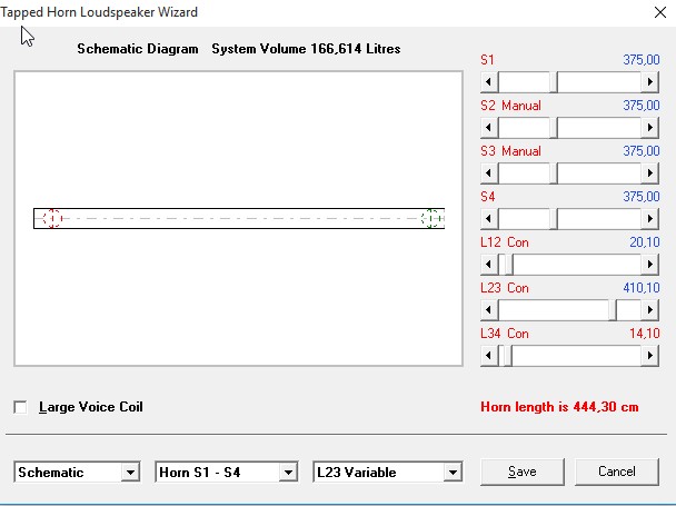

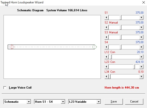

Hi There
I have some questions, how to implement the output from hornresp drawn if the speaker is halfway out as on picture, and what if it is just in it, or fuirther in it like the tapped horn pic who i think is right done, half out like on TQWT is not complete clear for me..
I have always did think how to do this right for the TQWT, I did drawn the tapped horn, I need some advise from experts here.

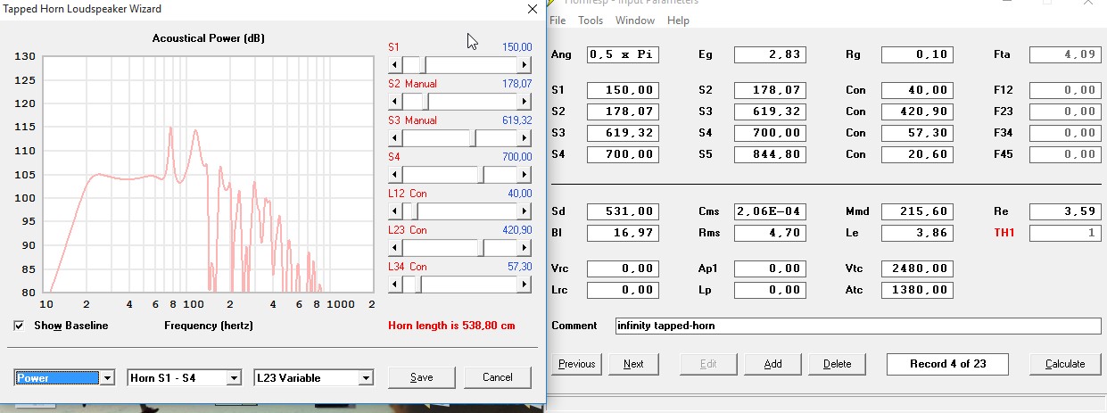

I'm far from an expert, not 100% sure what you are asking and I am terrible at explaining things. Lol.....
But I think what your wanting to know is explained in these two diagrams I found on a Google search.
They sure did help me understand.
An Unfolded tapped horn is below. NOTE: a tapped horn must have at least one fold to function.

I mean in hornresp you see the speaker is out for the half part on on pic two and pic one is oke I do now what to do see previous post.
it boring me I am not shure what it means as the speaker puts out of the horn as in pic two as example.
I can also ask on hornresp threat.
regards

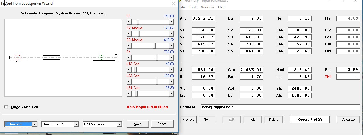

There, now your front tap is firing into the throat and your driver extends past the mouth of the horn on the rear tap as your sim shows. (I showed an expanding csa instead of a constant csa though.) The sides of the mouth would also have to be trimmed back so it would look like this with the side on.
This would be an oddity and unless you have a VERY specific reason for doing this it would probably be best to modify the sim to get the driver back fully inside the mouth. As it is it looks dumb and there's no protection for the outside half of the driver on 4 sides.

You got meeee hahaha, this is just what did trouble me, because it is now clear thanks to you that I was right on the first hand, just keeping things inside, otherwise it get stealed.
Hihihi when blow up the woofer the half conus is launged, and the other half is still in the frame, inclusive half the voice coil, what a joke will dat be banging mister murphy of his trone.
Then I did right, see pictures.
thank you mate.
