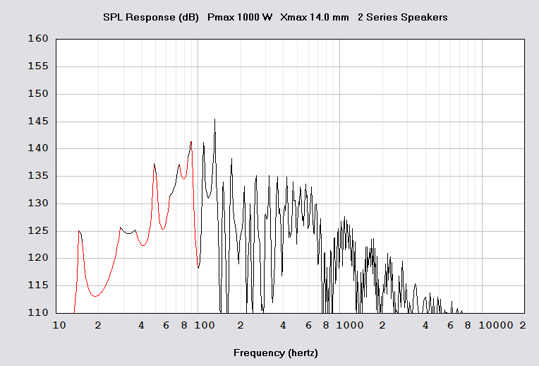

But since jsewell is doing a tapped horn, keep in mind that the massive gain you get from putting the sub in a car can substantially flatten out the in-car response.
Here's a couple graphs of a horn sub in a car* and a tapped horn in a car.**
Car Audio | DiyMobileAudio.com | Car Stereo Forum - View Single Post - Small Tapped Horn For a Car
* the horn sub is a 'clone' I made of the autotuba based on pics online
** the tapped horn sub is a 'clone' I made of the TH-Mini based on the spec sheet
