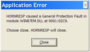

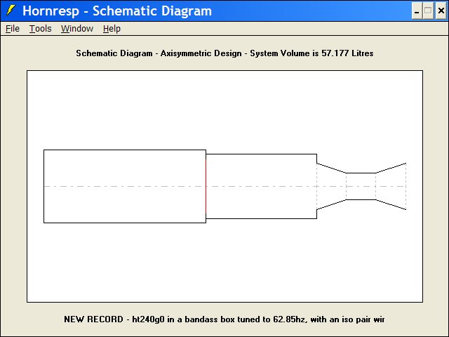

David -
I have good news and bad news. The good news is that horn response doesn't throw a divide by zero error when the horn segments are straight or narrowing.
The bad news is that it still throws an error about 25% of the time when you do the following:
1: Change from a 4pi to a 2pi simulation
or
2: Model an enclosure where the segments aren't expanding. For instance, you can use hornresp to model a transmission line or a bandpass with a flared port at both ends now, but it errors out about 25% of the time.

The schematic diagram demonstrates that the port is indeed flared at BOTH ends. Up until recently, you could only model the flare at the mouth. Of course this is very valuable, as a flared port can be used to reduce the overall length and size of the port in a bandpass enclosure.
Patrick Bateman said:The bad news is that it still throws an error about 25% of the time when you do the following:
Hi PB,
Many thanks for the feedback.
Unfortunately, as far as I am aware, there in nothing that can be done about the second error. The problem is due to an incompatibility between the computer you are using, and Hornresp being a 16-bit program. You will note that it is a general "Application Error", not a specific "Hornresp Error", which means that it is being generated by something other than a coding bug.
You wouldn’t have an AMD Athlon processor in your computer, or be running another 16-bit application at the same time as Hornresp, by any chance?
Kind regards,
David
yes and yes.
I was running hornresp on my girlfriend's laptop with a intel processor and a vista OS, and noticed it crashes quite a bit less.
By the way, you know you're ADDICTED to building speakers when you're asking your girlfriend if you can install hornresp on her laptop while you're out of the country on vacation 😛
