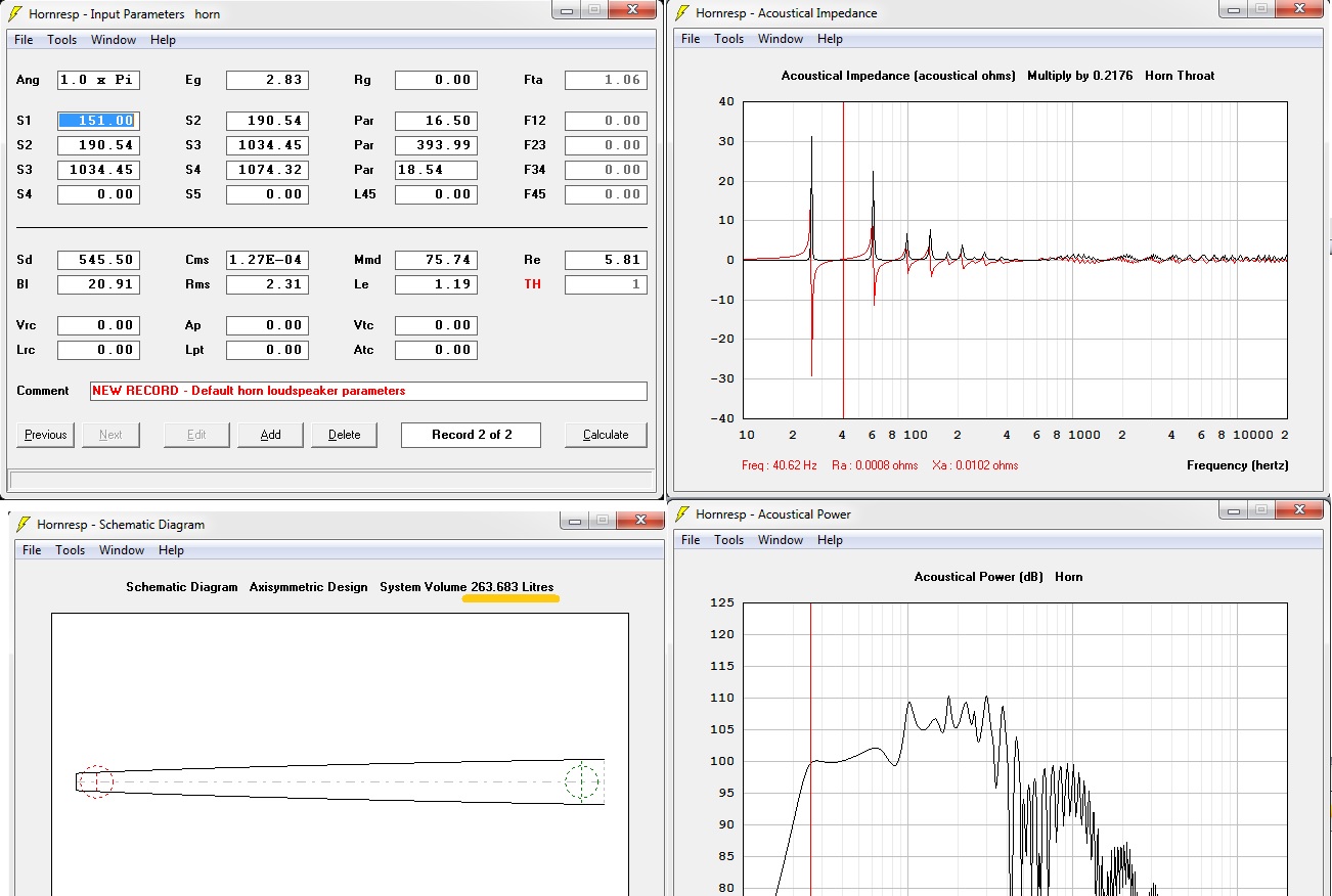

This is the most relevent page of information on the topic I can find. as I dont have my origional sims and they are no longer hosted as I didnt know how to upload them directly into the forum.
Collaborative Tapped horn project
I sence I had some level of confusion at the time.
The sim, I sent bjorno the picture of is included there,
I was Confident that My Actual design was my destined 25-75hz and as I recall it was rather much like taking mike hunts horn and elongating it to add 80cm(approx) to the path length.

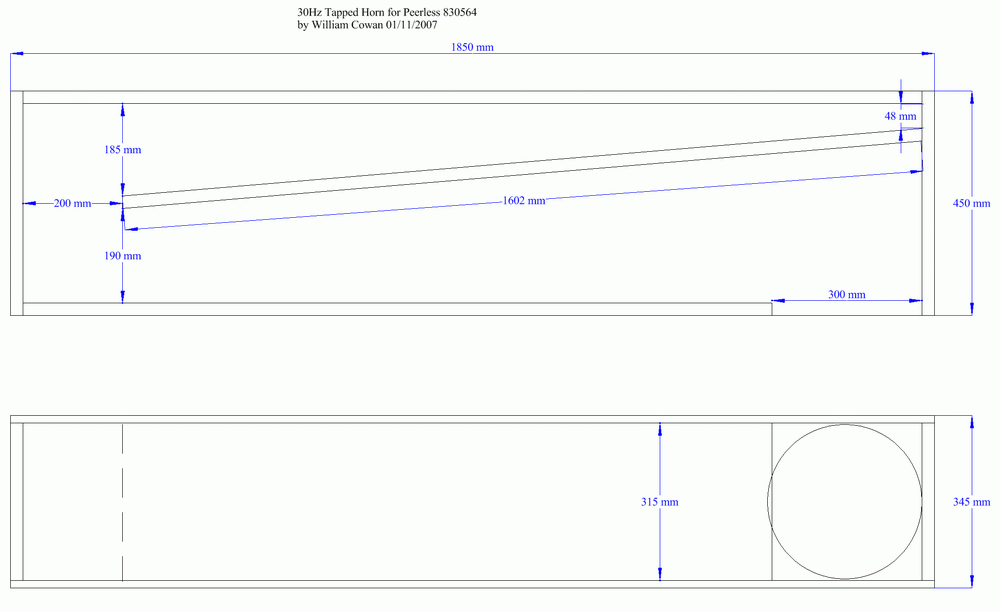

this is the page with the most of it, including a pdf, but when I made the hole for the driver I most certainly made it the same size as the drivers radiating area, it looks about right proportionatly. The Pdf. ....I wonder how that differs from his sim he provided. or how mikehunts horn simulates. or a NEW simulation showing mike hunts horn with added 80cm (ish) path length. as that was bassically all I did. would be Grand indeed to find I did actually get a horn that was the 25-75.

As far as I can recall this was the dimentions I built, very close. I know I made the mouth slightly larger, square infact.
It was the same as mikehunts horn, (also in the thread) but the final hight was 2220 tall. I bassicaly streched the design to opt for a lower tuning than his. this added to the path 81.22cm, and made the mouth square. I wonder how His would model? if it would show as true, but more importantly I want to ensure the horn I built actually has the passband I opted for. I saw it to be 25-75 cycles.

It is bassically this, but 2220 long/high, the dimentions at the turn around where kept the same, so the inner path section was a corresponding angle to the slightly lengthened cabinet.
I made the mouth area Square.

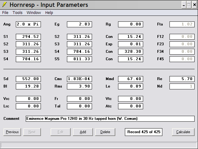

GM: This is Your simulation I found for William Cowans 30hz Tapped horn That MikeHunt used with the Eminence Magnum Pro 12HO
and a Link to this Page.

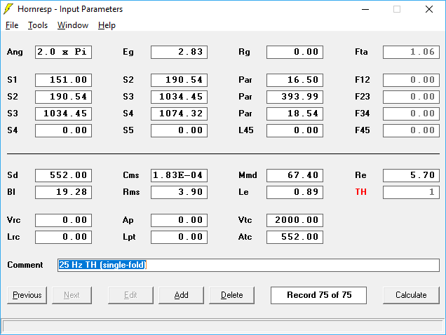

Those earlier attempts at Hornresp TH sims tend to be a bit off.
Typically:
1. Segments are sim'd as conical (CON). They should be sim'd as parabolic (PAR) if the horn is being folded up into a rectangular box with at least one dimension remaining constant (like your example).
2. No "cone compensation". Vtc and Atc should be used to sim the volume of air between the cone and the start of the TH.
3. Incorrect path length calculation. The "advanced centerline" path length calculation approach usually gives the closest results when comparing sims to actual measurements of the built systems. I use the advanced centerline approach for my horn design spreadsheets - The Subwoofer DIY Page - Horn Folding
And more recently, the "Lossy Le" or "Semi-Inductance" options should be used if the drivers are long-excursion drivers. In fact, I suggest using the "semi-inductance" option wherever possible, though you will need to obtain the required extra driver parameters first in order to use it.
The bad news is that Hornresp sim you posted is way off.
The good news is that a corrected sim does look you might have hit your target, if the dimensions of your TH are a close match to those given in the spreadsheet.

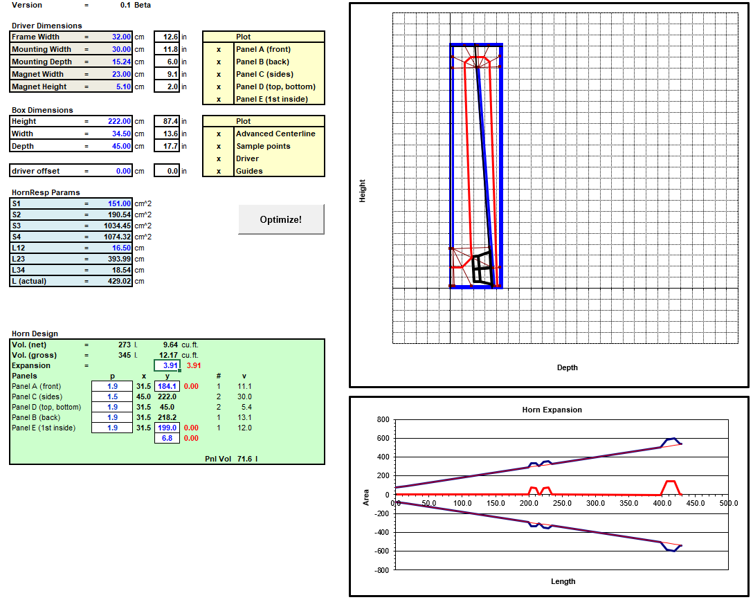

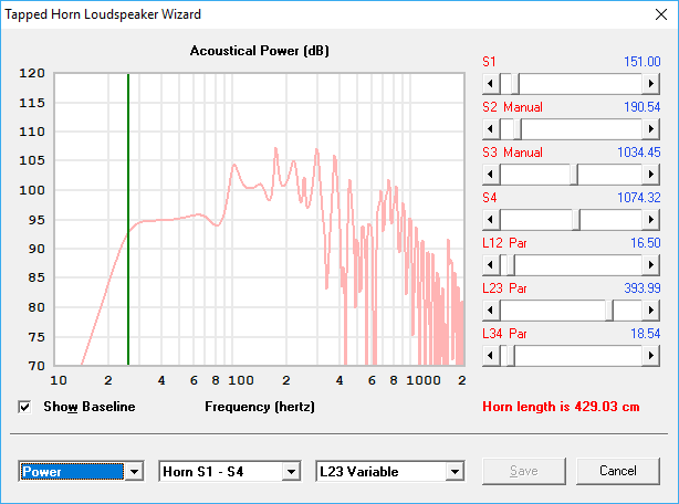

Attached are:
1. An optimized sim of a single-fold TH using the external dimensions you provided, and the location of the internal panel at S1.
2. An adjusted Hornresp sim, based on (1) and the actual dimensions of the mouth of your TH. The difference between 1 and 2 is minor.
I'll be making the optimization spreadsheet available from my site once I've finished work on it.
