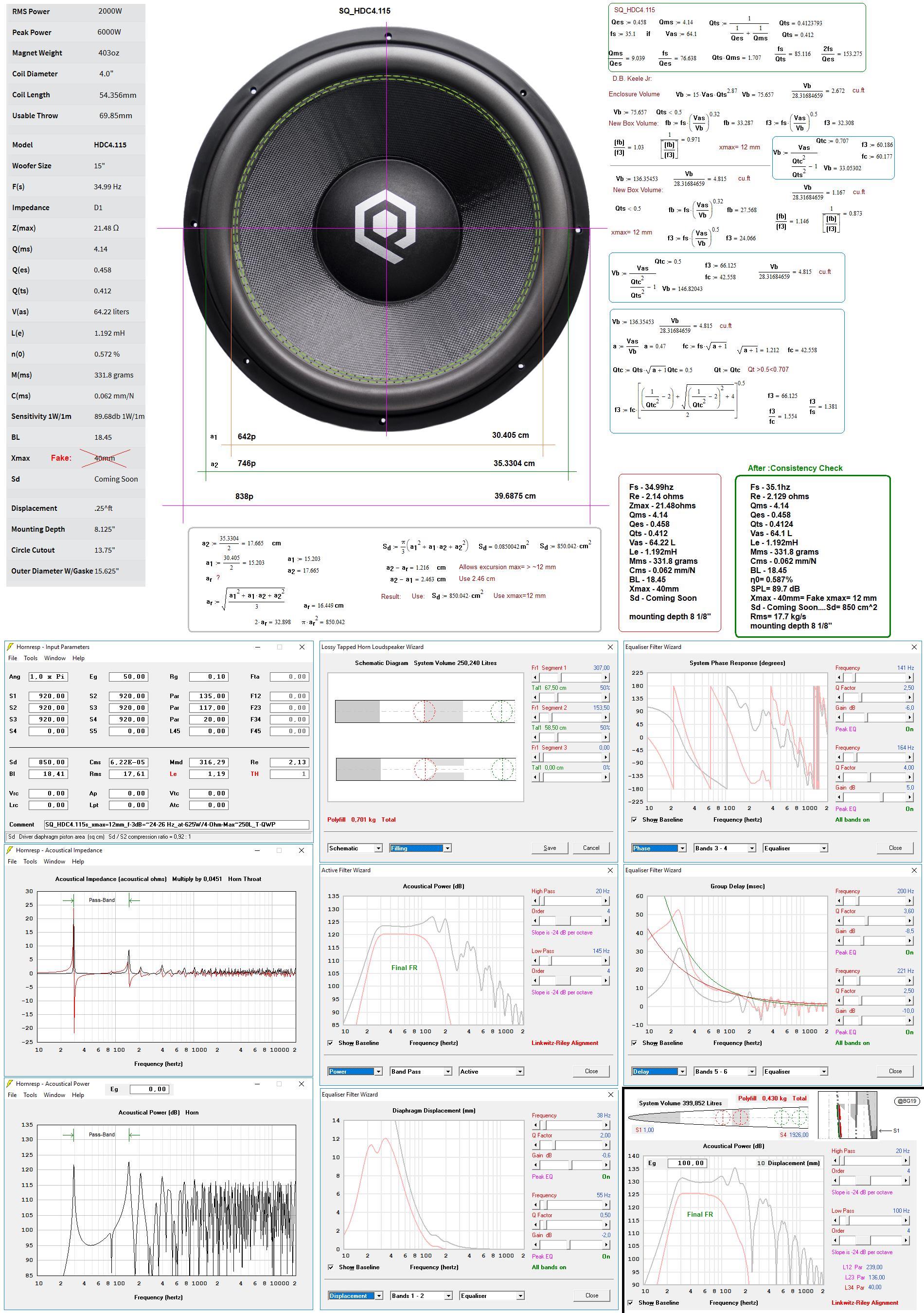

I have two Soundqubed HDC4 15s laying in a way too small box atm and i want to make a nice upgrade box vise. This will be in a home cinema/ used for parties
Therefore im hoping someone knows some tips about tapped horns. wanted to share my current plans and i have looked into all sorts of types of cabs all the way from simple ported boxes to 8th order cabs.. that being said, what do the horn experts say about my current plans and can you use this massive driver in a tapped horn? how big of a box im a looking at if i want a "true" half wave lenght horn all the way down to 27hz ish? MUUCH appreciated in advance:)
Operational Fq range: 27-50hz (do you tune tapped horns?)
Driver: SQ HDC4 15s
Amp: 5k pa amp by crown
Money material vise: deep pockets but uknow reasonable

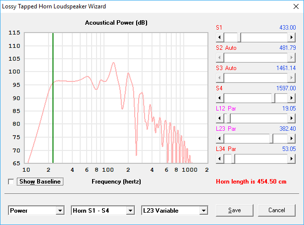

I came up with this, but it's a BIG box, 461 litres net. And passband is around 20 Hz to 60 Hz. With an Xmax of 40(!) mm, I might be tempted to go with a 4th order BP alignment instead...
!! Exactly what i wanted, the bigger the cooler" if you ask me,
But okey the high Xmax is more suited for 4th order? Its a car audio sub with huge magnets and stuff so idk if its a nono to build it around a PA type enclosure

Well, you could try building the TH I suggested (or something like it). It's a simple fold to do - either a high rectangular box with one internal panel, or something like the MTH30 type of layout - which you can use the appropriate spreadsheet from my site to help work out the details. And don't forget that it needs to be partly stuffed as well.
Me? With that driver, I'd go with an assisted sealed design, or a dual-PR design.

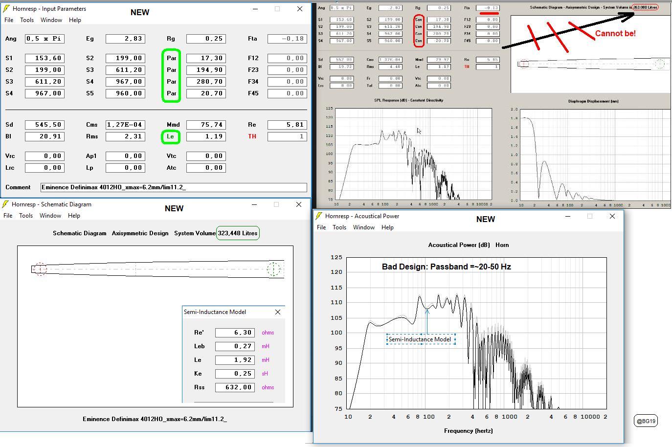

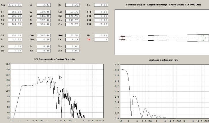

Bjorno! how would you sim/rate my design, is it close to what I acheved?
this the only picture, but the driver is the eminence definimax 12, (for clearer spec inputs)
(I actully have built this and have been using it for 10 years)
was my sim actually correct?
ps: that was not my sim, but one I saved from the tapped horn thread at the time where someone did a sim for me because he stated the driver parimiters where slightly different to the specsheet, the differece was ,margional. and that Is the horn I built.
Just wondering how your sim magic shows this design.
