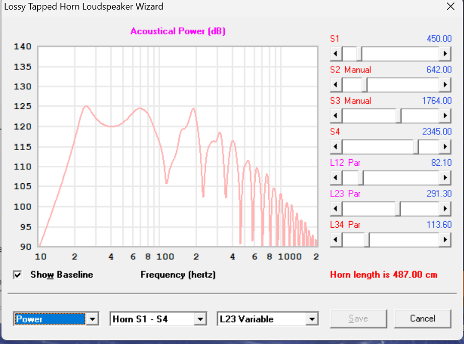

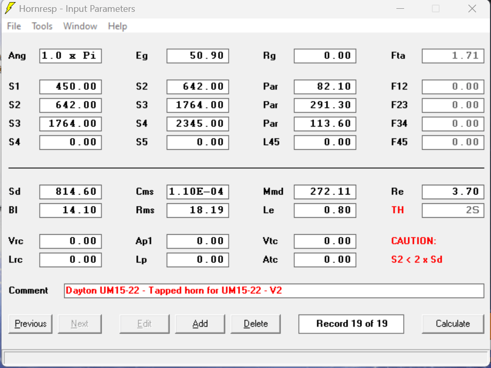

I did go at it again, though this time with two drivers, which leads to a question...
If I have this in Hornresp, that is two drivers in series (or parallel) shown here as TH set to 2S...

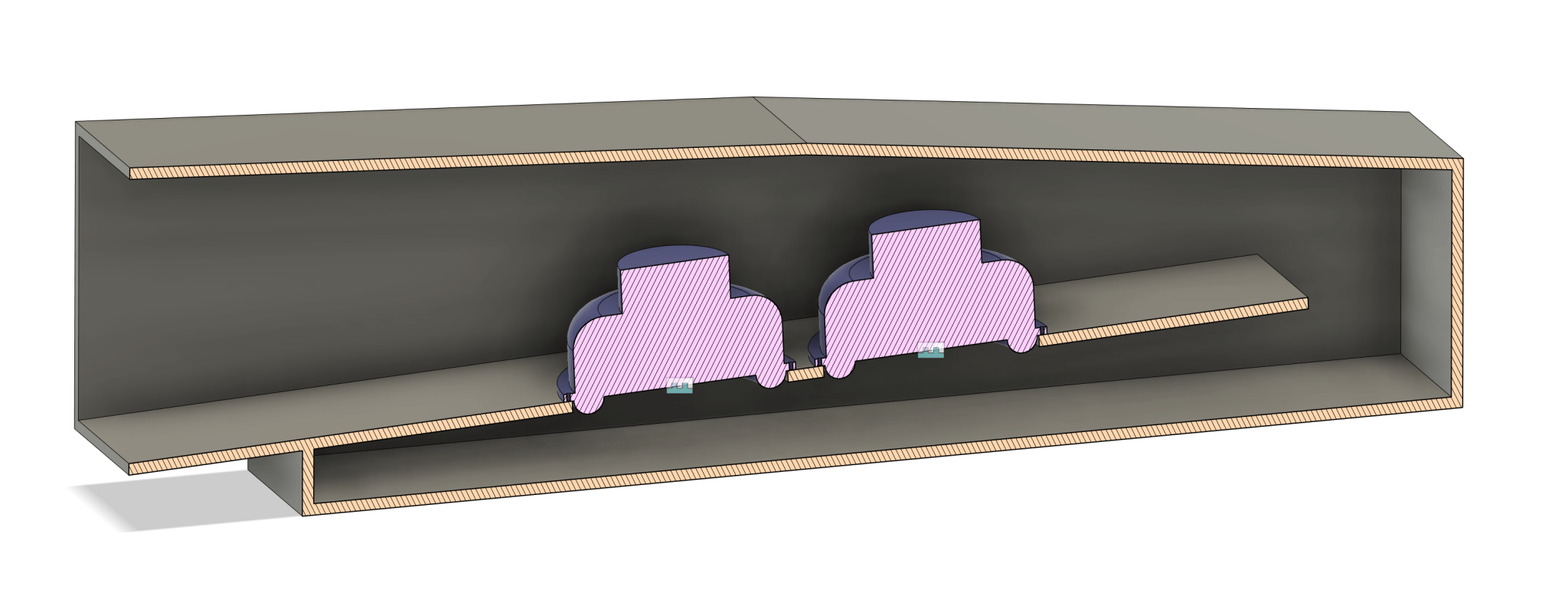

...does that mean I can build it like this, that is with two drivers spaced along the LENGTH of the horn? Below is a cross-section view of the horn design that matches the Hornresp sim.
If so then this design will work... There is some headroom to EQ that dip at 40Hz. With a little damping there is a nice rolloff at the upper part of the bandpass range. I have room for this as huge as it is (about 2' x 2' x 8') and it won't take a ridiculous amount of wood to build. Here is the response, which is massive.
Is it better to eq the peaks away or to fill in the dip
Brian Steele - Agreed I get that this is a square peg in a round hole type situation but that is the point of the exercise for me, to figure out if it is feasible or just too far off of ideal to work practically.
I do not have the equipment, at least not yet, to make TS measurements. I know the manufacturers being off can be an issue. That's a downside to THs I suppose... They are more sensitive to variations in driver specs compared to say a sealed.
I agree cutting the peaks or lifting the dip would accomplish the same thing more or less as long as xmax is not exceeded (as stated). I would say that is more of a DSP based choice depending. With a 125-130 dB response at xmax, and relatively low power requirement, the head room is there. That is far more power than I would need normally.

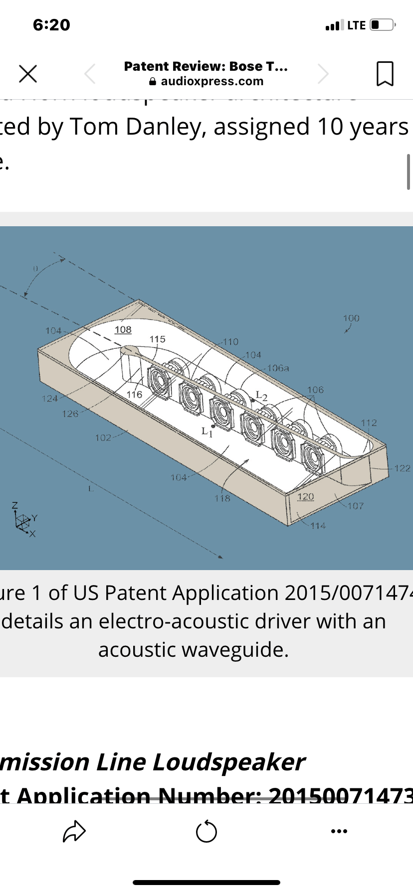

If you model the variety of driver entry positions in qw resonators you find the locations that remove one of the other resonaces And extend the bandwith through a former cancelation just above that.

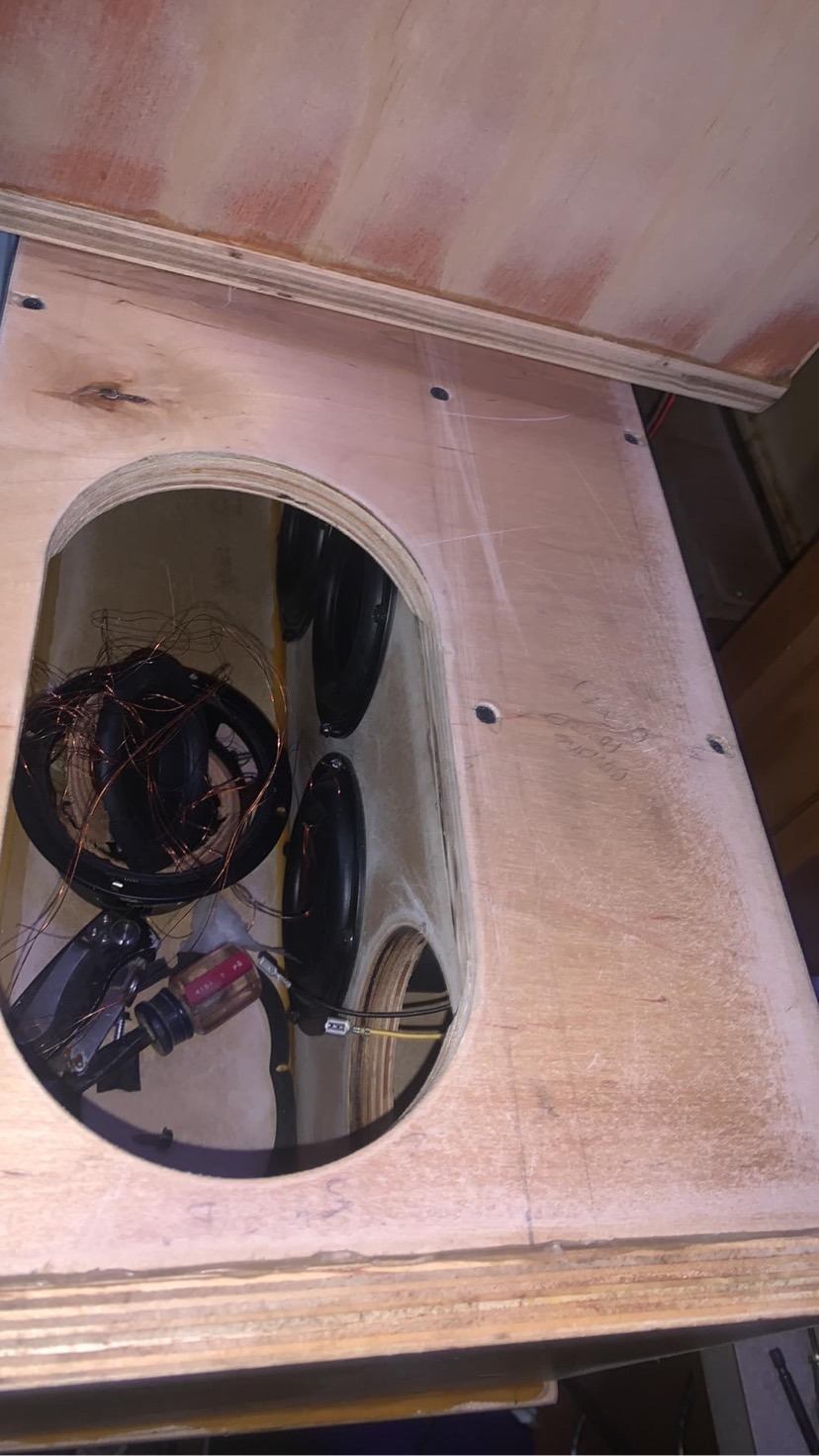

Otherwise why would we want to ‘offset’ the drivers ? ‘Maybe Some air mass/pressure on either side of the cone(s) helps it from wobbling or scraping on the voice coils?
i recently goofed up a voice coil and suspected this might have been the issue?

In this case I am only doing it to fit two drivers into the same horn enclosure for more output at xmax. The point here is that when modeling it in Hornresp, as long as the drivers are close to and equally spaced on either side of the S2 point then Hornresp will model it correctly enough.

I think that’s a lack of motorforce and quite a high Qts so you’re just left with those ringing peaks at the two QW resonaces? What if you stretch one of those home theatre ported boxes for the ultimax into a tapered tapped pipe ? (I think they’re called ‘Marty’?

What is a ‘constant’, as opposed to the ‘inverse’ and ‘expanding’ taper? Is it just a stepped reduction instead of the horn/cone shapes?
(constant is the one I don’t know how to create/design/draw)
