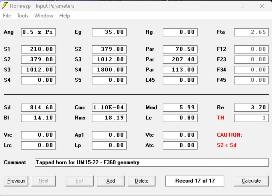

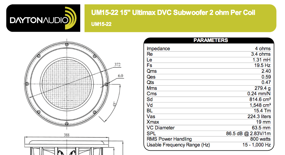

FYI/FWIW, Hornresp calcs Mmd = 343.14 g, yet your Mms is lower, not somewhat higher as it should be, so something's amiss. 🙁Re = 3.669, 3.621 ohms
Fs = 31.9 , 32.3 hz
Qts = .7403 , .7326
Qes = 1.004 , 1.0
Qms = 2.819 , 2.736
Le = .3858 . .384 mh
Vas = 1.887 , 2.277 cubic feet
Spl = 84.27 , 85.26 (1w/1m)
Mms = 331.5 gms
