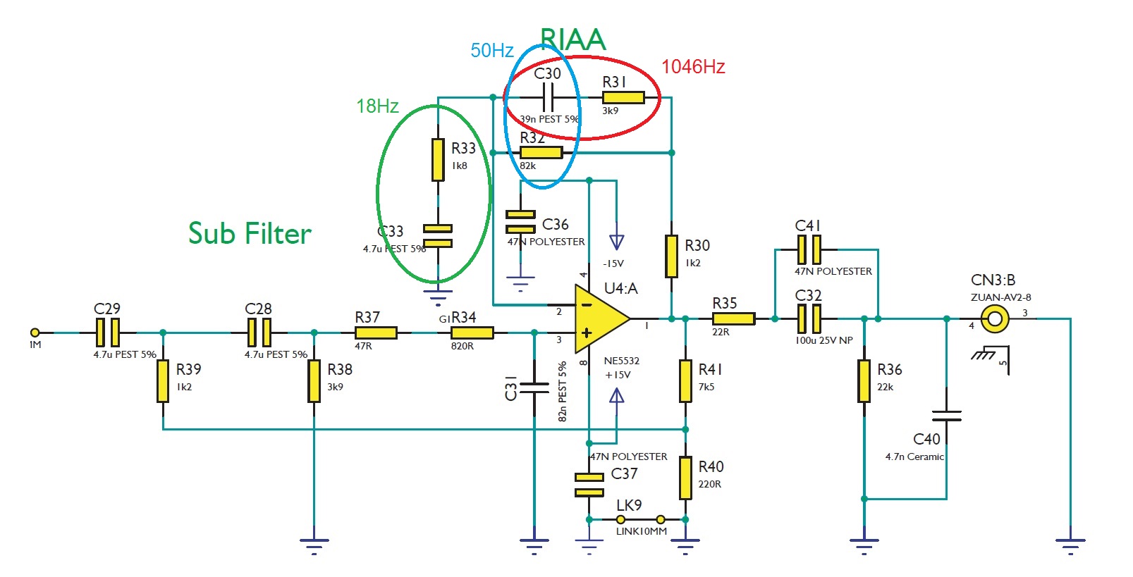

It is simple:
-C30 and R32 in parallel define 50Hz constant
-C30 and R31 define where the low frequencies start to rise, (2.2kHz in cassette decks).
-R33 is for gain.
-R33 and C33 define lowest frequency, it is HPF. (not part of NAB)
Trying to understand this a bit better (and I know you have mapped this out for me in further down, thank you), I calculated the corner frequencies.
I see a 50Hz and a 1000Hz (which is not part of RIAA) but not 500Hz or 2200Hz. You mention that those are done elsewhere. I guess those are the other components you took out? why is there a 1000 do you think?
Don't know why Cambridge make this 1000Hz in RIAA preamp 😕
500Hz and 2200Hz (for RIAA) must be on the other part of the original Cambridge schematics.
R24 and C39 are part of RIAA.
In post 35 is my final version of NAB preamp from this RIAA.
You just calculate the values of R and C, or put values from datasheet app-note for LA3161.
You can't just select two components in a network and derive a time-constant from them, the whole network affects the poles and zeroes, you have to do the full network analysis in the general case.

@ toptip, I realize this thread is more than 1 year old, but did you manage to convert your Cambridge phono preamp into a tape head preamp?
Only NAB 7.5 ips or multiple speeds? Also IEC EQ?
Currently I'm converting the MM input of the Cambridge 651P into a tape head preamp, NAB 7.5 ips. The EQ is done on 1 channel only for testing.
I'm using the Anti EQ module made by Pievox in Germany for testing the FR.
This module is developed to inject a constant current signal into the tape head connected to the preamp.
The Pievox module must be fed by an external frequency generator.
It works well to check the FR curve.
For testing noise, THD and SNR I have a QA400 from QuantAsylum.
However, I'm not sure what's the best method of attenuating the QA400 signal output into the range of millivolt range for the Cambridge input.
If I select -50dB output signal, the QA400 output stage noise remains the same and is then amplified by the tape preamp.
If I go through an external voltage divider, I get significant 50Hz hum harmonics in the frequency spectrum.
