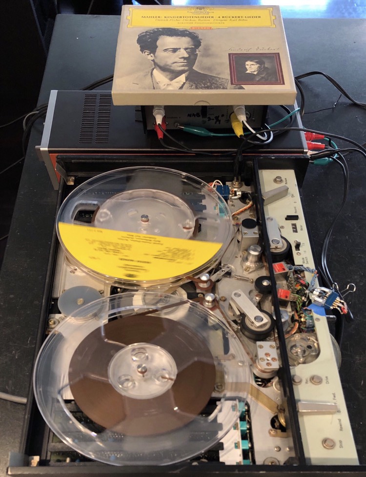

In the meantime I connected the B&K 7003 playback head to a tape reproduce amplifier (Shure M64). Sound was good but very weak. The head measures 13mH and 33ohms. I then inserted a Sony moving coil amp between the head and the Shure. The Sony has 2 and 100ohm selections. With the 100 setting the sound had near “line” level amplitude and was excellent.
I am thinking the head has low inductance as it has to handle very high frequencies for the FM-modulated recordings for its original instrumentation use.
Once I figure out the “tuchel” jack situation, I will run a test tape and figure out frequency response, azimuth, zenith and other matters. In general though this machine is far better constructed than consumer products. Tape path is unusual and treading the tape is truly annoying.

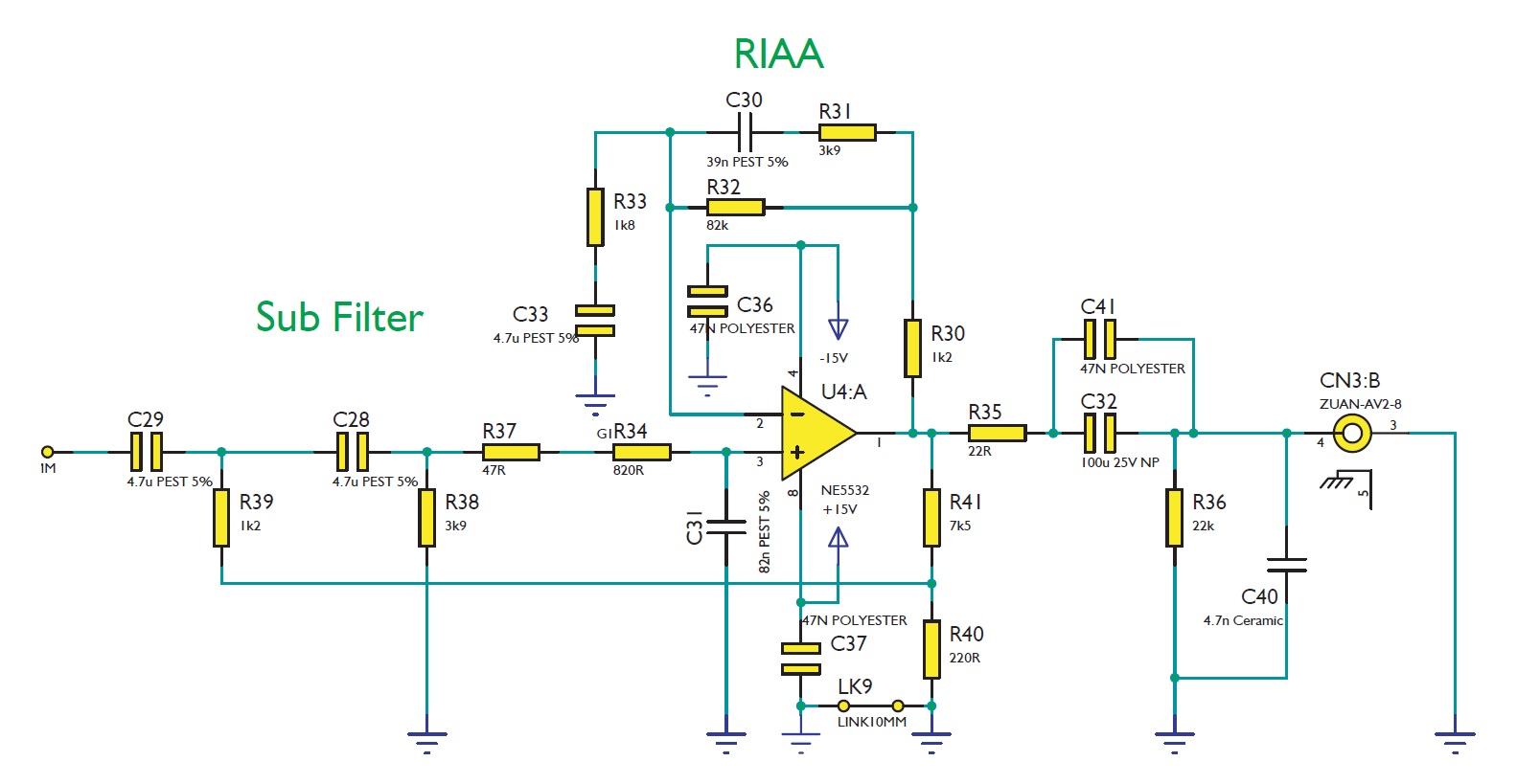

Cambridge Phono stage
This is the RIAA equalization circuitry in the Cambridge phono preamp I would like to modify.
With my limited knowledge of electronics and getting lost in schematics, it will take me a few weeks of experimentation to figure out what combination of RCs provide the RIAA turnover frequencies, so that I can modify them. (I believe the 7.5ips NAB has two turnover frequencies as compared to RIAA's three, so I will need eliminate one of the RCs.)
If anyone can guide me to a quicker identification of what does what, I would hugely appreciate.

You don't need that subsonic filter on the input too.
R32= 62k
C30= 56n
R31= 2.2k
R33= 39
C33= 470 uF (or short if there is no DC offset).
This is values from Pioneer CT610 deck.
This is EQ for normal tape, for High type (chrom and metal) you'll need switch in EQ.

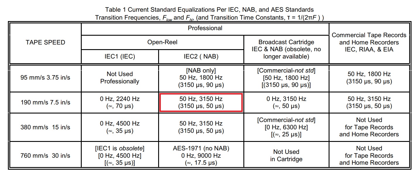

Also that is a cassette deck right, running at 1-7/8ips? For 7.5ips reel I will need different values.
If you try to calculate exact time constants for PB EQ, you will find that every manufacturer of the decks use slightly different those time constants (frequencies).
Yes that is for cassette decks, for r2r you need NAB values.
Good source for that is datasheets of the some opamps, I will try to find something to help you.
Here are some examples for NAB EQ:
https://pl-1.org/getproductfile.axd?id=1133&filename=LA3160.pdf
http://www.ti.com/lit/ds/symlink/lm833-n.pdf
That EQ NFB network you can put into the Cambridge phono preamp.
I have used this table which I think is as accurate as they get. For some reason many tape amps do not have the lower frequency correction for 7.5ips. This is a very useful publication to download in general.
Can you tell, in the Cambridge schematic, which combination of RCs are for what constants?
It is simple:
-C30 and R32 in parallel define 50Hz constant
-C30 and R31 define where the low frequencies start to rise, (2.2kHz in cassette decks).
-R33 is for gain.
-R33 and C33 define lowest frequency, it is HPF. (not part of NAB)
-R33 is for gain.

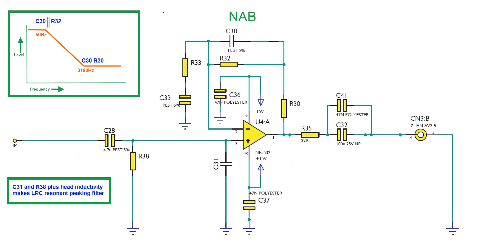

So in brief:
RIAA phono time constants
3180 µs (50 Hz), 318 µs (500 Hz), and 75 µs (2122 Hz)
NAB 7.5ips constants
3180 µs (50 Hz)...........................and 50 µs (3180 Hz)
So to convert a phono amp to tape amp:
-- one turnover frequency needs to be eliminated; and
-- another one moved 25 µs.
In books and magazines, this is explained in extremely -- in my view, unnecessarily -- complicated manner, with references to "constant velocity" and "constant amplitude" alternating one after the other but they are both 6dB/octave downward sloping curves with 2 or 3 corrections, that is all.
This Cambridge phono have more components to cut out, because RIAA correction is made not as usual simple preamps.
You need to cut out:
R41
R40
C31
R34
R37
R38
C28
R39
R36
C40
many of these components are part of RIAA EQ.
R41
R40
C31
R34
R37
R38
C28
R39
R36
C40
Resonance
I think I made a mistake, for the sake of clarity, by not providing the fuller schematic. There are stages prior to the RIAA stage which I think would insulate the head from entering into a resonant relationship at this stage, no? See attached.
HF peaking is same as with MM cartridge = C31 sets resonant frequency, R38 sets Q of that resonance.
Both values depends on playback head inductance.
I found your B&K catalog.
This Cambridge phono is way more than tape needs. (Tape does not rumble.)
The app-note for LM833 is an excellent starter tape-amp. The '833 is a work-alike for '5532 which has stood the test of time, and works fine in the same circuit.
You note that the '833 plan uses nearest common value parts, a 5% nominal error, which is hardly audible. It specifically implements 7.5ips Consumer. For 3.75 change 3.6k to 6.48k.
Gain can be raised by decreasing the 200r. If you go below 100r, increase the 47uFd a similar amount to keep bass. If you have to go much below 100r, then indeed these are low-Z heads. Did B&K use a head transformer? Do you have that? If not, *then* the semi-discrete first section of the Cambridge may give somewhat higher S/N. (If you only have mass-duplicated tapes then it hardly matters.)

On a separate note, any idea idea what that connector on the B&K is? The PC board clips I installed temporarily are not very secure. Otherwise the sound from the B&K is superb. I will also need to fashion an end-of-tape switch-off mechanism. I guess when they were recording Richter scale-8 earthquakes with it, such creature comforts were not high up on the agenda.
Now I have a very basic question regarding tape recording:
If you record and play back on the same machine, you still need to follow the standard, right? Now taken that the record path has no EQ and is fairly linear (since the head is current driven), why is it necessary to equalize the playback with a corner frequency somewhere in the middle of the audio band? Why not just a simple -6dB/octave EQ, starting let's say at 30 Hz?
Compared to RIAA used at LPs, there is a mirror EQ at the cutting lathe and the turntable. But at tape there is linear at recording and equalized at playback. (Plus the individual HF correction due to playback head inductance and gap width, but this is different for each model).
