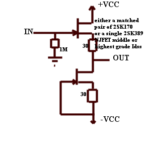

Tom,
How about a simple current sourced mosfet buffer. Idleing the mosfet at about 10ma. should be enough. Input impedence should be very high and a bias of 10ma. should be high enough to drive the input of most tape decks.
Jam
P.S. Comments, Grey?
This buffer works very well for me:
Michael

Jam,
I'd say 10mA should do an admirable job. Actually, you could probably get by with less, but it never hurts to have more drive than you need. The converse, however, is a bummer.
Grey
