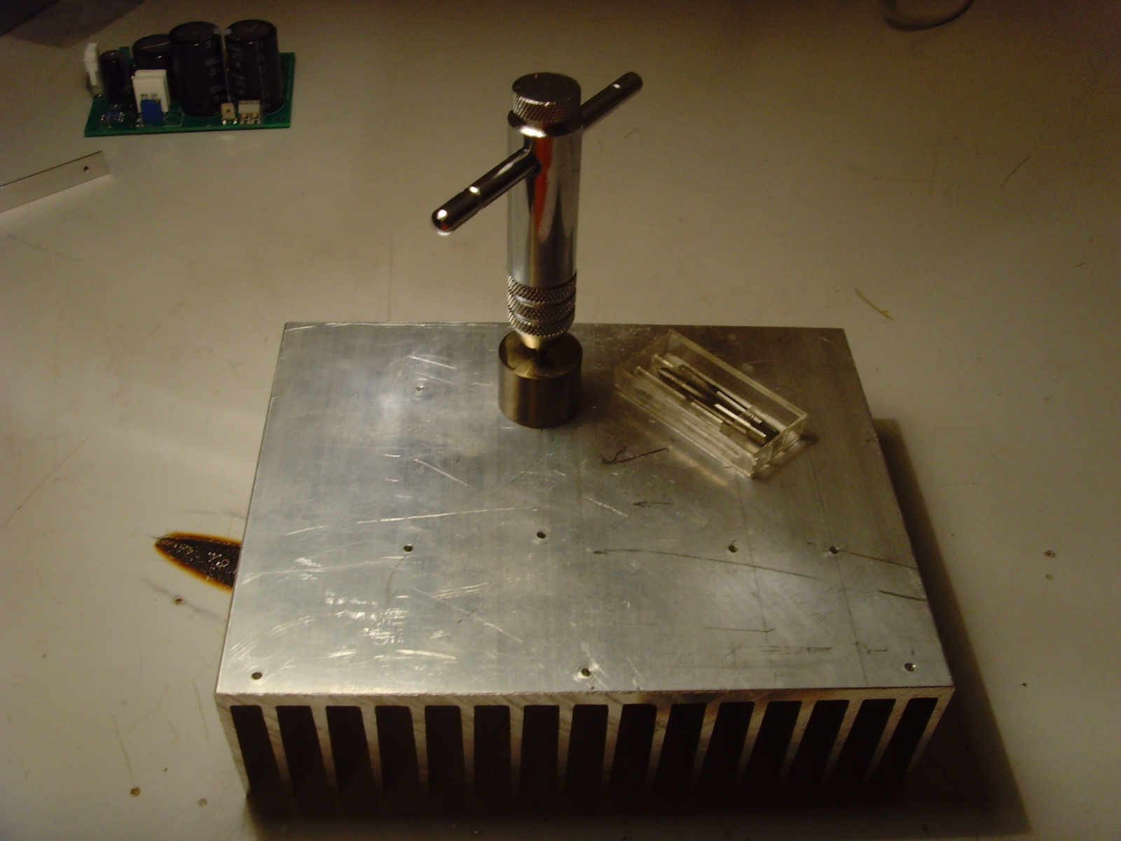

Lot of advices here. Thanks. I have a3 pass tap (3 progressive taps). For aluminum, somebody said me to only use the finishing one (as the material was soft).
Is it a standard practice compared to using the 3 passes as usual ?

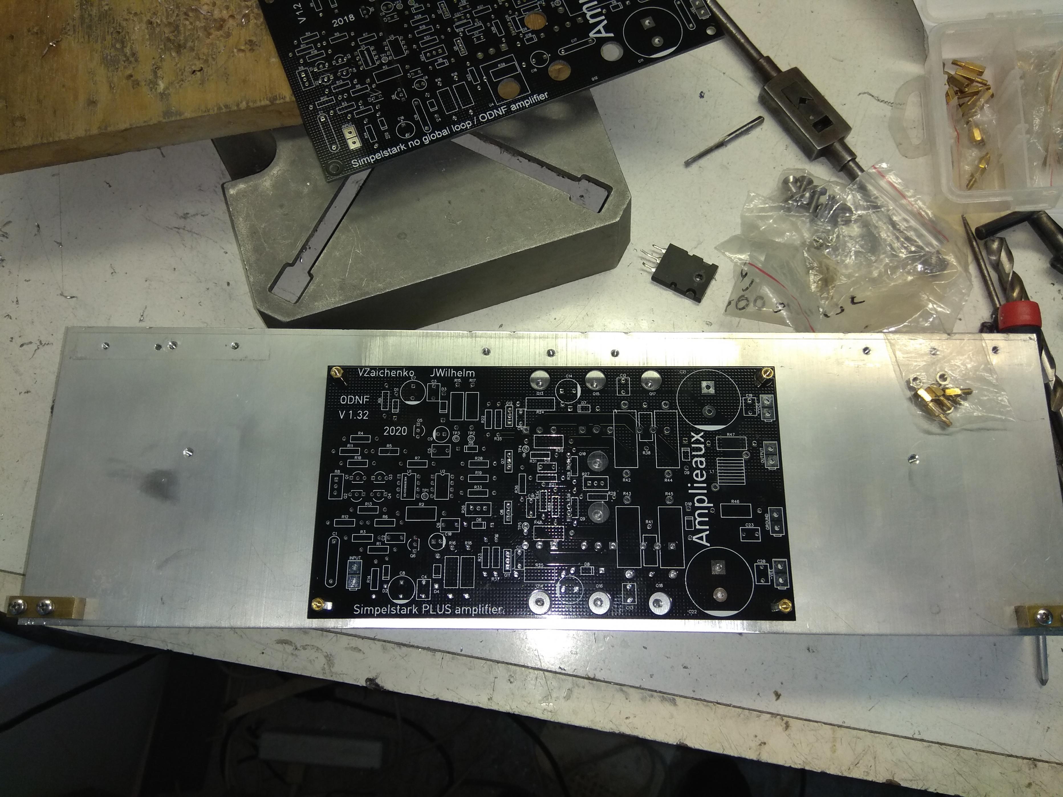

I retried, and even with all advices, even with the fact that it is not rocket science, even with a drill press and lubrification, I screwed several attempts and broke my final tap in the last one.
Finally what worked for me was:
- drill 2.5mm (the one I had, did not bought the "official" size,
- chanfrain the top on the hole with a larger drill,
- lubricate with WD40
- one pass with the intermediate tap, by hand.
2 holes => 2 OK => Done
For sure this is not the best way to proceed, but now the heatsink is on the amplifier
Thanks for all explanations and advices.
JMF
