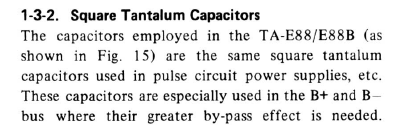

Hi there -
I have a unit for a client - a lovely Sony TA-88e preamplifier. it has two types of tantalums in the signal path.
I am being overly cautious with the client as I havent come across that many tants before. There are two types in this - one I assume is the bulbous wet type and the other is (many) smaller dry pellet types (?). Pics of both are attached.
Should I replace either of these? I would incline towards "yes" for the first type, but not for the second? I cant seem to find consensus anywhere on audio forums I am a member of to answer the clients questions.
thanks!
You won't find a consensus, but at this age, replace parts that normally degrade in use,
like all of the tantalum and electrolytic capacitors. Also, older solid tantalums were prone
to shorting and burning up, often in a spectacular fashion. Not the way to impress an anxious
customer. If you must use tantalum replacement types, derate their voltage rating by 50%.

Tantalum caps don't always degrade with use. Once they have settled into their DC bias voltage, their leakage approaches zero and stays that way forever, unless they are damaged.
Yes, solid Ta caps are dangerous, since when the oxide layer is ruptured, a reaction takes place where the manganese dioxide gets consumed to oxidize the metallic Ta into tantalum pentoxide, restoring the oxide layer. As long as these reactions are few and far between, a solid Ta cap can form to the applied voltage, and once the oxide layer is stable, very few of these reactions take place. These reactions are the result of tiny holes in the oxide that cause a small short circuit with a reaction that re-grows oxide, so a solid Ta cap's leakage current is more of a scintillation of many of these tiny reactions, rather than a steady leakage. Again though, after the cap has stabilized, these scintillations get less common, and can eventually go to zero, resulting in a perfectly stable cap with no wear out mechanism.
So, as long as the Ta cap is not exposed to unlimited surge currents, it can be an extremely long life part, and will not dry out like a wet Al electrolytic. If the cap is surrounded by relatively high valued resistors, the peak currents will be limited, making the part less susceptible to failure.
An old Amber 4400 I'm now restoring uses many solid Ta caps, including some used as AC coupling for the output, terminated at the output jacks. Needless to say, with no established load on these output caps to put bounds on the transient current through the cap, they have all failed. However, other solid Ta caps tucked inside of circuit nodes with light loads such as 20KΩ will never fail, and have not, so there is no need to replace them with an aluminum electrolytic that _will_ eventually dry out and that will always have higher leakage than a formed solid Ta cap.
Solid Ta across the power supplies is a dangerous proposition, since transient currents are usually not limited to small values. Worse, steady state currents are not limited to small values either, so these are places where a fire can be started. Replacement with a wet Al electrolytic is a good idea, especially given the nice parts like Panasonic FR that we have now.
Wet Ta caps are extremely reliable parts, as long as they are de-rated to 50% of their faceplate voltage. In the NASA paper "Leakage currents and gas generation in advanced wet tantalum capacitors", they state:
Currently, military grade, established reliability wet tantalum capacitors are among the most reliable parts used for space applications
When the oxide layer gets ruptured, hydrogen gas is generated in an electrolysis reaction that re-grows the oxide, which could cause the case to swell and fail if enough hydrogen builds up. This is similar to the reaction in a solid Ta cap, but a wet Ta caps generates hydrogen, and the case is often hermetically sealed, trapping the evolved hydrogen gas.
I don't have much experience with wet Ta caps, since they're usually too expensive for audio equipment. Still, if they work now after decades, they will probably last additional decades. It's probably best to remove them from power supply applications, but for signal applications, I'd leave them in, again as long as they have defined resistances around them to limit the peak current through the cap, and they're de-rated to 50% of their faceplate voltage.

I would suggest that you just replace all the tantalums (and all the electrolytics)
with new electrolytics., no risk there. Film types probably won't fit.
